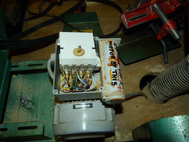

      Hi Everyone
      Can anyone advise what would be the best setup for a switch or switches for my woodworking machine.
      Just to put everyone in the picture I’m referring to an old Kity Combination Machine, the type where the individual machines were fixed to a wooden table and a motor placed in the middle of them with the NVR switch attached to the top of the motor.
      I've used the machine for a good many years with this setup but I’m getting a bit older and don’t really fancy having to lean over running machines in order to turn the motor off, just to add the switch is still working perfectly but I would like to change the setup if I can, I suppose a switch near each machine would be ideal or one which could be moved about if thats possible.
      I’ve included some pictures just to show the present set up.

          Fit a DOL starter switch at the edge of the bench. Connect the existing plug lead from the motor switch to the OUT terminals and the original plug lead (or a longer one) to the IN terminals.

              The original switch is a nvr so Daveb,s suggestion won’t work.
              i would replace the switch with a contactor and then place as many fixed stop switches around the machines as you feel you need
              then have a start and stop switch on a pendant that you can place next to the particular machine you are using
              The idea of having fixed stops is so you can be sure you can get to one in a panic if the pendant moves

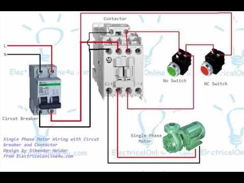

                    hqdefault.jpgHi Guys
                    Thank you all for taking the time to reply to my question, in particular Ian Parkin’s suggestion which I quite like the idea of.
                    I’m assuming if the start and stop switch was on a pendant it would need some sort of support. Which would be the best way to go a lightweight chain or a thin catenary wire?
                    As far as the contactor is concerned, I assume I would need to be looking for a 230v 12amp single phase one being fully enclosed with cable gland outlets or failing that purchase a box enclosure and fit the contactor in it just to keep all the dust out.
                    Can anyone suggest a suitable one or send a link of one which would do the job?
                    Would a wiring setup similar to the attachment work only with more stop buttons?

                      Clive
                      Best to buy an enclosed DOL starter with an overload to match the motor full load current as stated on the motor plate.
                      Wiring to the remote stop start station/s will be shown with the starter paperwork but the stop circuit will pass via the overload so it cuts power off with overload conditions.
                      As Ian says best to mount the lock off stop buttons in fixed positions where they would be easily found in the event of an emergency.
                      It is best to wire the live via all contact pairs so link from the 1st set and o/l to the 2nd set and then to the o/load, Neutral in via L3 on contactor and then o/l.

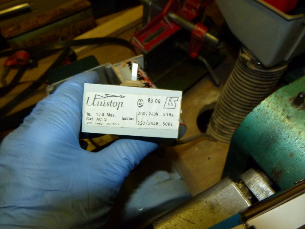

                          Ian you said there was no overload protection with the original switch, just thought I’d ask can you tell that from the photos I included? and just out of curiosity what is the thing where it says do not lift the motor by this?
                          Thanks again Clive

                            You said it is best to wire the live via all contact pairs so link from the 1st set and o/l to the 2nd set and then to the o/load, Neutral in via L3 on contactor and then o/l.
                            I’m sorry to be a bit dim but you have lost me, I’ll do a small wiring diagram of what I think and hopefully you can correct it where I'll no doubt have it wrong.
                            I will get the motor off because I can’t see the spec plate properly as it’s stuck in the middle of all the machines, hopefully it will state what the full load current is.
                            Having said that, in the photo of the switch it says In 12A MAX, is that not the same thing?

                              Hi Clive
                              The 12A stated could be the max rating of the switch contacts at 230v AC, I don't think it is motor FLC.
                              With a 230v AC supply you need to get a starter with a 230v coil and an overload that has a range that your motor FLC falls into.
                              If you go ahead with buying a DOL starter and o/load I will send a connection diagram if not included with your purchase.

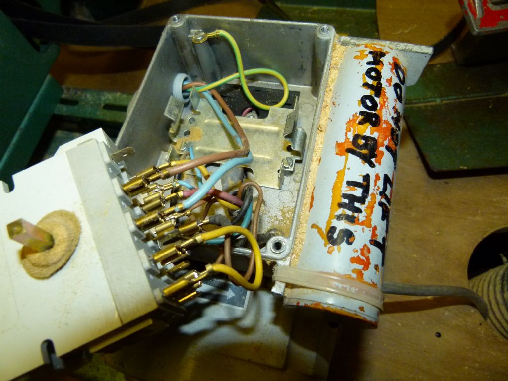

                                the round cylinder mounted on the side is a capacitor which kicks the motor to start in the right direction.
                                that motor you have is a French one ..they always seem to be able to do things electrically differently than anyone else.
                                the switch is a contactor with a rotary start switch and it only relies on the plug fuse for overload protection
                                a modern starter has a thermal adjustable trip to protect the motor better.
                                its best to look after that motor as it will be difficult to replace.. as its double ended ?

                                  Thanks for telling me what the cylinder/capactor is for, I must admit I thought the motor rotation direction was derived from the windings, but then I don't know much about electric motors other than they can turn clockwise or anti-clockwise.
                                  I also uploaded a picture from the Kity booklet and it looks like the motor is equiped with a thermal overload no volt release.

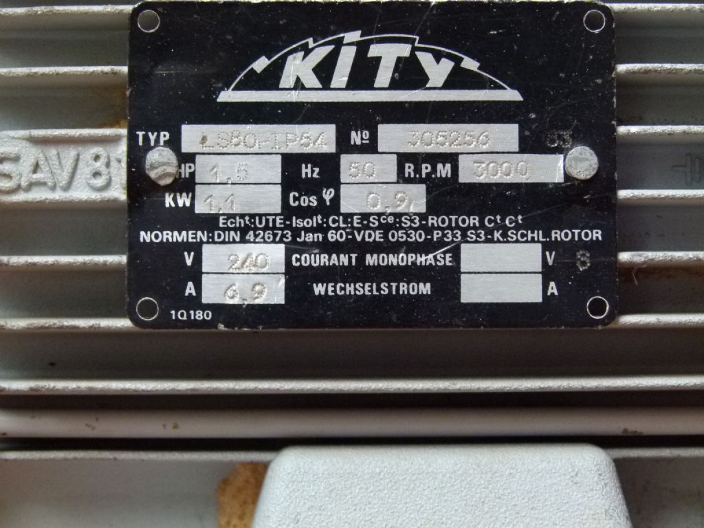

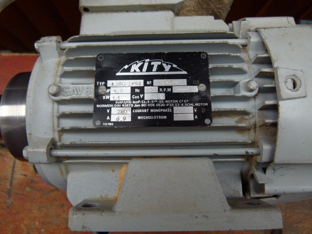

                                    Iv'e taken the motor off so I could get a good look at the spec. plate and typical it doesn't say a blind thing about FLC or in the booklet about the motors (as in the picture I sent to Ian)
                                    All thats on the plate is as shown in the picture below.
                                    Any ideas on my best way forward with that one?

                                      Your thermal overload may only be thermostat in the windings it’s hard to see from your photo how many wires dive into the motor itself
                                      your current is marked as 6.9 so you need an overload say about 7.5 or so

                                        The current is marked on the plate as 6.9A it’s anyone’s guess if that’s the start-up current, so as you say 7.5 should be ok.

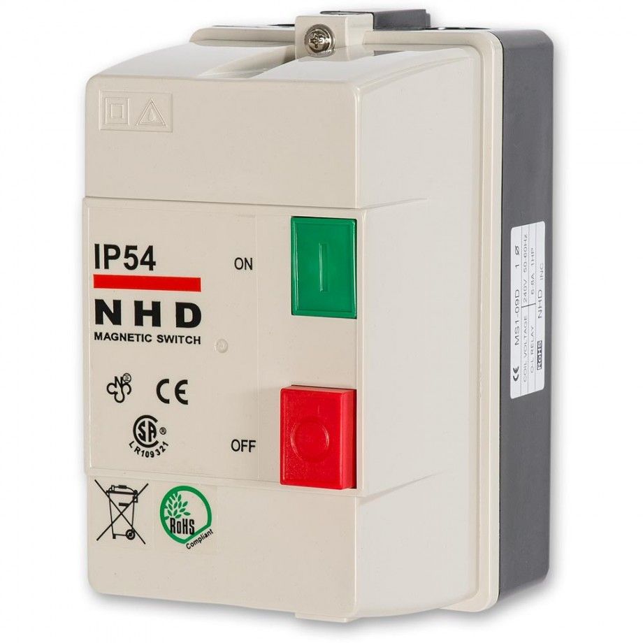

                                        Anyway, I’ve been having a look at the starter in the picture advertise by Axminster Tools £54.50 of which they do one rated at 1500w so should be good for 1.1Kw
                                        I’m not 100% certain it comes with overload protection, so I’ve sent them a message asking a few questions including how big it is.
                                        I don’t really want something that’s too massive if I can help it.
                                        #445162
                                        Emgee
                                          @emgee
                                          Clive, see spec below, make not shown so may be an import from China which could be bought for £30 on ebay.
                                          • Adjustable overload protection: Order number 340192 for 6A to 8A overload (suits your motor)

                                          #445184
                                          Clive B 1
                                            @cliveb1
                                            Emgee
                                            I don’t suppose you know the seller’s id as I’ve tried looking under overload protectors and motor starter switches and haven’t had much luck, I know it must be there somewhere I'm just not looking in the right place.
                                            I'm not sure how to look something up on ebay under order number and as for being made in China.
                                            I’ve just done a check on the one I posted a pic of namely NHD sold by Axminster and where is it made Taiwan.

                                                  Clive, 7-10 is outside the flc of your motor, IMO best stay with the 5.5-8.0 Amp.

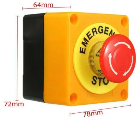

                                                    I’ve been having a look at a Motor Water Proof Machine Drill Switch ON/OFF Push Button for 10A 220/380V £5.69 (item No: 143265824264) on ebay or same thing on amazon TOOGOO(R) AC 220/380V On/Off Water Proof Push Button Switch KAO-5 for Drill Motor Machine £3.29
                                                    Would it be possible to wire either of the above switches in circuit with the NVR unit or would it be a case of once the machine has been switched off by any of the stop buttons the only way it can be restarted is via the start button on the NVR unit, I’m guessing that is what the case will be, any ideas??
                                                    If it can only be restarted by the NVR unit I may as well buy the GLOGLOW 660V 10A Emergency Stop Switch £6.89 on amazon or 10A 660V Red Sign Mushroom Emergency Stop Push Button Switch Station Yellow XKUK £5.48 on ebay item No: 133115256527.
                                                    I assume 660V will also be good to go on 230V??
                                                    Thanks again for any advice you can give
