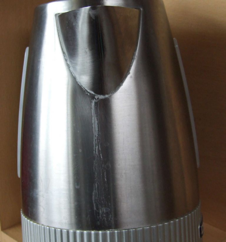

      The two Photographs above show the failure of a joint on an electric kettle after about 18 months of use. The Spout of the kettle has no mechanical fixings other than the substrate used to adhere the spout to the kettle.
      When the joint started to fail along the top of the spout we stopped using the kettle. As the prospect of the spout falling off while pouring was too great. Boiling water going everywhere bar in the Cup or Teapot is not one of the secondary functions of a Kettle.
      The "Glue" used seems to be some sort of metal loaded Epoxy, but I would like to know why this has failed. Surely the tap water cannot be to blame.
      Anyone got any clues, or experience with a similar failure?

          Stainless steel has a higher thermal expansion than mild steel, close to double and is also not a very good thermal conductor. I would think differential heating of the body compared to the spout would account for the failure. When the water is boiled the main body will get hot long before the spout does as the spout will probably only get hot when the water is poured out. Sounds like a predictable failure.

                Thanks for the input so far, the differential expansion would certainly put stress on the joint. Plus the Epoxy would act as an insulator as well. Which would only add to the problem.
                I have assumed it to be Epoxy, at the failure zone the material has the appearance of granulated carbon. Given the country or origin it could be something else. The other problem is what cannot be seen, ie the joint degrading inside the spout. Inside, it has all the appearances of having failed already. It is just the outer layer of the joint holding it at the moment. The crack an be easily flexed with the index finger and thumb.

                          Neil, I was thinking that the differential expansion would be aligned with the joint, the spout material would not expand along the line of the joint but the body would. It would weaken the joint even if the spout flexed around the bend in it.

                              If the body of the kettle and the spout are stainless steel – where is the differential expansion?
                              Clean off the joint area on both components. Remove the jointing compound (you suggest that it's an epoxy.)
                              Solder the components back together with a silver-tin alloy wire. It can be flux cored or use separate liquid flux
                              Just ensure that the flux will work on stainless.
                              All products are readily available and will produce strong, reliable, neat and attractive joints.

                                            Generally this joint was doomed to failure right from the start. Anyone who has made a glued joint will know that the contact area is the key to a successful joint. In other words there needs to be a lap joint, or flange, to increase the surface area for the glue.
                                            An internal flange on the spout, combined with an electrically conductive glue to act only as a sealer. Would have made it possible with the open design of the spout to internally spot weld in 3 places. Problem solved and the job will last for ever. Thermal conductivity from the kettle body to the spout would be possible through the spot welds. Plus the electrically conductive sealer would more than likely conduct heat equally as well.
                                            On the reverse of this design is the possibility that the joint was designed to fail, but only after the element had expired. In which case it would have been a perfect design. If you cannot boil water, you cannot be scalded when the spout falls off.
                                            Our kettle being a very rare exception in Jug Kettles, in that the body failed before the element.
