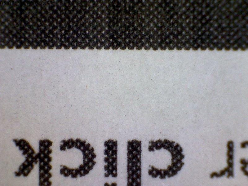

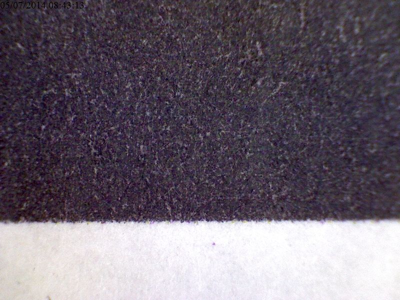

                                          Les Jones 1
                                            @lesjones1
                                            Hi Keith,
                                            I do not agree with your theory that the laser print is solid black and the inkjet print is just dots. If this was the case I would have expected to see maybe a 50% reduction in the reflected infrared. In fact there was almost no change. On the inkjet sample the collector voltage changed from around 0.2 volts to 0.21 volts. On the laser sample it changed from about 0.2 volts to about 4.5 volts. I was using the Maplin SY-CR102 reflective sensor with a 270R resistor to set the current in the photodiode and a10k collector load resistor. The supply voltage was 5 volts. (I think this is the same configuration that John is using.) When I did the tests I was expecting to see a noticeable change in collector voltage with the inkjet sample that could have been made to cross the threashold level by changing the value of the 10K resistor. I have added close up pictures of the print samples.
                                            Laser print.
                                            Inkjet print
                                            Les.
