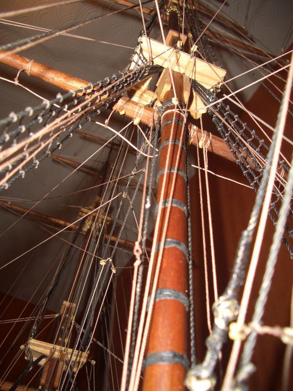

                                              They don't have to work but from rigging a 1/350 scale Cutty Sark. I realise that they still do the same job and as such all have to be adjusted until everything's just right. While this is possible with plastic or solid wood blocks there is a tendency for the lines to snag on the uneven surface. So creating tight spots which suddenly slip meaning all the other lines are out of whack. And the plastic blocks tend to snap at the becket causing even more headaches. So apart from the greater authenticity, it's a big help rigging the standing lines.

                                                  These are just drilled blocks of wood so still suffer from being ugly as hell out of scale and tend to snag the lines just at the wrong time. Only to release them again when you think it's all done
