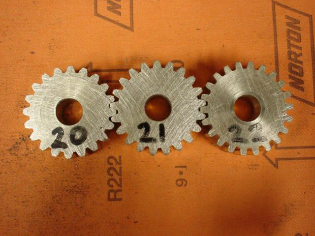

                                John Stevenson 1
                                  @johnstevenson1
                                  It is possible to define the PA by measuring over 3 or 5 teeth and a set of tables.
                                  However the tolerances in commercial gears is that wide they exceed the differences between 14.5 and 20 degrees PA.
                                  Another problem is many commercial gears are modified to give stronger tooth forms, quieter running that it puts all normal calculations out the window.
                                  Take these three gears, all cut on the same OD but only the 22 tooth is correct as regards normal calculations.
                                  Trying to measure anything on the 21 and 20 teeth will get you nowhere but they are all 20 PA gears.
                                  John S.
