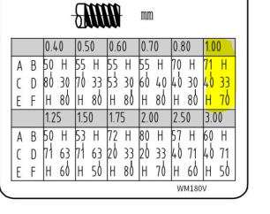

                                            #770813
                                            COLIN MARTIN 2
                                              @colinmartin2
                                              Hi All,
                                              At last an update! It has taken me a long time due to the making of the cranking handle and organizing myself, plus other things getting in the way, but I have done it, and to my amazement it all works.
                                              The cranking handle worked like a dream, so thank you for the suggestion, I would never have been able to do the work with power feed, space was too tight, and the handle gave me loads of time without panicking. I made a mistake with the first thread and arranged the change gears wrongly, but a check with the thread gauge showed my error. I think that I also found an error with the Warco threading chart for 1.00 mm threading – the chart shows (for an Imperial 180) 71t driving 40t driving 33t driving 50t on the lead screw, but after double-checking this gave a very coarse thread of about 2.00 mm. Luckily I found an alternative combination on-line from an enthusiast that gave the correct thread. Any suggestions?
                                              The biggest problem is going to be the fit of the thread on the flywheel. I was surprised at how much fiddling it took before the extractor would actually screw onto the threads that I was cutting, and the 1.25 thread that screws onto the flywheel can only be checked in situ when I need to next strip the engine down, so I will need to find a way of picking up on the thread in the chuck after trying the fit in the engine. I was hoping that the threads would fit without much problem, but I would need to be very lucky for that to happen.
                                              Thank you to everyone who helped me with advice and suggestions, it was a steep learning curve and I am only just beginning, but it is very satisfying creating something.
                                              Colin
                                                I think you are getting your drivers and driven mixed up.
                                                1mm
                                                There is a fixed 40T driver on the spindle meshing with a driven 71T
                                                The 71T then drives a 40T
                                                Next to the 40 T is a 33T driver
                                                On the leadscrew is a 70T Driven gear
                                                So The maths is
                                                40/71 x 71/40 x33/70
                                                The first two actually cancel each other out as the 71T is just an idler so you just have 33/70 as the gear train ratio
                                                33/70 = 0.471 turns of the lead screw per turn of the chuck.
                                                Taking a 12tpi lead screw 1 turn of that is 1/12 x 25.4 = 2.117mm
                                                So 2.117 x 0.471 = 0.997mm pitch which is about asgood as you will get to 1mm
                                                #770844
                                                COLIN MARTIN 2
                                                  @colinmartin2
                                                  Thank you,
                                                  I have no idea what I did wrong; I checked the set-up again after I found the error and it was right – the top two gears on the outside and the lower on the inside, but I was getting the wrong thread. I must have done something weird. I will have to look again and try to figure out what I did wrong.
                                                  Thanks,
                                                  Colin
                                                    Hi All,
                                                    At last an update!
                                                    Many thanks Colin, not everyone bothers, leaving the rest of us in the dark forever.
                                                    Handles provide excellent control and I often used one on my mini-lathe.  The disadvantage is they are very slow.  If future project requires a lot of threading and time is short, be aware that a WM180 can be set up to safely cut threads in reverse.  The cutter starts at the headstock and moves away towards the tailstock.  Cuts can be taken at high speed, because – unlike a conventional right to left cut – there’s no risk of crashing into anything at the end.   The cutter overshoots safely and the operator has plenty of time to wake up and stop the lathe!
                                                    See Jason’s answer, who gets ten out ten for explaining the maths!  Again, if a lot of miscellaneous threading is to be done, it’s worth studying the maths (ratios), because the process becomes clear, making it easier to deal with non-standard threads, spot mistakes, and replace missing tables.
                                                    Yes, threads have to fitted with more than average accuracy, and it can be fiddly.   Colin has the worst case – he’s fitting a lathe turned thread to mate with one installed on a machine, so it’s necessary to take the new threaded part off the lathe to check it.   And always bad to demount work from a machine mid-job because it’s difficult to reset accurately.  In this case, I suggest#:
                                                    1. Always leave the half-nuts engaged – do not use the TDI even if it happens to work on this particular metric pitch.  Not disturbing the half-nuts ensures the spindle and lead-screw remain synchronised.
                                                    2. With the work gripped in the chuck, advance the cutter by hand turning the chuck until the cutter just touches the start of the thread.
                                                    3. Centre-pop or scratch a line on the outer face of the job, that’s aligned with the cutter.   Also mark the job and chuck jaws with a felt-tip, so that the job can be put back into the chuck in much the same position it came out.
                                                    4. Check the centre-pop/scratch and felt-tip alignments agree – close enough.
                                                    Well done you – this is a challenging beginner problem, straight in at the deep-end with the sharks!   There’s much to be said in favour of starting by learning to thread a rod to take a standard nut, say M12 x 1.75.   The standard nut is a portable gauge.  Doing that teaches most of the basics, including gotchas, in a relatively obvious way.  Move on to more difficult problems after the basics have been mastered.   Jumping in at the deep end has a high-failure rate, perhaps convincing a newcomer that it’s all too difficult, or that their tools are no good.   Not so, skills have to be developed: understand, plan, then practice, practice, practice.     My gut feel is that many starting out in the hobby seriously underestimate how much there is to learn, and how long it takes.
                                                    Colin
