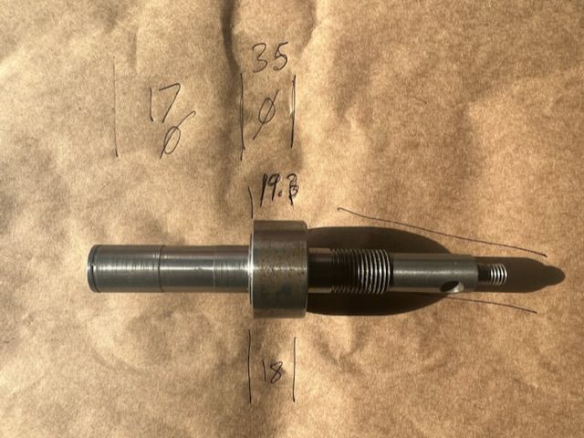

      I have this part that i want to replicate
      The shaft to the left is concentric to the middle boss but the boss is 18mm on one side and 19.3mm on the other making the shaft to the right at a shallow angle.
      how can i do this?

        Howard Lewis
          @howardlewis46836
          How about turning the concentric areas in a 3 jaw, and then hold the long spindle in a four jaw to offset the right hand end for the thread cutting etc?

            Well its not eccentric its bent
            #633571
            Martin Johnson 1
              @martinjohnson1
              Make a bush, but drill or bore it in the milling machine to the required angle. You could either set the mill head over to the angle or rig some sort of sine table arrangement.
              Then machine one end of the part, hold in the wonky bush (grubscrew perhaps) with the bush held in 4 jaw chuck to machine the second end.
              You still have the problem of getting the intersection of the two wonky axes in the right axial position. A bit more examination of the part needed to determine where and how important it is and how the OEM did it.

                Get am excess length of stock and cut a couple of inches off. Turn the part on the left that is square to the large diameter. Drill / bore the excess stock at the correct angle to take the turned end. Then either slit it and hold in chuck. Alternatively loctite / glue / soft-solder it into the drilled part and chuck it. Now you can turn the angled end.

                      On a lathe, ER collet block bolted to an angle plate bolted to the faceplate.
                      Make it out of two pieces silver soldered together, the joint on the RH end of the 35mm dia. part. It is easier to set up in the mill to bore an angled hole the receive the threaded part

                          Between centres.
                          You need two centres in each end, in waste material, that'll keep the two ends in the correct position.
                          The offsets can be calculated or use a drawing, they'll be different for each end depending on where you want the intersection of the two halves to be.
                          One pair does the first bit the other pair do the other.

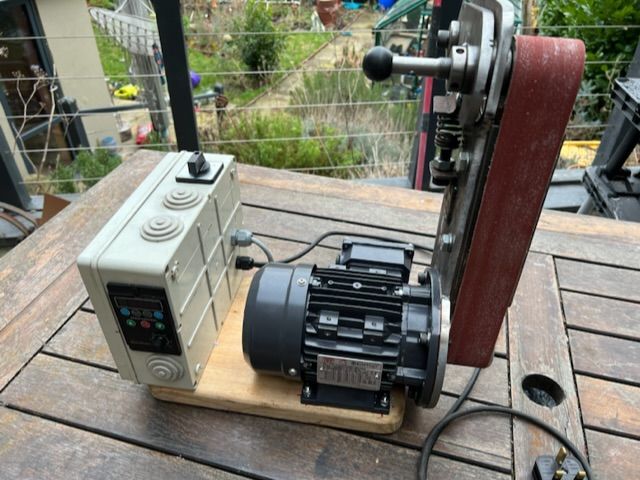

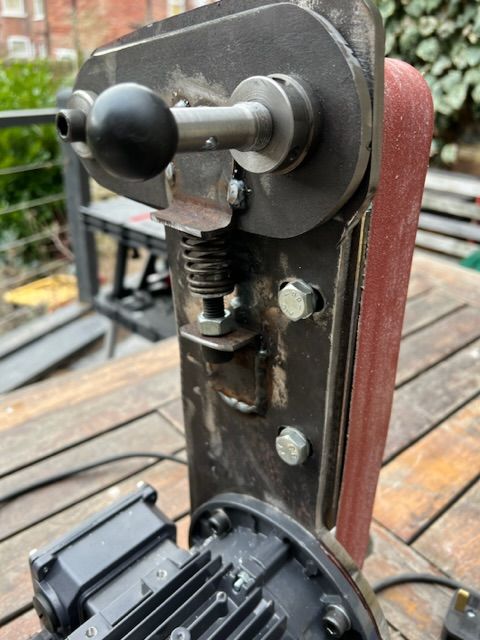

                              Well i bodged it
                              turned the lot as one screw cut the threads and then cut with the bandsaw (1mm kerf) about 3/4 the way through the 35mm boss then squeezed it in the vice and welded it up
                              measures as well as my original
                              Its for a belt grinder the tracking adjustment for the pulley

                                    The original shaft is from a Robert sorby proedge
                                    its a very elegant way of tracking the belt

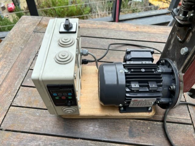

                                            i can see that the Axminster one just has a knob…do you know how that works? Is it on a hinged spindle to adjust tracking? The sorby one whilst needing the tommy bars once set I’ve never adjusted it in all the time I’ve had it perhaps 7 years or so with many hundreds of belt swaps and new belts.
                                            this is my finished machine for use in my metal working room…the genuine one is by my woodturning lathes
