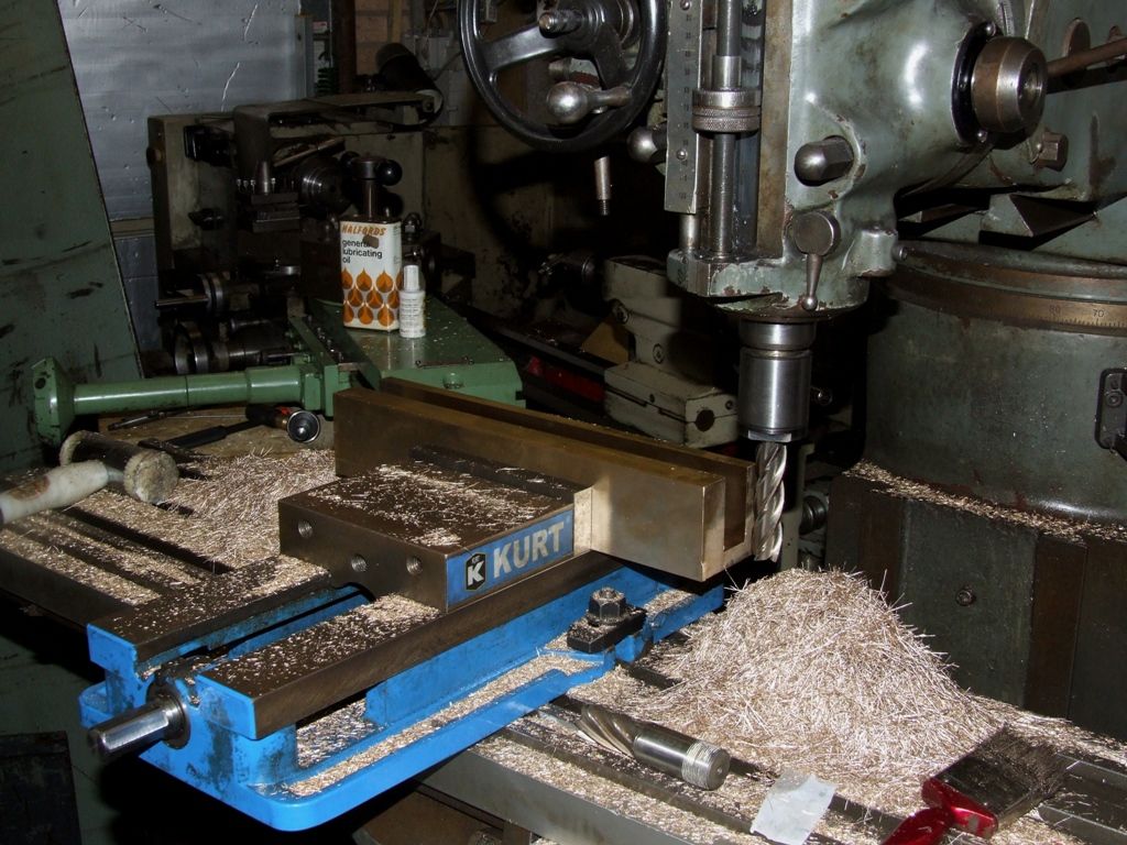

                                  A machine vice needs to be sized appropriately. My main vice overhangs by about a third:
                                  Personally I wouldn't bother with a swivel base. On the few occasions where it might have been useful I just clamp the vice at the appropriate angle. I've never used my machine vice parallel to the table. If I need to clamp something parallel I clamp direct to the table, or there are vices designed for the purpose:
                                  I reckon 75-80% of my machining on the vertical and CNC mills uses the machine vice. The remaining percentage is with the work in the dividing head, rotary table, clamped to angle plates:
                                  Or clamped to the table:
                                  On the horizontal mill it's the other way round, I rarely use the machine vice:

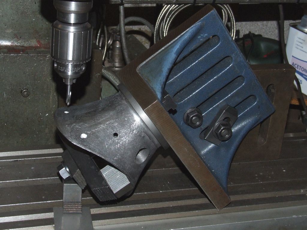

                                        It is also worth looking at the design of the vice, The Versatile that I showed, like Andrew's Kurt has a lip all round it which makes it longer and wider though the lip helps if you did want to mount along the table, The SG Iron one the OP is looking at is a bit narrower so will hide the dials less and something like the Vertex K4 that I use on the X3 is narrower still.
                                        I also don't use the swivel unless needed, that photo was taken when discussing Vice sizes with Ketan to decide on what suited the starter tooling sets.
                                        Actually to get the most out of the Versatile and SG vice you may have to mount it length ways when using the swapable jaws to their full extent eg when used to hold thin plate – no need for low profile clampswink 2
