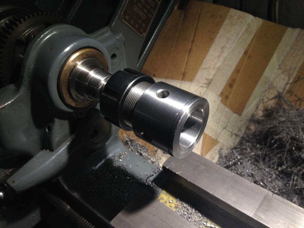

last July we brought a homemade Myford ER32 collet chuck off of the well known auction site. It looked to be well made but was made for a early Myford as the register diameter was smaller (i believe they were smaller please correct me if I'm wrong) This didn't really worry us as we would just bore it out.

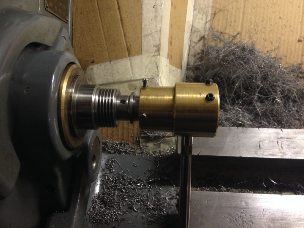

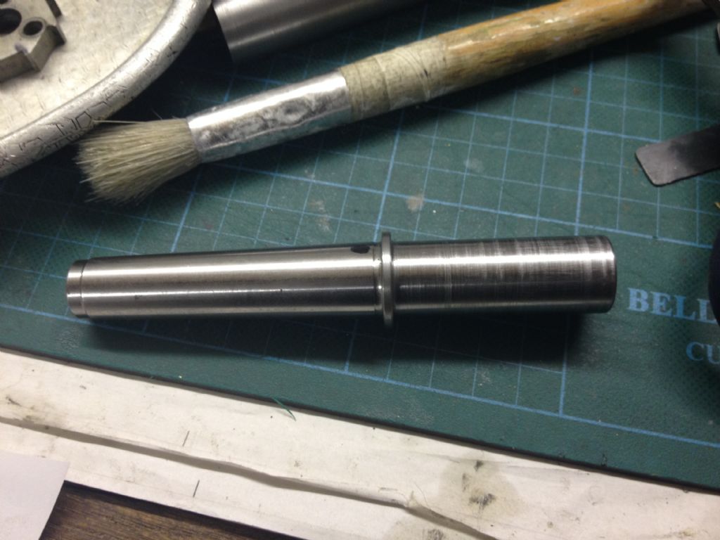

Well it has sat untouched since July and having assured ourselves that the lathe was as level as we could get it, we decided to have a go at machining the collet chuck to fit our lathe. Well first we finally made the morse taper mandrel to use our tailstock die holder without a drill chuck and the original aluminium mandrel. We purchased the soft stub 2mt arbour 2+ years ago for use on the original mini lathe, but we never got around to machining it to use.
Here's the finished mandrel on the bench (the surface finish looks worse on camera)
And with the die holder.

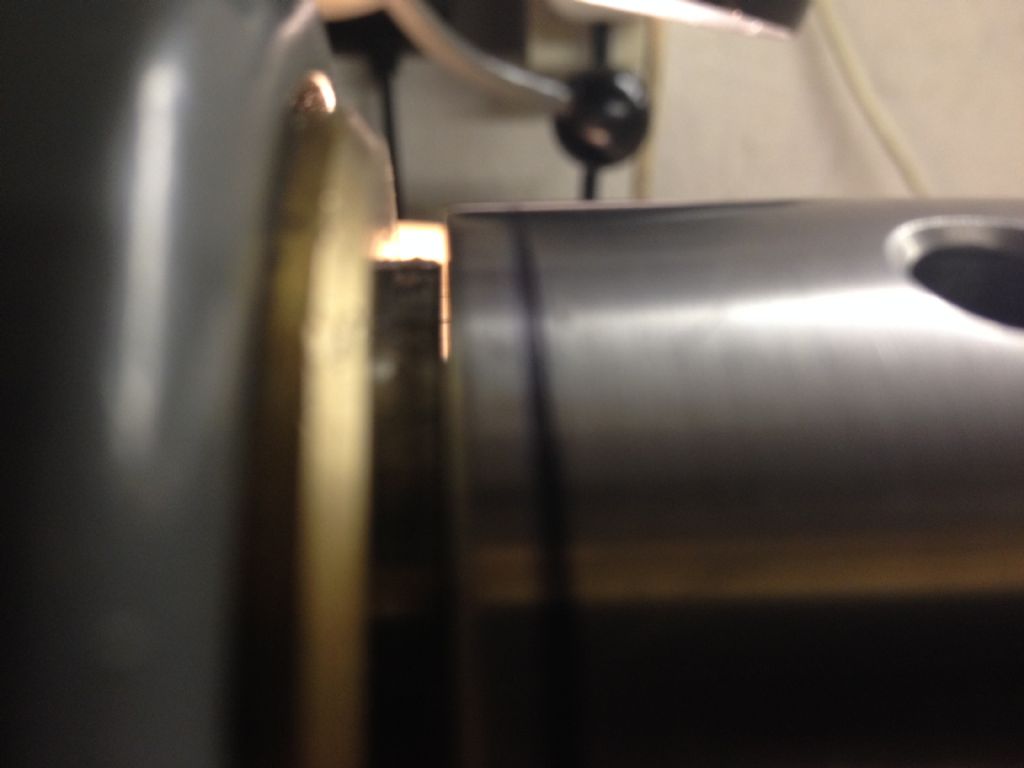

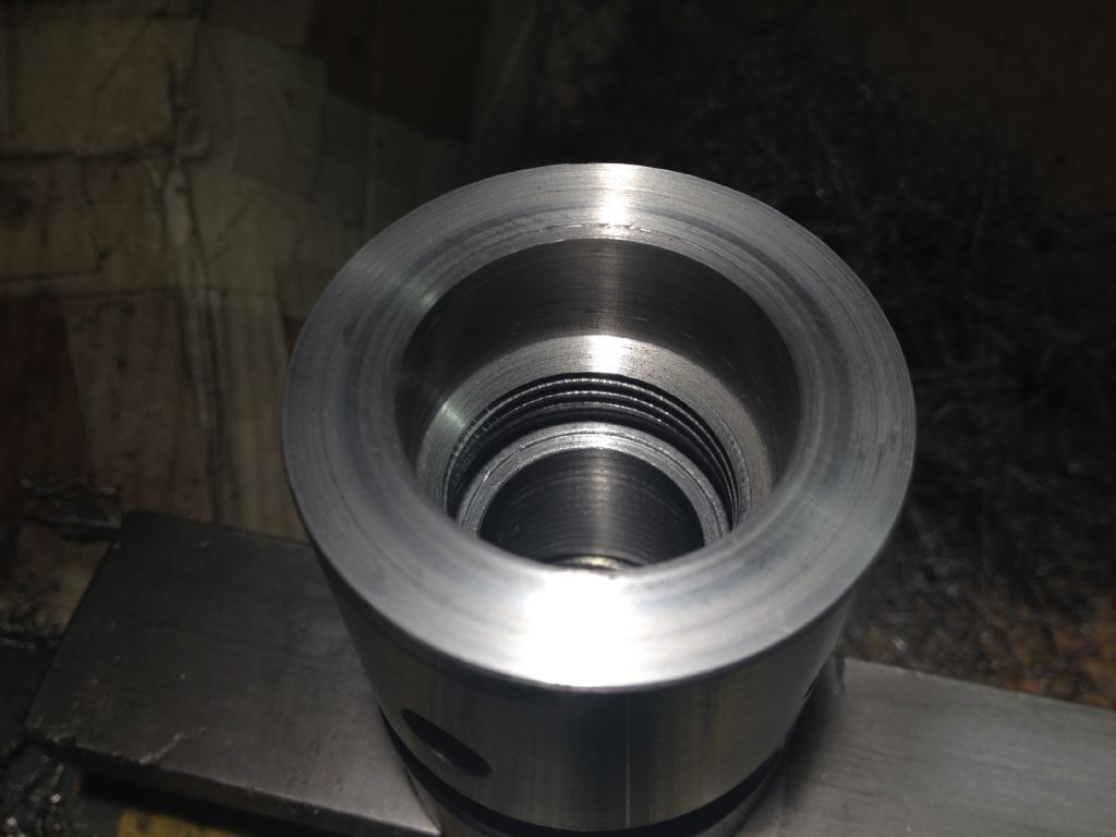

Boring it out was very nice, went very uneventful, no issues. Also skimmed the rear face to be perfectly square with the bore. Now here comes the problem, when the collet chuck is screwed onto the Myford spindle nose it goes on nice no tight spots all good, then when it reaches the rear alignment face only half of it actually touches it, the other half is about 0.04mm away.
This gap is multiplied over the whole length of the chuck and workpiece so the run-out is terrible.
The spindle has no detritus on it nor does the collet chuck. the depth of the bore is plenty, replicating our other chucks which have no issues with alignment. The collet chuck doesn't appear to be contacting any part of the spindle which it shouldn't and it always has the gap in the same place, every time it is screwed on. It does decrease the tighter it is screwed on but I'm afraid that it remain on if I attempt to tighten it up any more! None of our other chucks require much force to put them on.
I would like to get the 2 surfaces to contact all the way round but I can not see what is preventing it, the only thing that may be the cause is if the thread inside is off somehow. I Accept that once these 2 surfaces are in full contact truing up the collet taper bore will ensure it is as concentric to the lathe spindle as possible.
