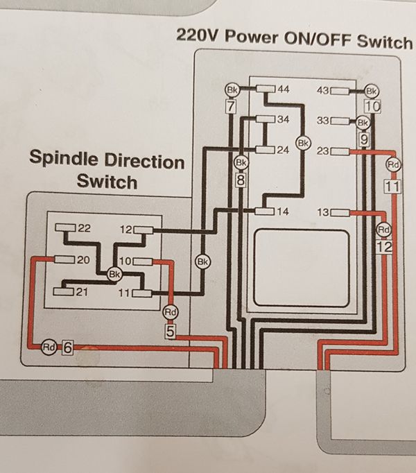

      The cheap and nasty switch on my Chester 626 mill needs replacing. I went straight to the Grizzly manual, where the circuit diagram shows that the main ON/OFF switch has 8 terminals. Does anyone know where I can find a switch with that many terminals? All the safety switches from RS and Ebay seem to have fewer. I would have attached my Grizzly circuit diagram here but the software forbad it..

                    The image below is from the Grizzly manual, which is for a 626 turret mill very similar to the one I purchased from Chester. When I bought my mill the switch looked flimsy, so I protected it by enclosing it in a diecast box, which perhaps confined the disintegration of the plastic (because of WD40 spray or other fluids) to the front. The switch contains a solenoid device which prevents unexpected startup after a mains interruption. I opened my box and found that the switch plus its ON and OFF buttons can be bought from Amazon for about £50. The product name is KEDU KD11 8pins Waterproof electromagnetic switches JD3 Relay ON-OFF Push Button Switch with Power Failure and Undervoltage protection for Machine Tool Equipment 230V 16 A. If anyone else has to replace their switch I recommend labelling all eight leads according to their position or according to the numbers on the diagram attached to the switch.

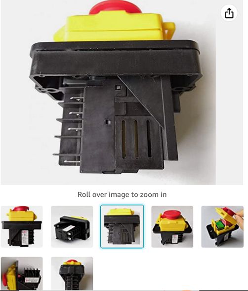

                        Here is a photo of the label on the switch I have bought from Amazon: the photo is is just a screendump from the Amazon page. The label is identical in every way to the label on the broken switch. I will send a photo of the entire Amazon switch from the same source in a second posting.

                          For Vic and others who may want to replace a switch on a Chester 262 mill: here is the Amazon photo of the entire switch taken from one side, showing four of the eight pins. It seems that although the model number is the same as my (nearly ten year old) one, the front of the switch is slightly different, having a latched hinged cover for the ON switch. As promised in my previous post, I will report whether this replacement works

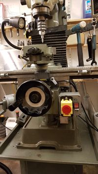

                                      As promised, I am now reporting that the solenoid safety switch I bought on Amazon for my Chester 626 mill has arrived. I have fitted it (see photo) and it is a correct replacement for the original one supplied by Chester, which disintegrated recently. The new switch works perfectly. It has the same label as in the Amazon photo which I posted, and the original had an identical label. Replacement was straightforward: the labels I had attached to the 8 leads when I remounted the switch in a diecast box about 8 years ago had started to fall off, so I replaced them with new labels ( using white insulating tape and a black Sharpie marker) . I then fitted all 8 crimp connectors to the 8 pins in the new switch in the same 6 + 2 pattern as in the original switch. The switch faceplate has two holes 83mm vertically apart, same as the original, which I re-used to mount the new switch in my existing diecast box.
                                      I will inform Chester of this. I noticed that the plastic around some of the crimp connectors had gone brown, presumably as a result of overheating. amazon switch small.jpg
