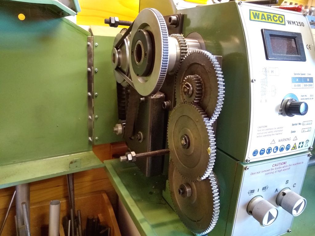

      Hi everyone, with retirement looming I am setting up a home workshop. I’ve been an engineer since being an apprentice back in the seventies. Just bought a Chester DB8 lathe from a member on here, next is a small mill.
      Anyway the reason for my post is twofold one to say hello the other to ask what have I done wrong or not. Just set the lathe for slow feed and now have a gap between the securing screw and the bottom gear and no room for a spacer.
      Hope you can see what I mean in the photo. Now the next problem how to post a photo ??

            Hello Andy,
            I expect you have already done this, but I would double check the gear set up matches the frontpanel info.
            Looking at your photo, you could try swapping the two smallest gears in the cluster. The top-most small gear appears to have a bigger diameter than the middle mounted small gear.

                  Andy,
                  Thats an interesting one, I don't have that particular machine but looking at the photo, could you not reverse the order of the gears on each stud starting from the top to bring the large gear to the end of the lead screw, you would then have room to fit a small gear behind as a spacer (or indeed if you have a spacer – the spacer). Shouldn't change the overall ratio, just the relative positions of the gears if you get my drift?
                  Paul.
                  Doh, cancel the above!  Looks like the position of the first gear on the mandrel is fixed and would need the pulley etc removing!  Also it wouldn't change to relative clearance at the bottom. Sorry.

                    +1 to what Paul suggests. The two small gears are both driving gears and the two large ones are driven gears. As long as you keep the order driver-driven-driver-driven it is just a matter of finding a setup that works, often putting two gears with as near possible sizes together as the combination in the middle works out to be the easiest setup. As Paul says, this puts the largest gear in the final position. The other thing you may have to try is the smallest gear in the first driver position.

                          Looks wrong for the fine feed as you don't seem to have the largest gear on the leadscrew. Would have expected something like 80T on the leadscrew and intermediate and 75 meshing with the fixed gear on the spindle then the spacer will fit.
                          Can you post  a photo of the front panel where it shows the gear layout.

                            Don't know if it is just a photo effect but it doesn't look like the last gear in the train is actually on the leadscrew! (I'm sure it is though). My WM250 which has pretty much the same system looks like this. Last gear on the leadscrew is 80 tooth for the slowest feed.
                            The change gear diagram from the cover looks like this for the slow feeds. 'H' indicates a spacer though I have no idea what 'H' stands for.
