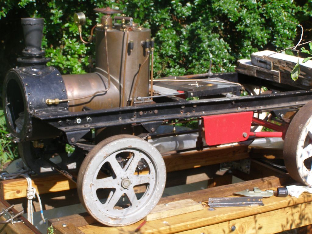

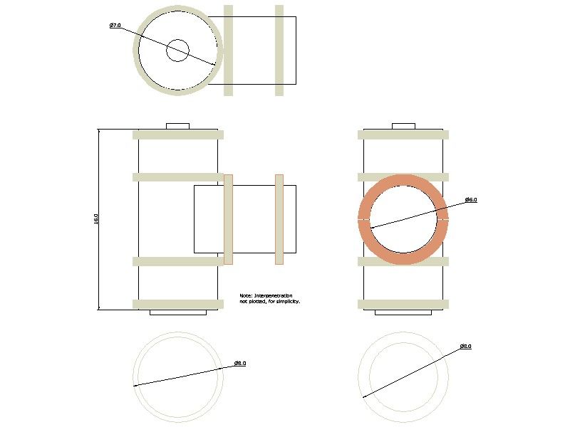

      For boiler cladding crinolines.
      (Yes I know a proper drawing would help but I don't have one! The simplified drawing and photo below might explain things.)
      My wagon's boiler is an unusual shape, a T-piece with 7" o.d. X 16" high cylindrical outer firebox, and a short 6" o.d. horizontal barrel at half-height. The latter's barrel diameter is level with the chassis rail tops.
      The barrel enters for about 1/2" into the 8" o.d. smoke-box, on which a ring of "rivets" (M3 round-head cap-screws) holding the annular channel adaptor-plate narrows the cladding overlap to about 1/4" .
      It also needs a cradle fitted to an inverted-arch chassis cross-member, below it, for support if the smoke-box is removed. (as it would be if I needed lift the boiler from the vehicle.)
      So cladding is somewhat awkward!
      My thoughts:
      A wooden half-circumference cradle on the cross-member.
      Two rings of 8" od X 6" i.d. on the barrel; the front one helping support the cladding sheet's overlap on the smokebox.
      Two pairs of rings 8" o.d. X 7" i.d., each pair above and below the barrel, on the fire-box.
      So 6 rings and one half-ring.
      Question:
      At a working temperature of about 200ºC (90psi), how would these cope:
      – ordinary soft-wood, the rings made in 2 or 3 layers of sectors overlapped, glued and screwed together on their faces, and so the grain on each part is not far off concentric, for strength.
      – exterior-grade plywood, possibly 2 or 4 layers depending on layer thickness,
      – MDF
      All finished turned sub-assemblies then soaked in preservative.

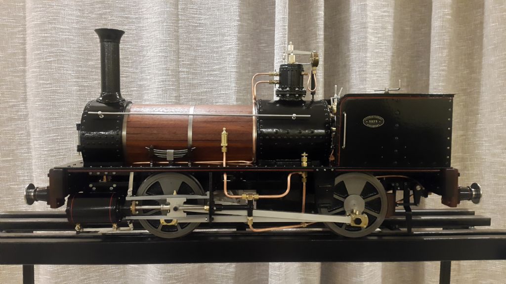

          Hi Nigel, I can't help with the types of wood you have listed, but getting a small offcut and checking how it reacts in the oven will be a good indicator. I don’t think you need something that will handle 200DegC.
          For the cladding I’ve done; I used scrap sleeper wood. It smells and looks like rosewood for these two models. I chamfered the corners and glued the strips to the barrel using RTV silicone. This allowed movement and kept the strips from bowing outwards. Then strapping doesn't really matter. The unpainted wood was treated with linseed oil, and the Fire Queen painted by brush using 2K. Hope this helps….
          #660431
