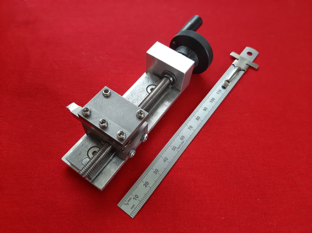

                          #622375
                          geoff walker 1
                            @geoffwalker1
                            Hi All,
                            A long time coming but here it is a top slide for my sherline lathe.photo1.jpg Based on the unimat 3 design, works well I'm pleased with it.
                            If interested there are full details in the December MEW.
                            Thank you, Neil.
                            Geoff
                            #622378
                            bernard towers
                              @bernardtowers37738
                              I have made parts in 6082 T6 for my Taig and Shoreline in the past and home anodised them and they have stood up to my usage, and if sliding on sherline parts they will be hard anodised.
                              #622397
                              old mart
                                @oldmart
                                The cost of the aluminium and having it hard anodised would be more than using cast iron. If the mating part is also aluminium, then keep the joint well lubricated.
                                Geoff Walker's picture shows an aluminium frame, but the moving parts are steel, by the look of them.
                                Edited By old mart on 23/11/2022 21:24:13

                                    Posted by old mart on 23/11/2022 21:21:39:
                                    … and, as the man wrote : If interested there are full details in the December MEW. yes

                                    geoff walker 1
                                      @geoffwalker1
                                      Hi Michael
                                      Thanks for the "thumbs up"
                                      I abandoned the idea of a hard anodised slide on practical as well as economic grounds.
                                      I did however seek to avoid any ferrous materials being used that came into contact with the cross slide.
                                      The low profile unimat slide design is perfect for sherline where vertical space is at a premium.
                                      I notice that proxon lathes also use the same design
                                      Geoff
