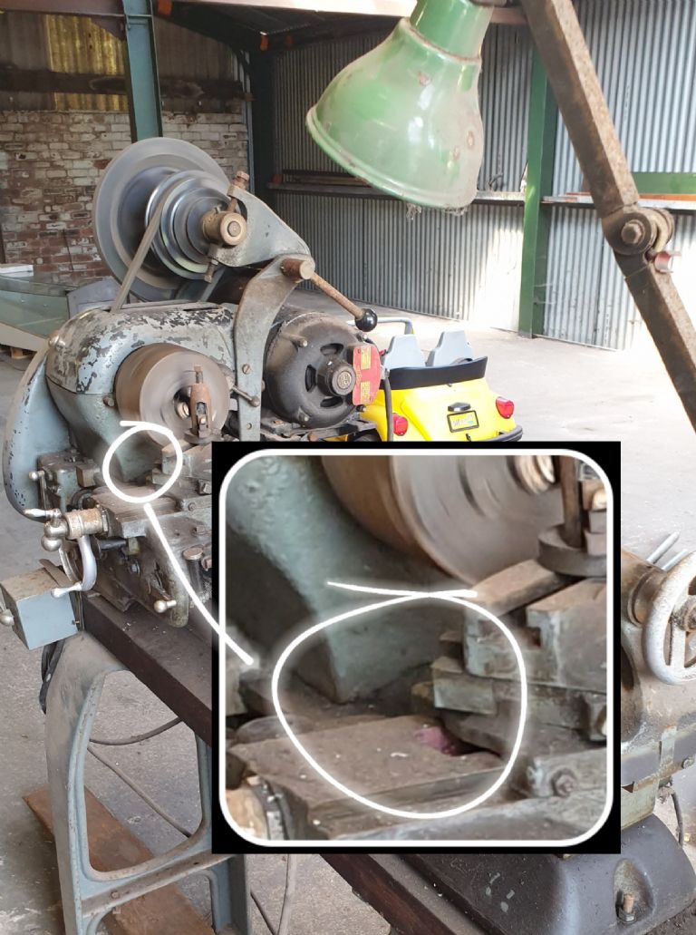

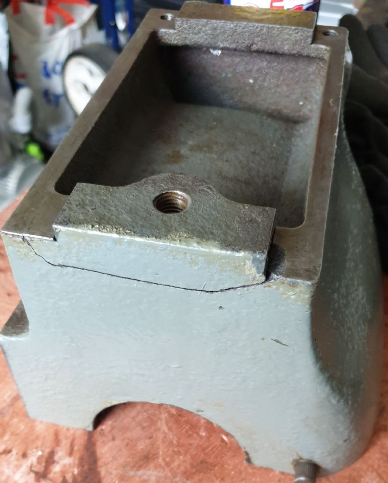

      After having a Myford ml7 stolen from my workshop along with £25.000.00 worth other tools etc ive been trying to re-build my collection of tool so yesterday I purchased the Halifax 524.
      when I've got it home and checked over it to my horror I noticed a big crack below the headstock casting.
      I would be greatful for any suggestion on how to repair this or if this part can be purchased or even re-cast
      Thanks

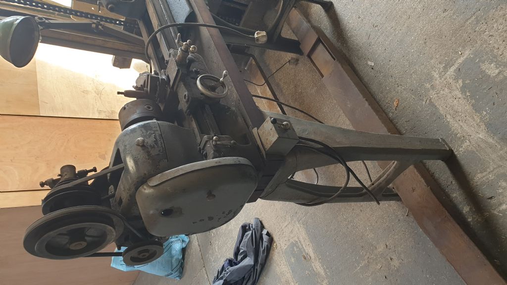

            From what I was able to judge from the pictures you have in your album it looks to be the location/alignment tongue between the bedways that has separated from the headstock casting.
            I fear you may need some professional help to replace the tongue with a piece let into and secured to the underside of the headstock. I imagine there will be alignment screws bearing on the tongue through, most probably, the rear shear so that the headstock can be slewed slightly and correctly aimed along the bed, using a test bar in the spindle socket to check progress.
            All this will need to be done cold I think. With the greatest regard for a skilled welder, any concentrated heat in the area will introduce stress and potentially add to the damage.
            Before any salvage work can be done you need to remove the headstock to assess the full extent of the cracking but before you proceed with that, are you quite positive that this is not some local feature masquerading as a crack in bad lighting? .It does seem to have an unlikely form to my eye.
            Regards Brian
            Edit. Looking again at picture 2 I can see a gap between the headstock and the bed which is of similar width to the crack and what seems to be a clamp strip below the tongue. It is almost as if the headstock and bed have been forced apart and torn off the tongue in the process.

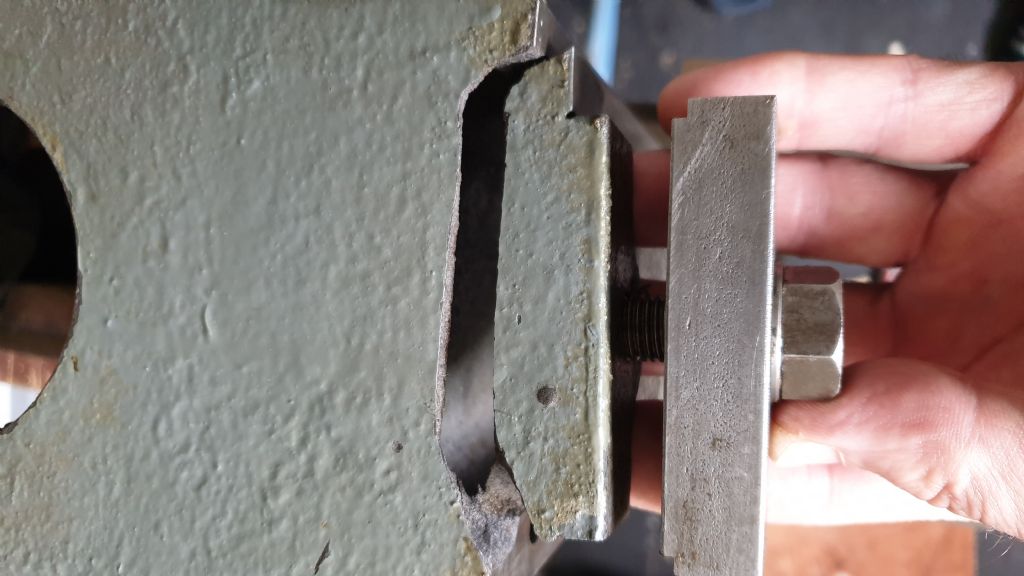

              Hi Brian thanks for your advice, I've just finished taking the lathe apart and discovered even more damage which is very disheartening.
              What I found was at the rear of the Headstock were it's fastened to the bed with 2 bolts the corners of the bed have also snapped off surprise20200622_155948.jpg
              This next photo shows the damage to front of Headstock were it sits on the lathe bed and would be held in place with a thick piece of metal and bolt that clamps the Headstock to the bed.20200622_155708.jpg

                Hello David,
                Oh dear, it just gets worse I'm sad to say.
                To be honest I really don't know what to advise. My suspicion that force has been used to lever up the front of the headstock seems to be confirmed by the broken off corners at the other end which look as though they have failed downwards by leverage from the bolts..
                I find it hard to believe the vendor was ignorant of the situation, there was in effect nothing holding the headstock in position other than gravity. Do you have any hope of recompense with him?
                Kind regards Brian.
                Edit. Perhaps a more likely cause was that the front bolt was pulled up so hard it broke off the mounting but the lathe was used after that and belt tension would have completed the damage at the far end

                        I would make a block of metal to fit inside the hollow heastock casting, secured with two allen bolts through the end of the headstock, and two into the bottom of the block from underneath the spindle, then clamp the broken peice back into position, and drill and counterbore through into the block with another two allen screws. Transfer punch through the threaded hole onto the block, then remove the broken peice, drill the block tapping size, replace the broken off piece, and tap through the existing thread into the block, and fit a longer stud.
                        For the broken ends of the bed, they will neede brazing back on, but first make up two plates to fit under the bed to spread the load to as much as possible of the unbroken area, then clamp the plate on and braze the casting back together, you are going to need a lot of pre heat, or you might do it by TIG brazing it. Awkward and time consuming, but I think it could be done.

                          If you have to, it can be repaired quite well. I would make sure the fractured edges are clean and dry, and using araldite, clamp them together with g clamps. The fact that it is a casting has the advantage of not distorting, so the parts should fit perfectly. Then drill the central threaded hole right through at the bolt diameter. Then the glued on part will not have any stresses on it except tension. A block will have to fit underneath with a tapped hole to take a longer stud or bolt. It might be possible to fit the two broken bits in place and have a plate covering them to take the bolt loading.

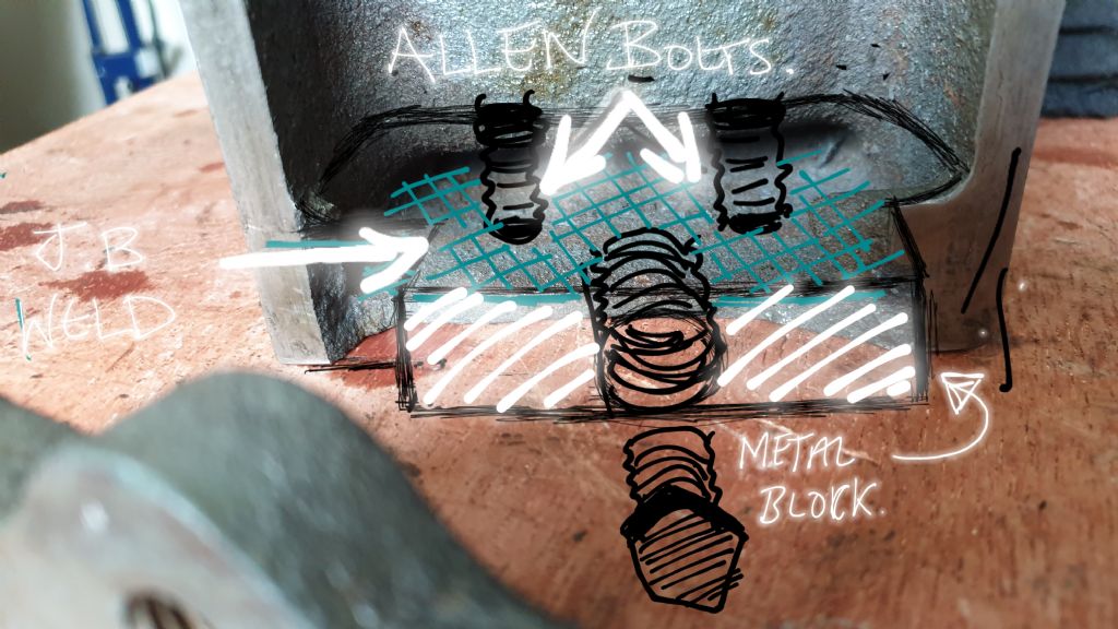

                              I absolutely agree 100% that this idea would be the best way to repair this Headstock I was thinking very similar earlier.
                              I thought about filling the front inside part of the Headstock casting with molten metal to help support it and then tap threads through the casting into the inside metal block..the only problem is it might crack unless its brought upto temperature and cooled down slowly..
                              Also thought about using JB weld to line the inside of the Headstock casting and like you said put a metal block inside which can be tapped ready for allen bolts
                              In the photo I have drawn a bit of I diagram if you can decipher it lol

                                    That looks to me to have been caused by lifting the machine with a sling around the spindle – a tactic I have seen machinery movers use on several occasions & it always makes me cringe.

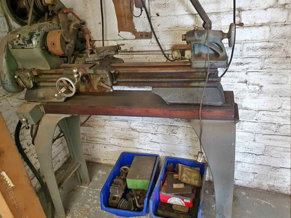

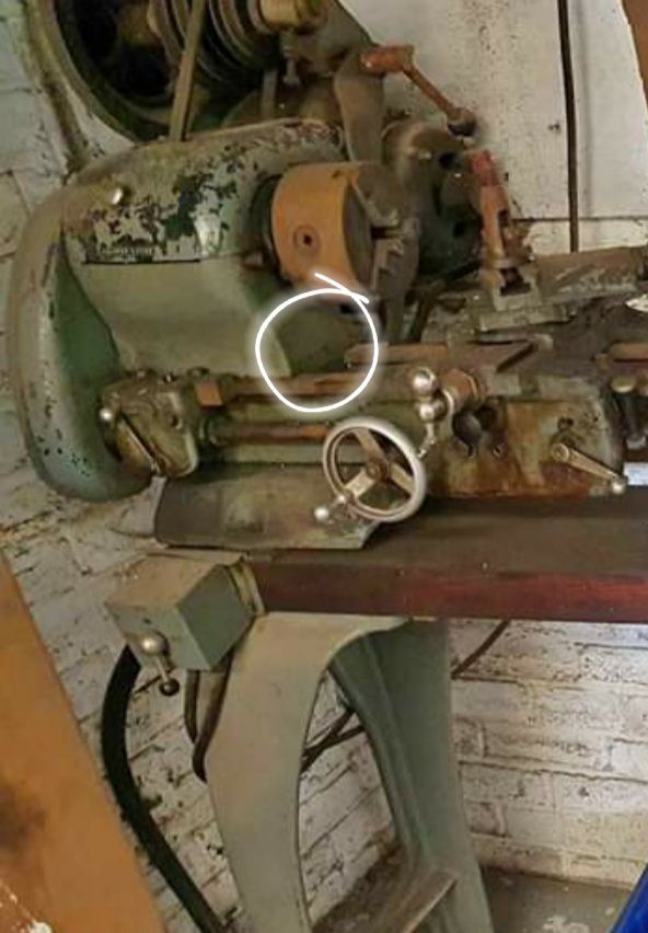

                                              I have looked at the original photograph of the lathe that was used for the advert on Market place.
                                              It shows the lathe in a corner of a building, and when I first spoke to the owner about it he pointed over to that corner and said "that's were the lathe had been stood for 20years" although the lathe had been moved with a fork truck by the time I had arrived to view it (pictured below).
                                              A closer image of the original photo before the lathe was moved, a crack is visible
                                              (pictured below).
                                              On further inspection of a photograph which I had taken with my mobil phone shows the damage was already present whilst at the sellers premises(pictured below).
                                              I also recall the owner telling me that he had used the lathe only a couple of days prior to me buying, to shave a piece of metal.
                                              If this was true, I'm sure he would have noticed the loose Headstock.

                                                Youch. Being that you inspected it in person and accepted it as is , crack and all, you probably dont have much of a legal leg to stand on. You have to rely on the human decency of the seller to do the right thing. Youch.

                                                  I think that the idea that "it will never turn out good work" is completely erroneus. the only purpose these fixings serve is to hold the headstock down to the bed, the alignment and accuracy comes from the machined surfaces on the bed and the headstock. It will be neccasary to check the alignment after a fix has been done, but that would be the case if the headstock had been removed anyway. It is a sad case indeed, but if the OP is not getting a refund. and the lathe needs a rebuild anyway, what do you have to loose? I wish him evert sucess with it! In life, it is the journey that is enjoyable, not the destination, and a plague and a pox on the foul scumbags that stole from you!
                                                  Phil

                                                    Looking at the underside of that casting … it appears that there are no additional parts in the cavity:
                                                    Therefore, my approach [once I had recovered from the shock] would be to fill it with epoxy ‘granite’ and incorporate improved fixings.
                                                    Have a look at forum posts by John McNamara, and also search for Granitan

                                                      I'm with Phil, I think the headstock can be fixed with no loss of accuracy. Ways look intact. Looks like lots of metal below the broken bit that could be used to take some threaded holes for longer bolts up from the bottom under the bed anchor plate. For alignment across the bed, maybe a new block close fitted to the bed gap could be used, fastened to a plate bolted where the broken bit is, with adjuster screws like a tailstock adjuster. (The mounting screws could pass through this lot in large clearance holes.) The across-bed alignment would only need to be set once during centres alignment after the repair, then locked in place with setscrew-on-setscrew method. New anchor plates headstock to bed can be made also, if need be, from cast iron bar or mild steel.
                                                      As long as the ways on the headstock and the bed are not broken out it can be saved and will make lots of good work for years to come.
