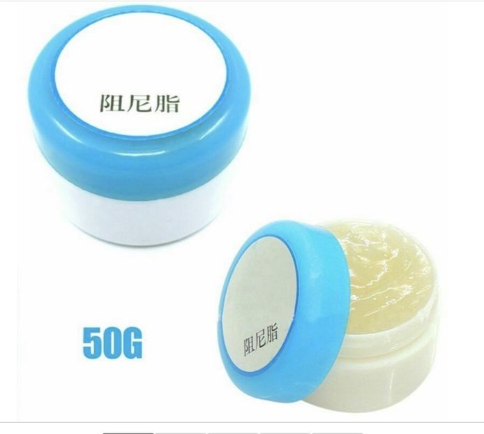

      I'm attempting a repair on a compact digital camera. At the base of the lens there's a rotating bezel which is a push fit over a plastic ring, which also rotates when the bezel is turned.The whole thing is about 50mm diam, by about 5mm deep. When I took it apart, the only link between the two seemed to be some sort of high viscosity grease- not an adhesive.
      If I want some similar grease, can anyone give me an idea what to look for? Or what I might use as an alternative?

          Google kilopoise

            Posted by Richard Evans 2 on 24/11/2022 16:31:00:
            Look on ebay for some high viscosity grease in a small plastic tub with a pale blue lid
            … it works for me

              That ebay grease is rather elusive, but if "high viscosity damping grease" is searched for, there it is.

                Posted by old mart on 24/11/2022 20:50:32:
                and [as it happens ] those are the very words I used in the ‘Brief description’ of the photo in my Album

                   As it happened, there was an easier source of the very thick grease that will not migrate into unwanted areas, the grease used for car disc brake mechanisms. it comes in little sachets and is likely to be available at a car spares shop, quicker than the post from China.

                      Thank you Robert and Michael, that looks like exactly the sort of thing I'm after. There's someone on Ebay selling 1g tubs of something called Nyogel 767A for a fiver (and other variants), which seems the easiest way to go. We were quoted about £250 for complete new lens assembly so I'm feeling quite pleased with myself.

                        I will just mention that when I wrote “it works for me” I was referring to the fact that I have used the Chinese grease very successfully on the helicoids of adjustable microscope eyepieces.

                          I believe the linear and rotational 'dashpots', so common now on so many things, use high-viscosity silicone grease. I have a tube of Molycote silicone grease, which, apart from its usual use on O rings and seals, has worked well in similar applications to the OP's, and it's plastic-safe.

                                  Just a quick update… the grease arrived yesterday having been held up in the postal strike. I assembled the multi-function ring with the grease and I now have a fully functioning camera! I straightened the aluminium alloy bezel using a tapered mandrel, with a final skim of the inner surface in the lathe.It's not perfect- the alloy is very hard- but it works. So thanks again for the help from members of this invaluable group of people.
