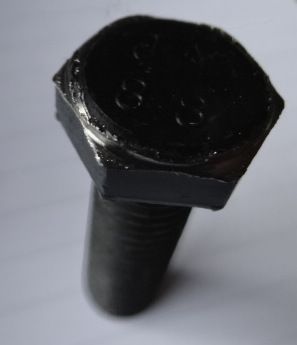

      Can anyone suggest how to select a proper carbide tip (10mm shank) for turning gr8,8 steel on a Myford
      I have struggled with ones that came with those tool sets on EB but of course I am deeply suspicious about the quality of the tips – they will cheat you if they can , its a national sport)
      I found a 60deg diamond tip seemed to loose its edge quickly and I ended up with a poor cut finish on 20mm dia taking 50mu cut at 1500 rpm
      These carbide tips are still a bit of a mystery to me but I couldnt touch this steel with HSS
      Any advice please

            Something wrong there. Here's the head of a 12.9 M12 bolt I just machined with a 5/16" square HSS knife tool that just happened to be lying next to the lathe:
            Running at 540rpm with a feed of 4 thou/rev and DOC of 10 thou. The finish looks worse than it is real life. A few measurements gave an average surface finish of 1um Ra, which is about as good as I get when turning.

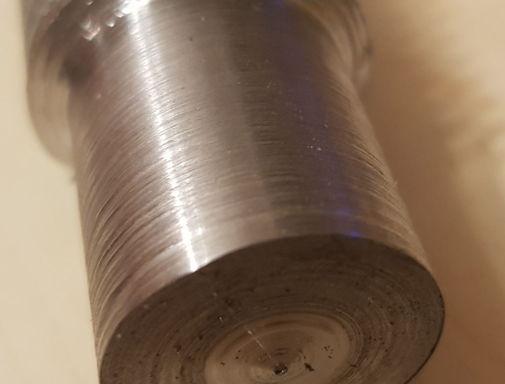

                          Well at great expense I've sacrificed an 8.8 bolt (screw actually) of unknown parentage and taken a few video clips.All carbide at approx 1130rpm and 0.4mm (0.015thou) DOC All on a far eastern benchtop hobby machine. In order of appearence:
                          CCGT 060202 @ 0.04mm/rev (0.0015thou)
                          CCMT 060202 @ 0.04mm/rev
                          CCGT 060208 @ 0.04mm/rev
                          CCGT 060208 @ 0.08mm/rev (0.003thou)
                          CCGT 060208 @ 0.02mm/rev best finish but lost that bit so will post finish tomorrow
                          Lastly a random HSS bit not even on ctr height at 600rpm and 0.02mm/rev
                          Sorry about variable focus the moving chuck and swarf were confusing the camera but you get the idea.

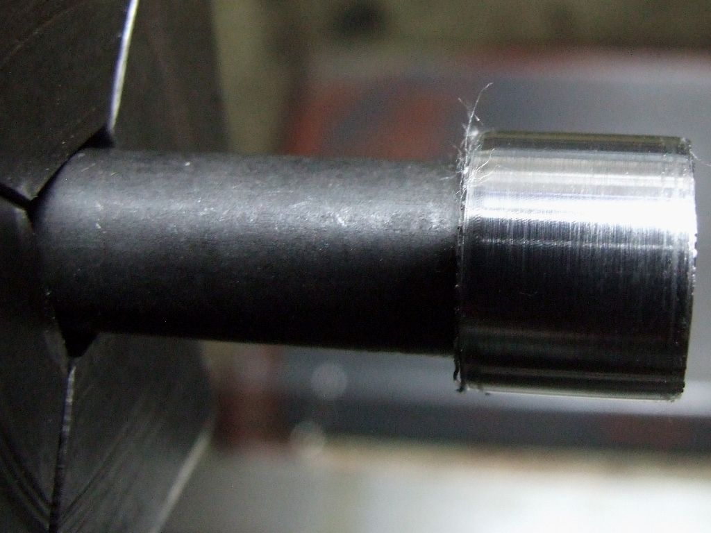

                                              Well JB if I had obtained anything like the results you showed on your vid, I wouldnt have posted this thread
                                              I have formed the simple idea that using carbide
                                              a) the tips are not sharp as per HSS, they are deliberately rounded slightly becasue a sharp edge in carbide would quickly chip and fail, so rounding gives better strenght
                                              b) because of a) above using carbide is like having to punch through a tough thin skin on the work piece to get through to a softer core which can be cut properly. Its counter intuitive to HSS viz with hacksaw you dont put more pressure and saw faster when you feel the blade is blunt
                                              The pic below shows my poor results, note the ridges and how the surface appears smeared like its been rubbed by the tool
                                              I can only assume that the tool tip with pressure reaches a high surface temp that softens the skin and lets mtl be rubbed off below – what an appalling thought
                                              and this was with a new insert
                                              I dont know what insert code I was using cos I only bought a set of tools
                                              https://www.ebay.co.uk/itm/133809788614?hash=item1f27af56c6:g:JmoAAOSwDD5g5DuQ
                                              the code wasnt specified
                                              As you can see its the worst kind of rubbish work and if thats all i could get I would give up
                                              Maureen wasnt happy with even a mere 5 thou DOC
                                              I did check the bolt and could use a file on it so not fully hardened
                                              A puzzle?
                                              Brian

                                                  Carbine is harder and more heat resistant than HSS, and it's at its best used far more brutally. The bluntness improves edge strength but also suits the rate at which carbide works best. It's counter-intuitive compared with HSS in that improving finish with carbide usually requires higher speed, feed-rate and greater depth-of-cut. HSS tends to improve finish by taking lighter slower cuts.
                                                  Problem with Miss Maureen Myford is she's too slow, weak, and bendy to get the best out of carbide, partly because her electric motor is called Weedy Walter.
                                                  Carbide produces good results on slower machines but it's a tad harder to get good finish with it: experiment.
                                                  The bolt not being fully hardened is a misunderstanding too. 8.8 bolts are tough rather than hard so they can be cut with a hacksaw or filed. However, there's no reason why a steel bolt should machine well. Ordinary mild-steel is a bit soft and smeary, Boron Steels are tough and smeary – an unfriendly material. Pot luck,
