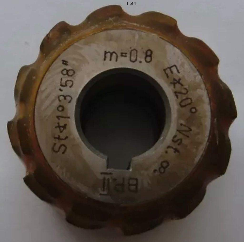

                                    Not forgotten, Bazyle … In fact that was one of the triggers for me to decide to build a 'single-purpose' machine rather than a more versatile one.
                                    The magic number, for the specific hob that I have ordered is 1° 3' 58"
                                    I think we've made good progress on the electronics side. [thanks everyone]

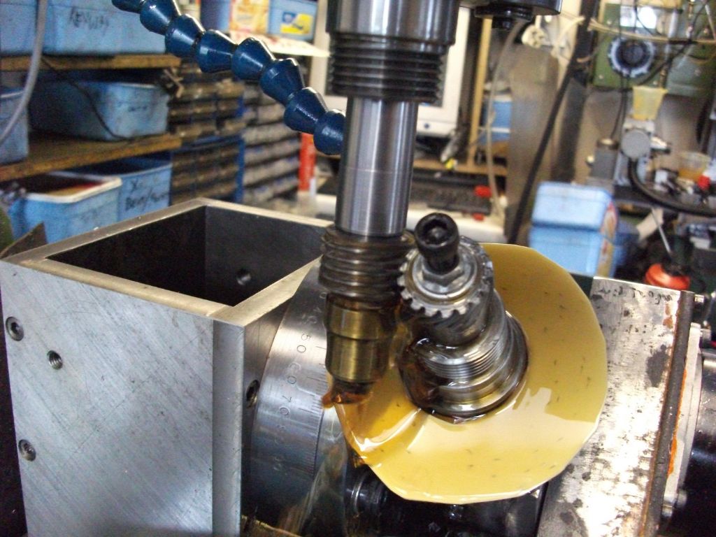

                                                      Back in issue MEW 193 i wrote the article Gear hobbing in the mill,the system designed by Richard Bartlett (Compucut) is not at all similar to the published hobbing unit in Mew 108 as it remains in sync when the spindle is stopped .The article shows the constuction of the spindle ,the offset design keeps the table in close to the column up to the maximum size of gear that can be cut.I don't know if the unit is still available from Richard, [email protected]
                                                      The photo shows the the unit as supplied you just dial in the the tooth count.
                                                      Although you are only interested in making spur gears the unit as shown is only a little more work to be able to produce helical gears.The unit can be mounted at either end of the milling table making it easy to produce small left and right hand helical gears with high angles as seen in the photo's .
                                                      Arc Euro used to sell the hobs but they are no longer available which is a shame as they were very good cutters at a reasonable price.Would be interested to know where you are getting these from.
