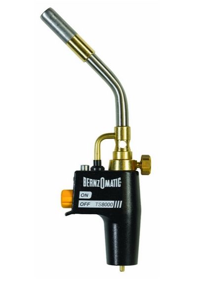

      Hello,
      I am looking to get a small gas torch for brazing & silver soldering of small fittings and fabrications but not for boiler making. Can anybody give any recommendations please?
      Thanks
      Andrew
      #17624
      ANDREW JACKSON 6
        @andrewjackson6
        Recommendations wanted for small gas torches
        #180276
        Paul Lousick
          @paullousick59116
          Hi Andrew,
          A Bemzomatic TS8000 is good for silver soldering and brazing small parts. It has a valve to adjust the flame size and a trigger which opens the gas supply valve and ignites the flame. Great one hand operation. Got mine from the local hardware shop.
          Propane and Map gas canisters are available in different sizes. Map pas produces a hotter flame but costs a bit more. For brazing bigger parts I use an oxy/propane torch.
          Paul.

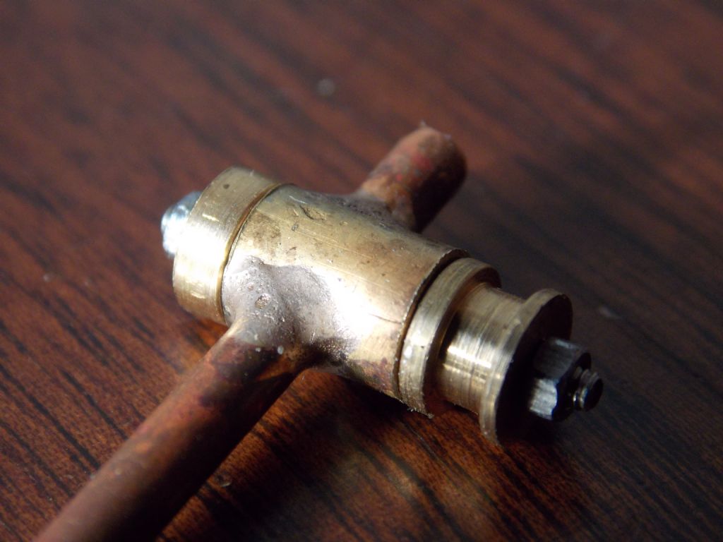

                                        You don't specify the sizes, but I imagine you mean rather small items? The following may be of assistance. They are all silver soldered fabrications.
                                        This governor valve body is small – the copper pipe is only 1/16" diameter and fairly short. I used a turbo-flame lighter (the type that produces a small needlle flame):

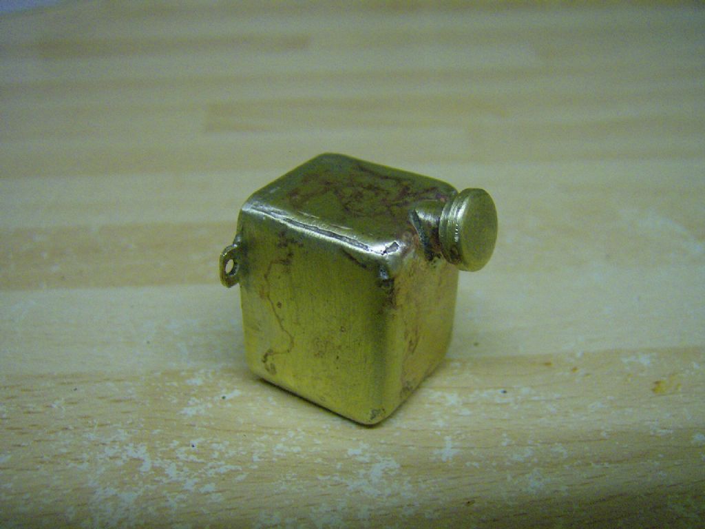

                                        This sandbox is about 1 1/2" high from 16 gauge brass, and at the upper limit for the cook's blowtorch:

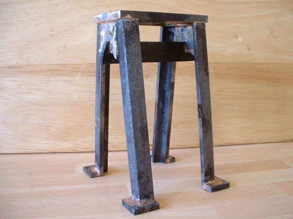

                                        This fabricated cylinder is about 2" tall and comprises 7 parts, it required the use of a screw-to-a-can blowtorch:
                                        Finally, this fabricated engine frame is about 5" high from steel and required the use of the Clark propane torch:

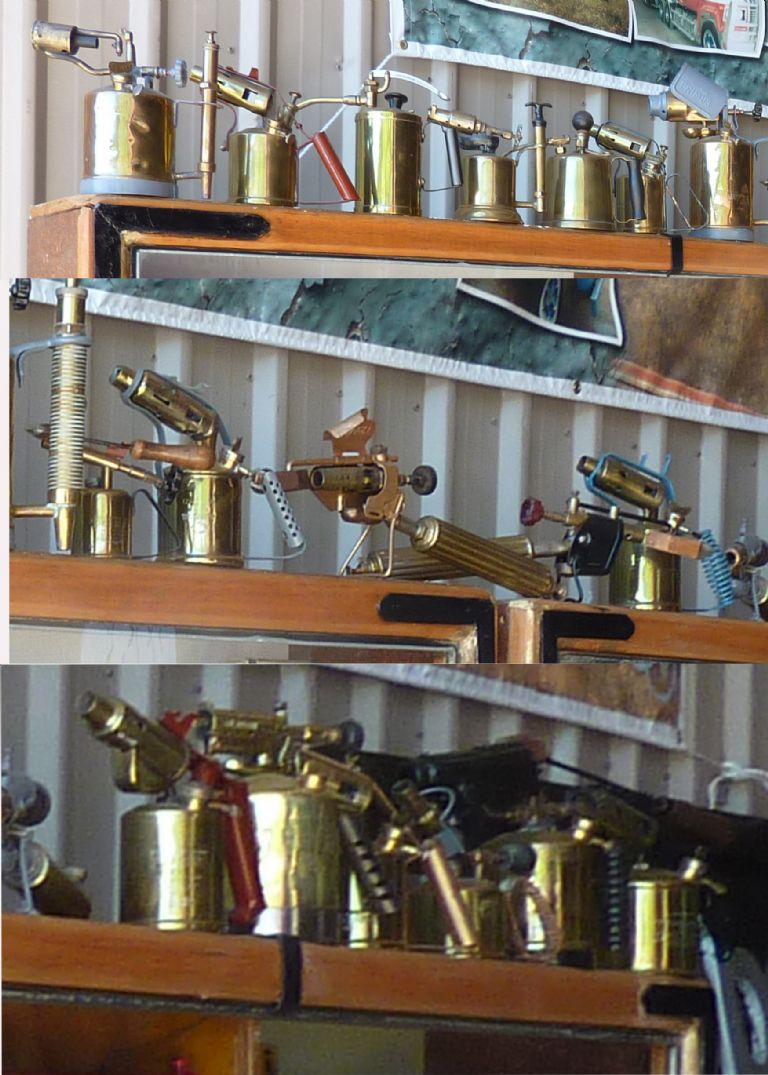

                                              A collection of old petrol blow lamps on display at a recent antique engine fair.
                                              Paul.

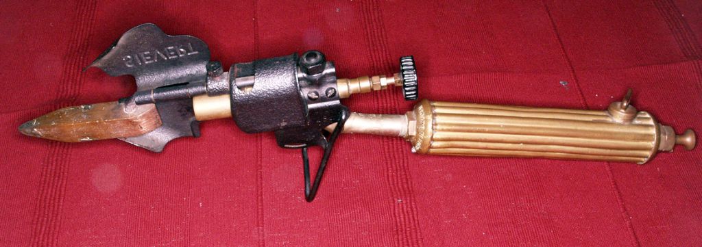

                                                    Not relevant to the thread, but…
                                                    Paul, my eyes popped out of my head when I saw your photograph!
                                                    Many moons ago I was in the Nelson area of NZ, we passed an antiques place on some back country road, my wife couldn't resist, so we went in. Where I found this item:
                                                    Sievert Type 28. I sent my photograph to Sievert, who said that they had no record of the device, they didn't have one in their collection, and that it must be quite rare. And now there's another one, right in the middle of your picture!
                                                    A complete aside – my wife was talking to the owners wife, who was also English – turned out they both came from Upton on the Wirral, and both had attended the same convent school.

                                                      Those Sievert soldering irons were about as common as grass, every plumber had at least one.
