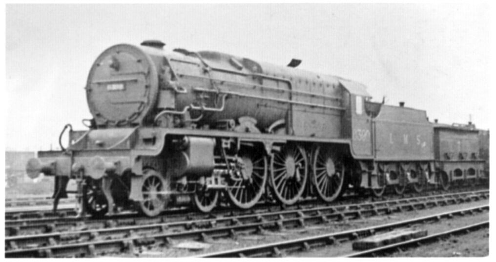

                  "Typically I can't find any photographic examples at present but I'm sure someone here will support or refute this."
                  Herewith image of LMS 6399 about to be towed from Derby to Crewe Wrks in March 1935 for conversion – devoid of coupling and connecting rods….added edit > "at least from the outside cylinders !"

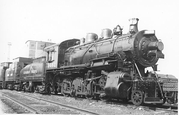

                    Canadian practice was something like:
                    Inside Stephensons – remove the straps, so that they get lost for preservation; (as per the E10-A in Morrisburg, ON)
                    Remove the connecting rods, keep the coupling rods on – but that means removing the return crank.
                    Both CPR and CNR stored locomotives for a bit in case of requirements. Here's a picture of a CPR locomotive stored:
                    **LINK**
                    (courtesy of Ray Kennedy's web pages)
                    Note the lack of coupling rods, the return crank still there, but the crank rod is not attached. I think, if you look at the front of the cab, the "thickness" of the running boards is due to the connecting rod being placed there.
                    You don't want the motion work, or the pistons moving about for a number of reasons; pumping of air, lack of lubrication (even if mechanical lubricator, the oil should go in with steam to keep it very liquid, and going to the right places)

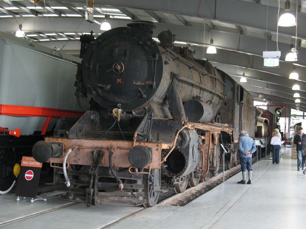

                          My elder son took me to Shildon in 2011 to look at one of the two 2-8-0 locos which had only just been repatriated from Turkey. These are, I think, the engines mentioned above. This is the photo I took:
                          You can, just about, see that the cranks/connecting rods are missing. Indeed if you look closely, ie magnify the photo, you can see the bosses, one adjacent to the notice board and at the bottom, and another at 3.00 on the rear axle.

                            You are wholly correct, this is one of the pair returned from Turkey. One has been sold on as a static exhibit in Israel. The other one has been bought by the Scottish Railway Preservation Society for restoration to running condition. Our one, despite it's outward condition, is actually in an amazingly good condition. The boiler which is inevitably the most expensive bit to restore is in a good condition with very little sign of wear. Tubes and superheaters will need replacing of course, but the firebox sides show little signs of grooving and the stays are apparently mostly intact. Most of the non ferrous fittings are there, the injectors which were missing have had replacements purchased, as have the motion brackets which are currently somewhat bent. Nobody would pretend that it is inexpensive to restore, but it will certainly be a lot less than ex Barry loco. Donations to assist would be gratefully received at SRPS Steam.
