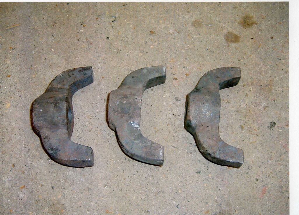

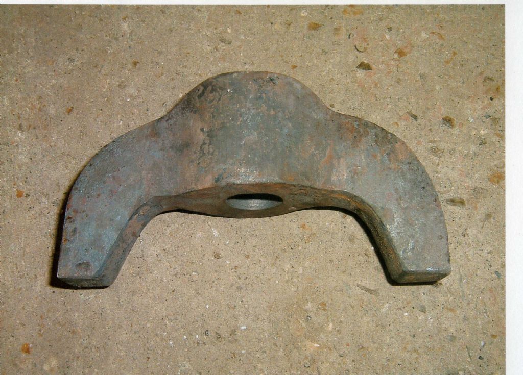

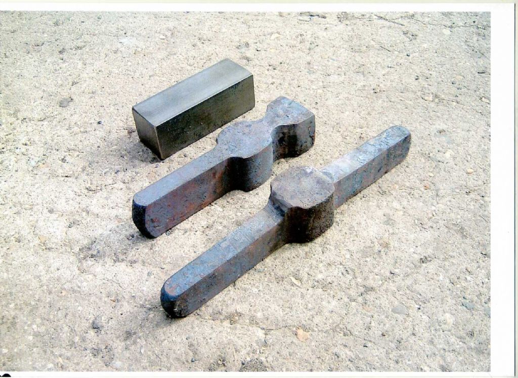

                      Hello everyone.
                      I thought you all might like to see some pictures of a set of full size boiler washout plug bridges that I forged a few years ago, for a 1925, 10 horse power Robey portable steam engine.
                      The bridges started out as 1 3/4" square steel.
                      Richard.

                              HI Richard
                              That's some neat forging.

                                RICHARD GREEN 2
                                  @richardgreen2
                                  Hello Stub Mandrel,

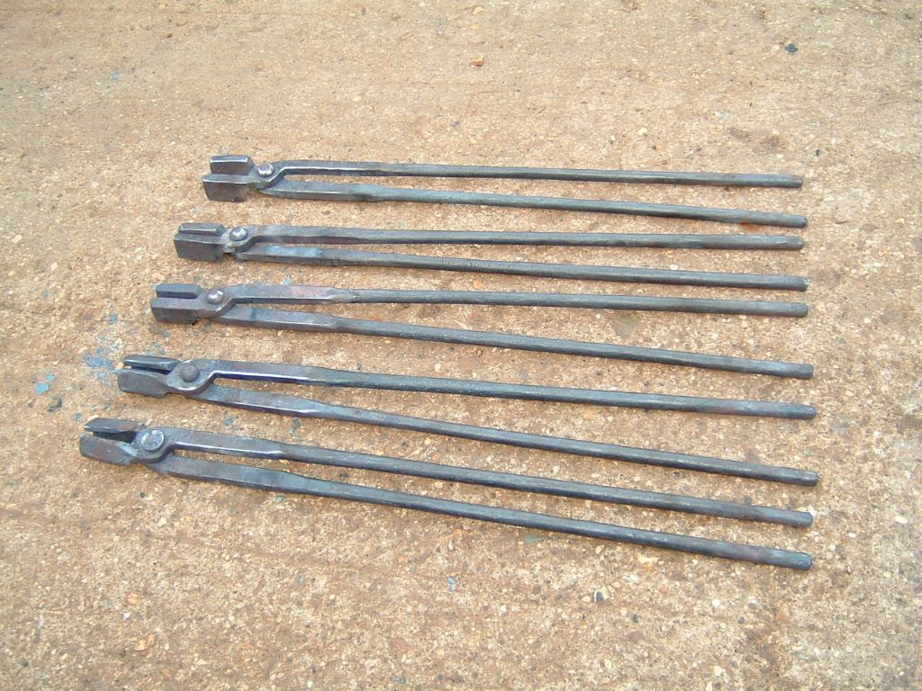

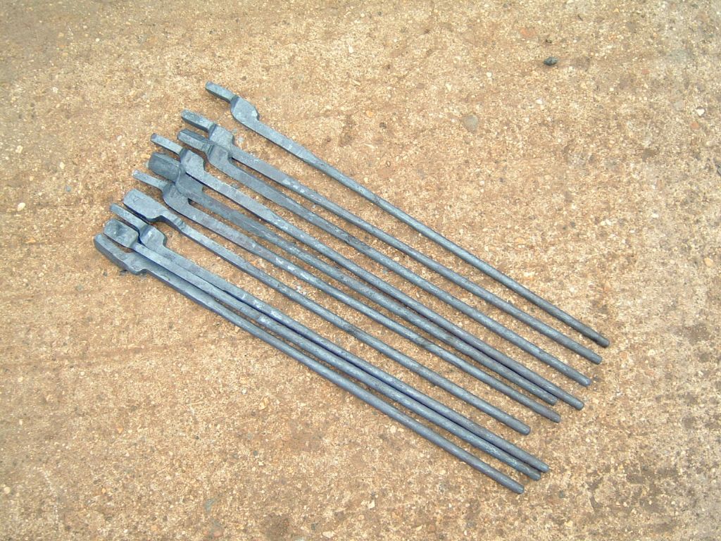

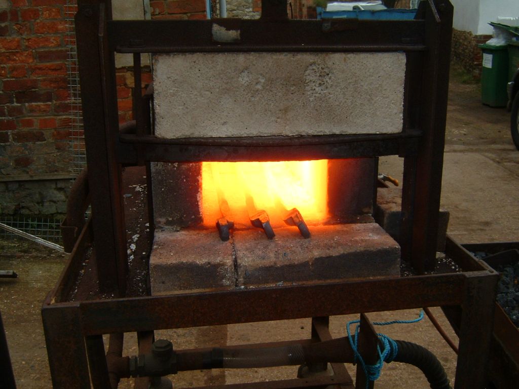

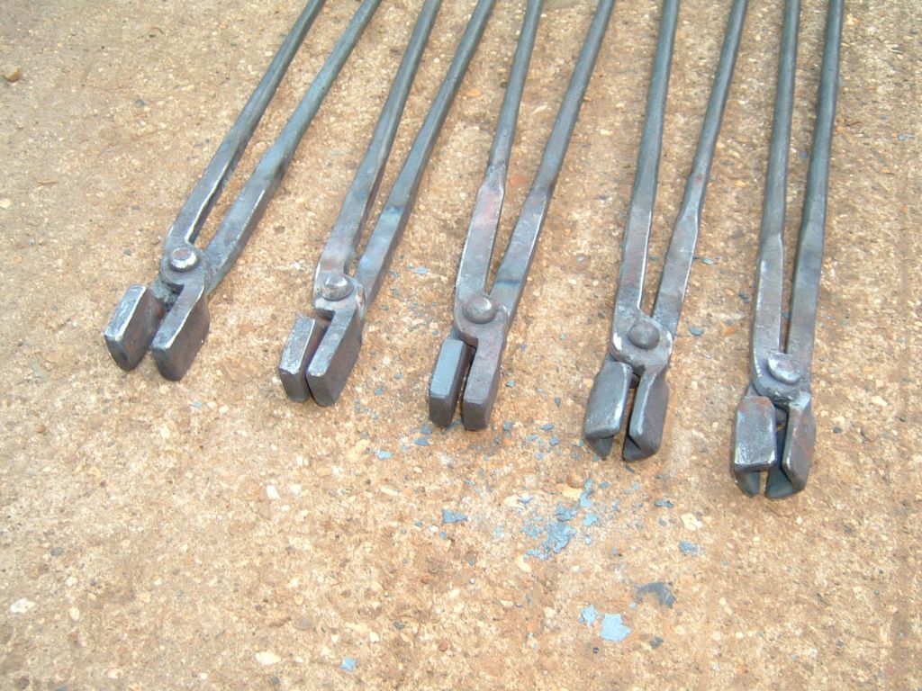

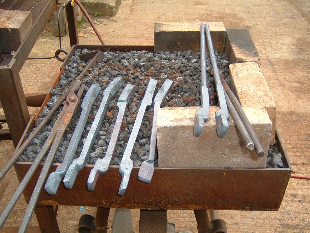

                                  Thanks for the comment, it's appreciated,
                                  Today I'm forging some pairs of blacksmiths tongs, I will put some pictures up later today,
                                  I'll also put up a picture of the propane furnace that I made 15 years ago, that I've been using today to heat the steel to make the tongs.
                                  Richard.
                                  #87076
                                  RICHARD GREEN 2
                                    @richardgreen2
                                    Here are the pictures of the blacksmiths tongs that I forged today, and also a picture of the propane furnace that I use.
                                    Richard.
