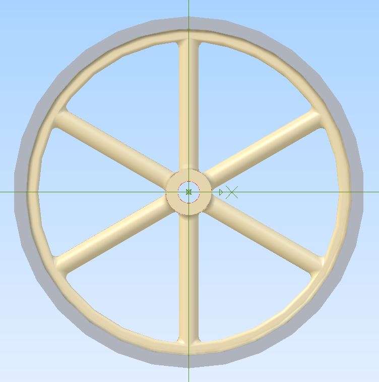

      I am planning to fabricate a spoked flywheel rather than machine from a billet as I have for my previous models.
      I have piece of 7.625″ OD x 0.5″ wall thick pipe x 1″ long. For the hub I have a piece of 1.5″ OD bar. I am planning to use x 6 spokes, 0.25 dia. I have no silver soldering facilities and plan to use Loctite to fix the spokes.
      My query concerns the order of the steps to get a flywheel without wobble. Either finish bore the hub first then assemble to the rim with the spokes then locate the assembly on a mandril through the hub in a collet on the lathe then skim the rim od and sides. I would also use the faceplate to clamp the rim.
      Alternatively bore the hub undersize then fix to the rim then true up the rim and then finish bore the hub at the same time. I worry with this way with the hub being supported by the spokes only it might chatter however if ok it should ensure concentricity.
      I have a well used Myford S7 and a BCA jig borer.
      I would appreciate the team’s thoughts, wisdom and experience.

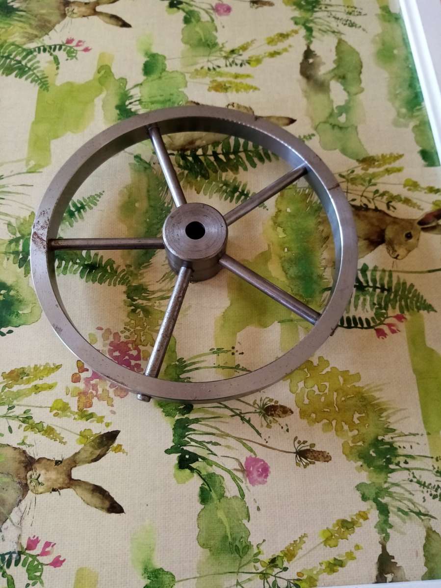

          To some extent it will depend on the size of the spokes and how they are located in rim and hub as these will affect the strength of the assembly
          I’ve never been a fan of holding flywheels by the hub to finish the rim and certainly if they are of light construction would not do it. When I fabricate them I leave the bore in the hub undersize and then once it has all been soldered hold by the rim and finish bore the hub, light cuts with a sharp tool should not cause problems with chatter or excessive load on the joints.
          The downside of screwing together is you need to be very cunning if you are to avoid holes in the rim showing.
          M3 studs retaining spokes in hubs but otherwise all Loctite having the hub finish machined & bored. 200mm dia

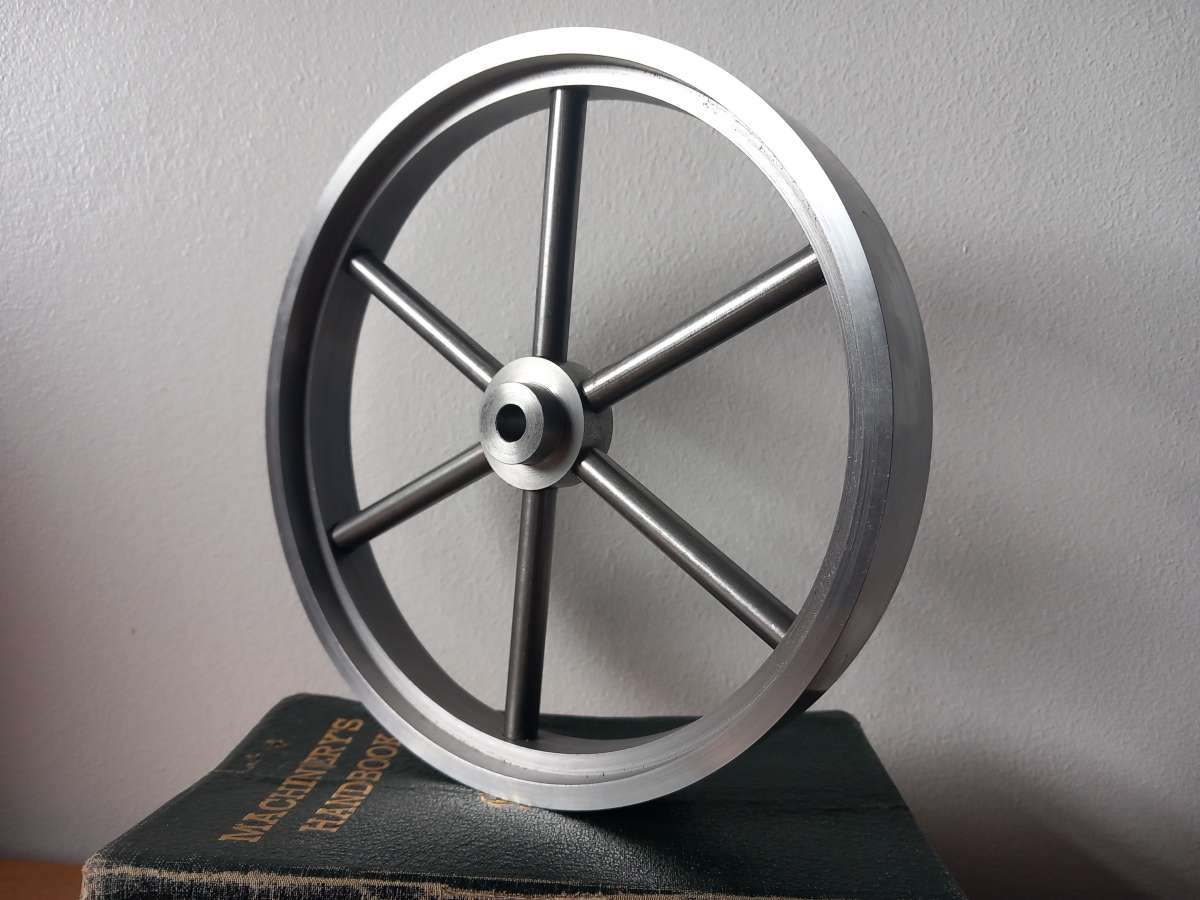

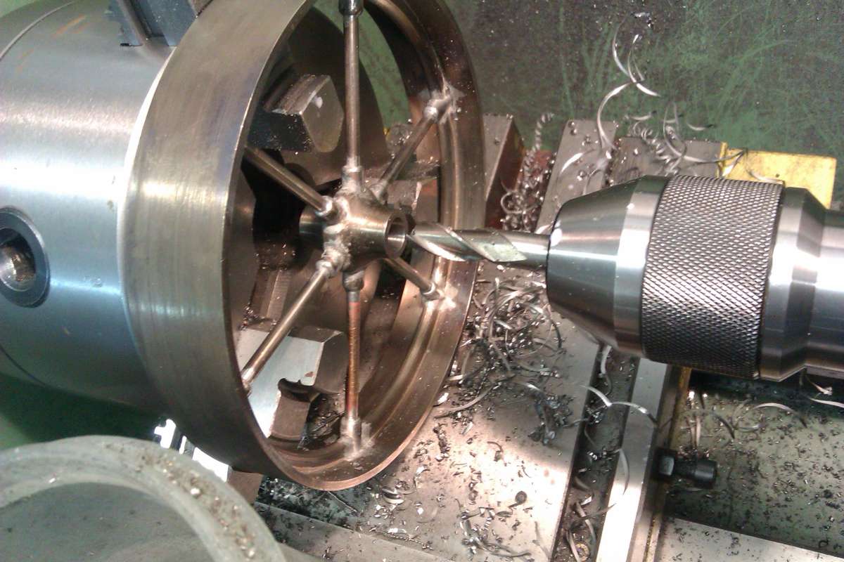

          Soft soldered, 4mm spokes threaded into hubs 150mm dia, finishing the hub bore but boring bar would be better

            1. I finish turned the rim but left the hub blank, loctite it all together, then gripped the hub in the 4 jaw setting the rim true and bored the hub. I’ll see if I can find some photos later on.

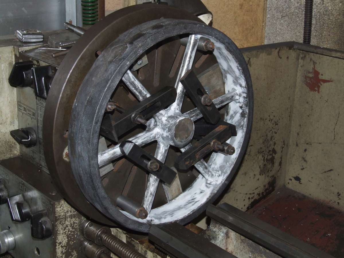

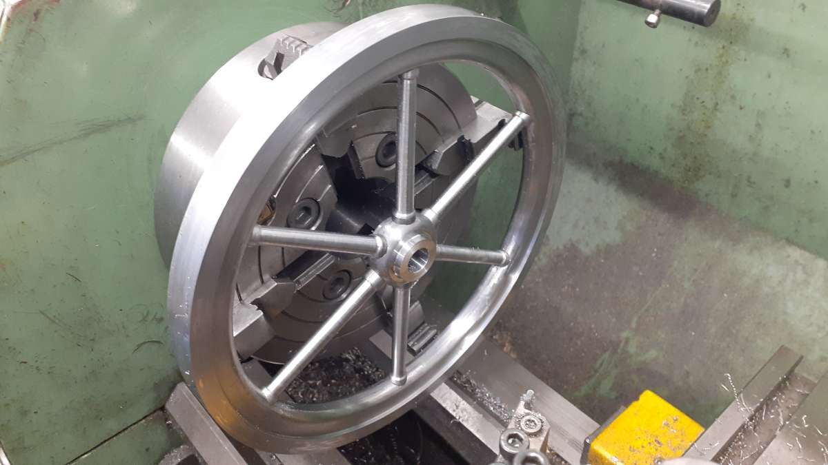

                Assemble everything and then machine the OD, bore and one face in a single setting with the flywheel on a faceplate. Then the other side can be skimmed parallel to the first. It is possible to hold a flywheel for turning all important surfaces at one setting without needing additional holes:
                2013_12280006
                The flywheel is located by the two diametrically opposite steel spigots, which also react the cutting forces. The clamps on the spokes are not particularly tight and are there solely to stop the flywheel falling off the faceplate. The flywheel is resting on three aluminium plates, which are screwed to the faceplate, so that the full width of the rim can be machined. It also makes it simpler to add the doming for a drive belt.
                Andrew

                  If you drill and tap the aluminium pads you can hold them on the faceplate with screws and big washers from the back to facilitate putting all that lot together.
                  I’ve sometimes assembled work-pieces and clamps on faceplates, with the plate standing on its back on the bench.
                  #714977
                  Anonymous
                    The aluminium plates are held on by cheapo M6 crosshead builders screws, as just seen on the top pad.
                    The flywheel was assembled on the faceplate flat, with the faceplate resting on a piece of MDF on the lathe bed. For scale the faceplate is 18″ diameter so the resultant combination was rather heavy. So much so that when lifting the faceplate, together with the second flywheel, I pulled something that paralysed one side of my upper body and arm. It was rather frightening at the time and took an hour or so to go off.

                              As promised, some photos of my humble attempt

                                Thanks for the pictures Duncan, your wheel looks right, could you please let me know some dims, the spoke diameter and the rim diameter so I can check my proportions.

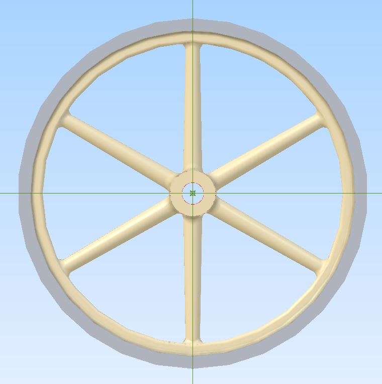

                                  If it is of use the 7″ flywheel found on many of the Stuart engines such as the Beam and Victoria has 3/8″ dia spokes, rim comes in around 3/4″ wide but can be coaxed to 20mm. For your 1/2″ wall pipe make the tee section of the rim 50/50 with 50% full width and the rest the width of the spokes. Your hub material is a bit chunky, 1″ dia would do.
                                  vic fw
                                  Depending on construction method tapering the spokes from say 10mm at the hub to 8 or 9 at the rim will look better than parallel in most cases.

                                    Very helpful, thank you Jason. Yes I can see a 1.5 dia hub looks chunky, I will likely reduce the diameter either side of the centre, maybe the centre part too but I want to get a reasonable engagement with the spoke ends to maximise the strength of the Loctite joints.

                                    duncan webster 1
                                      @duncanwebster1
                                      Andrew
                                      Rim160 OD, 144 ID, 12 thick
                                      Spokes 6mm reduce to 5 where they enter hub
                                      Hub 30 dia 30 thick. Outboard of spokes reduced to 28 dia, it looked better.
                                      I used 5 spokes as I thought it looked better

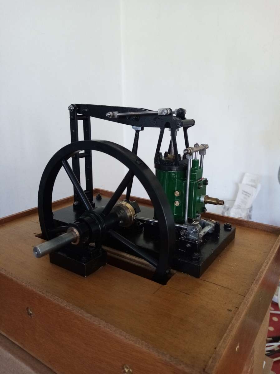

                                        I have just about completed the flywheel and am happy with the result. The spokes are stuck in with Loctite 638, no hint of moving whilst clamping up or machining.
                                        I clamped the assembly to the faceplate via the spokes and managed to machine the OD, rim edge, hub and bore on the same setting which has given a true running wheel. There was a bit of ringing when cutting the OD which resulted in a small amount herringbone like pattern but that has just about gone after some polishing.
                                        Contemplating a key, grub screw or dab of Loctite for the shaft fixing
                                        flywheel
                                        Now to build something to turn it !
