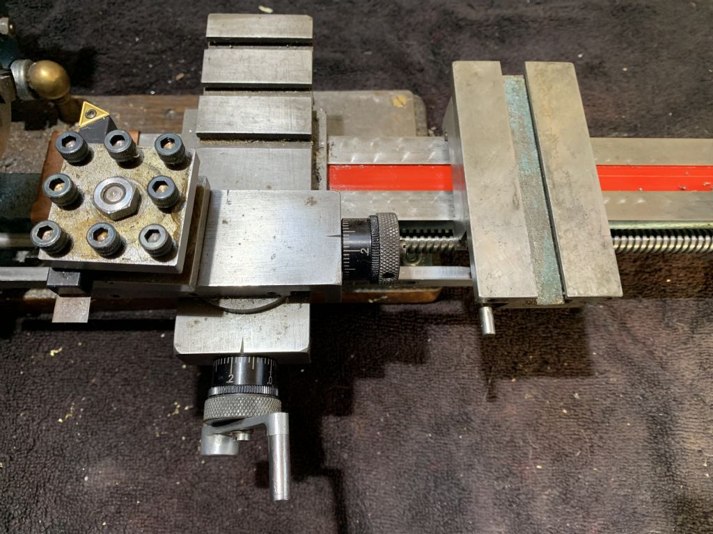

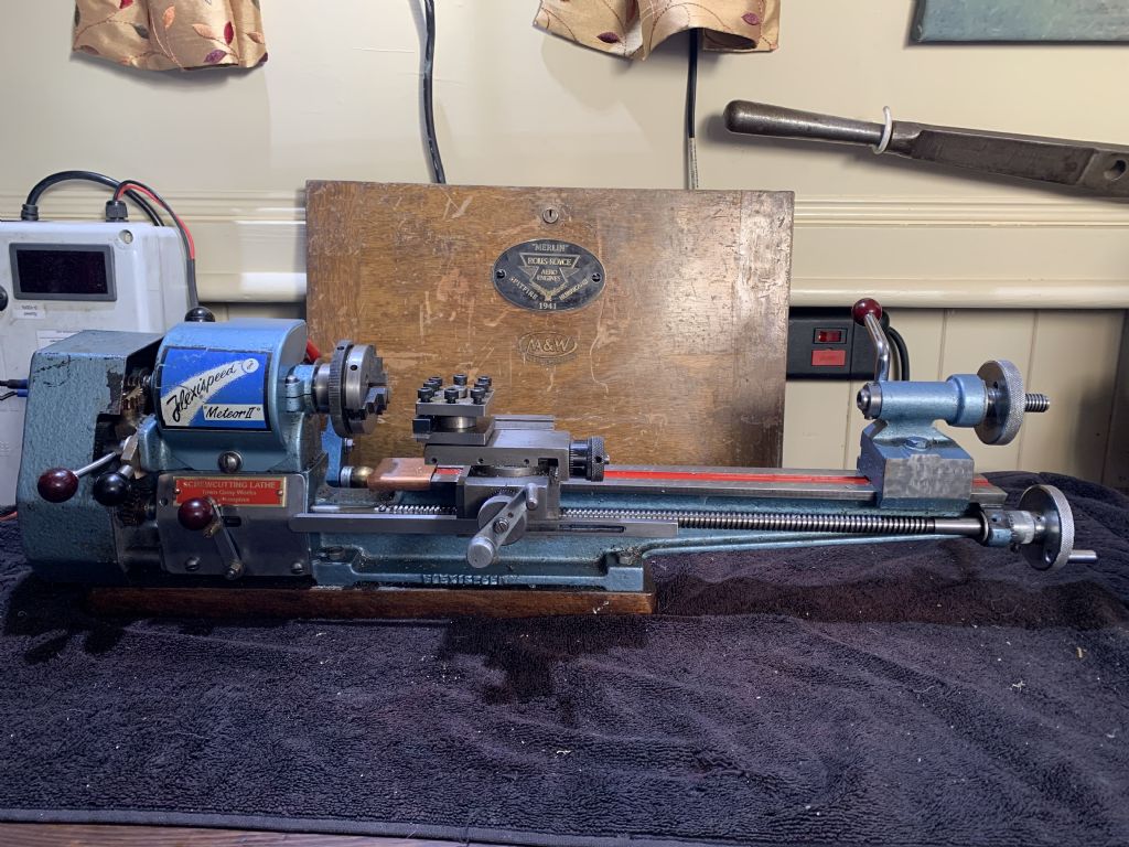

      I have replaced the original saddle etc on my Flexispeed lathe with a Perris/Cowell saddle and cross slide. It is considerable more rigid and cuts without judder and the increased cross travel is very useful for milling. Has anyone else been down this path?

                  This shows the automatic carriage stop which acts directly on the clutch lever.

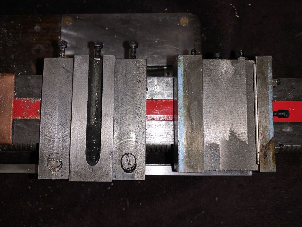

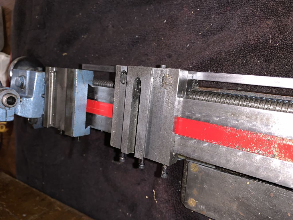

                  This view from above shows the Cowell type saddle to the left and the original Flexispeed saddle to the right.

                    So is the Cowells crossslide thicker?

                          bbfdd53f-2064-4bf7-be5c-39282168854e.jpeg816aee10-e352-484c-b210-7e71428535b9.jpegFor some reason it is now working.
                          The Flexispeed saddle is thicker than the Cowell saddle.
                          But the Cowell saddle is longer in the direction of the lathe bed resulting in a greater area of contact with the lathe bed and slides. The increase in rigidity is very noticeable.

                            Thanks for persevering with the photos Geoff. The slide dovetails are sort of inverse between the two designs.
