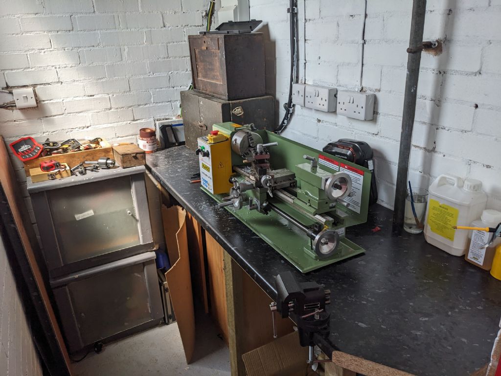

                    As promised an update on the workshop. The cabinets that were in there before are now back in. The big pine cabinet tucked under at the back is sadly of no use to my workshop but has the important job of storing duck food. The 2 grey cabinets had a bit of junk in that I've cleared out and is now full of my tools and other bits, there's a little extra room in there still. I'm yet to put cupboards under the bench but so far I've managed to find homes for everything, so I'll expand as I need to. My thoughts were that a bench drill might fit next to the tail stock, it could make for some workshop gymnastics to get the tail stock on and off but I think I could live with that in return for more precise holes than I can do with my hand drill and baby vice. The vice can swivel, which I thought was a handy feature in a tight space and so far it's served me well. I have the left over work top and I think with some jiggery pokery I could mount it on some collapsible legs and that would allow me an extra bit of pop up worktop in the garden on a nice day.

                      As for milling…… looking at your latest image, I would say you have space on those cabinets by your window for a worktop milling machine…..
                      I found some dimensions of a generic milling machine… Overall dimensions of machine: 670 x 550 x860mm
                      The footprint of one of these machines is fairly comparable to that of a drill press.
                      I am most certainly not suggesting you buy this exact mill but it is the reference I have used for the dimensions above…. You should try and template the footprint out with some masking tape.
                      Amadeal Milling Machine
                      But you're making good progress and learning important lessons by the sounds of things.

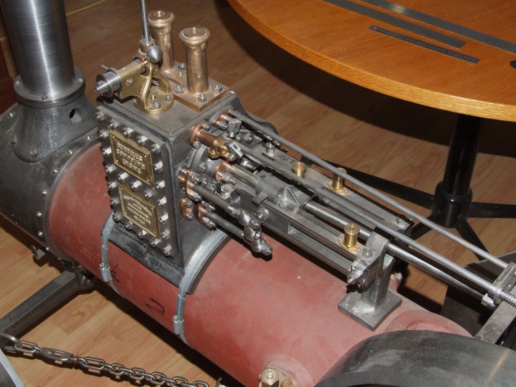

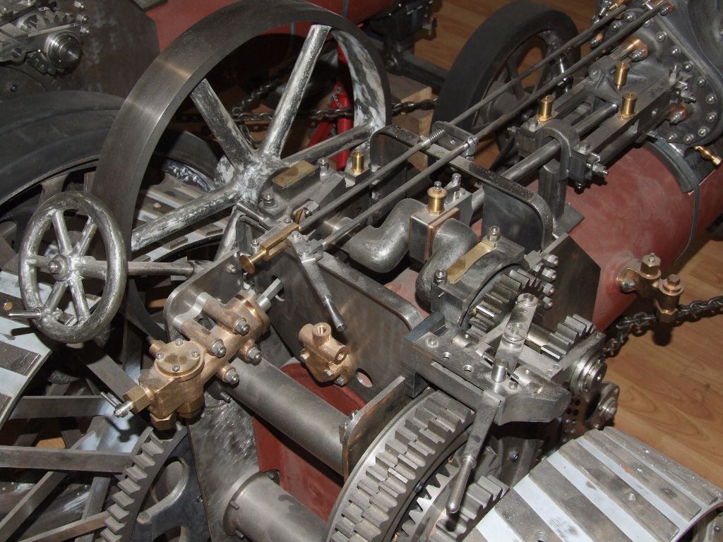

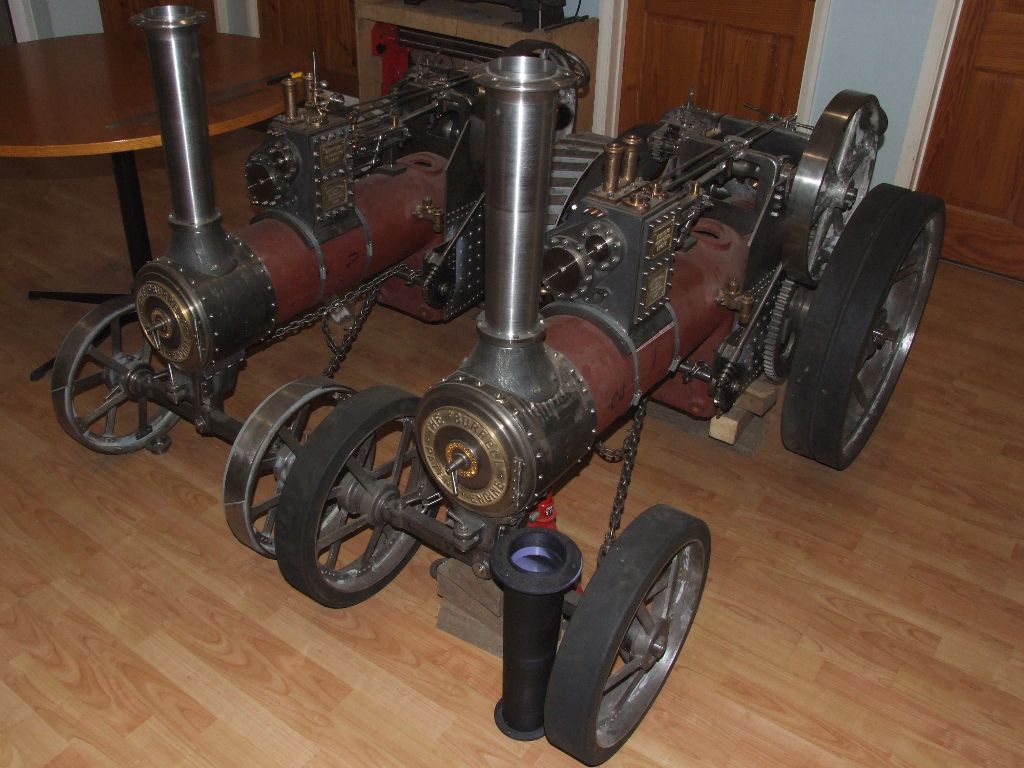

                                              It's just as well I don't regard myself as a model engineer then. Although I am building two 4" scale traction engines:
                                              The motion work and internals of the cylinder are largely to my own design, based on the full size engines:
                                              Likewise the gears, regulator, simpling valve and water pump:
                                              i have made almost everything on the engines, including most of the nuts, bolts and studs, and the chains and all gears, the main exceptions being the steel boilers and rubber tyres. The 6ft long parts were the rear wheel rims before rolling and welding.
                                              As for scrap I used to keep metals seperate. The local council tip used to have a big skip for metal, plus smaller ones for aluminium and copper alloys, but no longer. Some years ago when i had a lot of swarf (70kg of cast iron and 5kg of copper alloy) i took it to a scrap yard. I got about £40 but when you consider it was a 60 mile round trip and took several hours it made no economic sense. Now that I am not machining for work (which was mostly aluminium) everything goes in one box and gets taken to the council tip two or three times a year. Apart from anything else the seperate boxes/bags took up a lot ot floor space.
                                              Andrew

                                                  Andrew they look great, I'd love to work on stuff that big but I think they have a larger footprint than my whole workshop! Part of the point of kitting out my shop was to move my work out of the lounge as it was starting to get messier (my better half was unimpressed to find me soldering on the dining room table)

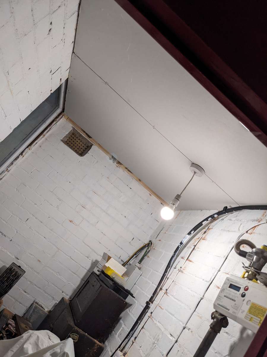

                                                      In preparation for winter I spent the day insulating the roof in my workshop. A few inches left to go but I’ll do that tomorrow and clean up. Hopefully it will stay a little warmer in there now. I’ve got some foam interlocking tiles for the floor as I found my knees were sore after standing on concrete for hours!
