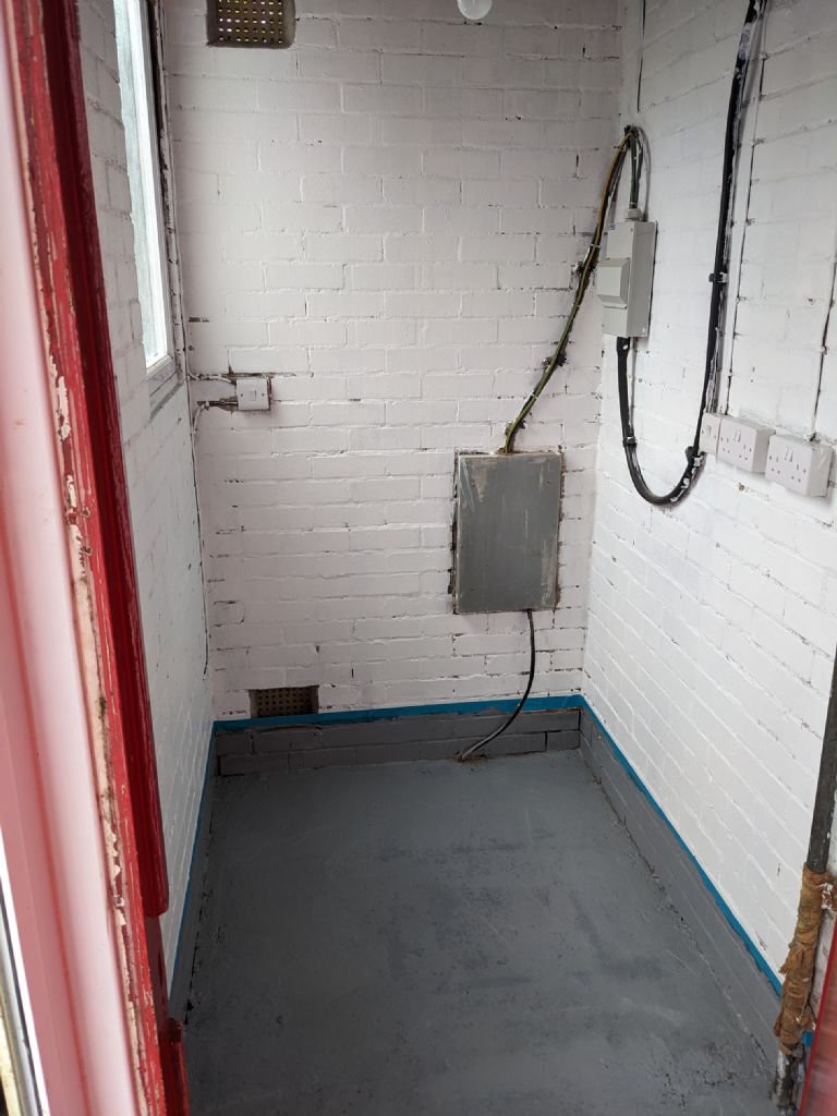

      Howard Lewis
        @howardlewis46836
        Sturdy metal mesh across the window is a good sceurity measure.
        But do allow dor ventilation.
        Temperature changes will produce condensation, nand while you are in there, you will be exhalimg water vapour.
        Ideally you need a small low level vent to let out bthe water vapour, with a high level vent to allow dier air to replace it. In this way, you will reduce the risk of rusting.
        In frosty conditions, in a workshop 3 metres by 2 ,mentres, a 60 or 80 watt tubular heater keeps things above the dewpoint.
        Both vents should be weather ans insect proof. (My upper vent has an external hood to exclude the rain )
        HTH
        Howard

              The two airbicks are well placed to provide ventilation.
              Yes a hood over the outside should stop rain blowing in. Mine is sheet metal, sloping to help water run off.
              A fine mesh should exclude insects. Repurpose some of SWMBO's tights? Air can pass but not the creepy crawlies.
              If the walls are single brick, it might be worth loning them with p[olystyrene tiles, to minimise the risk of condemsation, without losing much space..
              In low ambient temperatures, a small space, a 60 or 80 watt tubular heater will make its presence felt within 24 hours. You just need to keep the btemperature above the dew point.
              Howard

                    Not keen on heat as an answer to damp problems, especially if it's an On/Off type. A tube heater that keeps the metalwork above the dew point is OK, but expensive to run.
                    Condensation is the enemy. I suggest:
                    • doing everything possible to stop water getting into the room
                    • ventilating to get damp air out (that air-brick should be sufficient)
                    • drying the air with a dehumidifier. Unlike a heater, which promotes condensation by moving moist air over cold metal, a dehumidifer collects the water so it can be thrown away. Dry air can't cause condensation. The electric bill should be smaller too!
                    • insulate the building, keep the machine oily, cover then with a blanket, and keep hand tools boxed, ideally with some vapour paper.
                    May not be too bad – cool sheltered workshops are less trouble than those that get hot and cold due to weather. Sheds are generally worse than outhouses, but much depends on position and insulation.

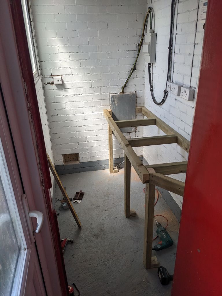

                                The frame is in. We've hung it back 50mm from the front edge of the worktop to allow for clamps etcpxl_20230520_123027397.jpg

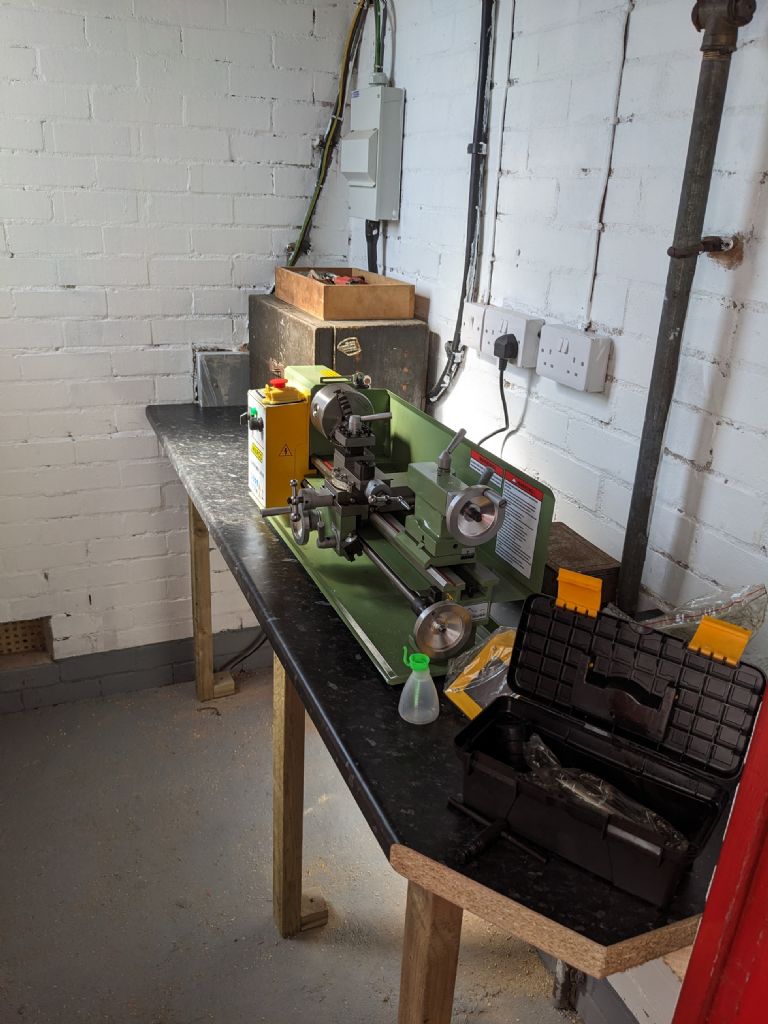

                                  We're in! Bit of tidying up to do but the lathe is bolted down

                                          Good solid bench there, and first machine in pride of place. laugh

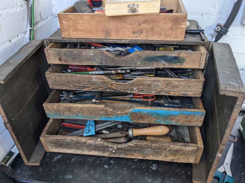

                                            Looking good, the only question is "what is the box at the end of the bench will it ever need to be accessed if so what allowance have you made if it does need it"

                                              Dalboy, it's my grandads old toolbox. Filled with lots of old bits, all imperial (where applicable) which will be helpful for me. He's had it since he passed about 20 years ago and has been looking for a new home for it. Everything (other than the lathe) is in a temporary spot for now. I want to start doing some work then plan my layout so the tools I need are where I expect them to be (if that makes sense)

                                                Not the toolbox but the grey box attached to the wall with wires coming from it

                                                  That's the rear side of the electric meter box. Opened from the outside so no problem there. I'm planning on boxing it off properly with some MDF just the be doubly sure that it's not damaged by flying and spinning things. The main gas pipe to the house also inconveniently runs up the wall of my workshop so that too will get boxed off and all hot work (brazing, silver soldering, tempering etc) will probably get done in the garden.

                                                    No problem it was just a thought as things can easily be overlooked. Yes boxing it in is a good idea
