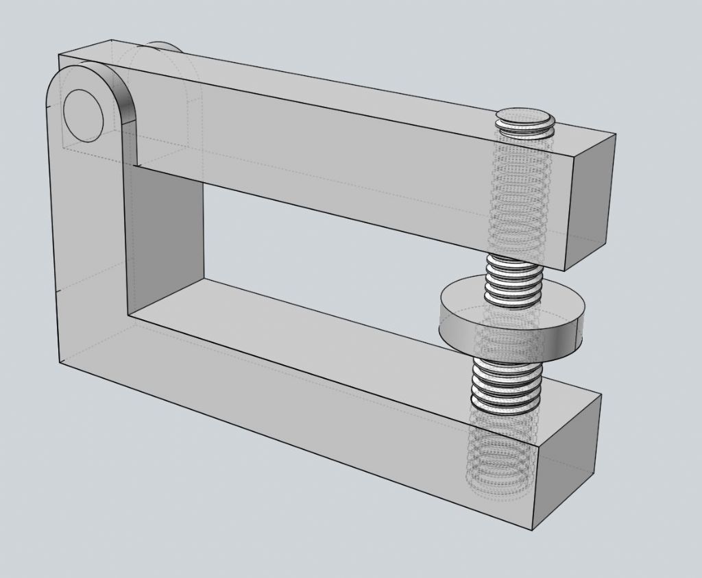

      Dear All,
      I wish to be able to level a plate or bar relative to gravity via a very fine adjustment with near-micrometer sensitivity. Only one axis (vertical, i.e. on one side of a bar or plate relative to another) is particularly important, and only a small range of adjustment would be necessary (a few degrees).
      The leveling adjustment needs to be done to say a thousandth of an inch. A micrometer head or a very fine-pitch screw could be used. For example, I can obtain stainless-steel ball-pointed 80 or 100 threads per inch set-screws and associated brass threaded inserts that look appropriate for the task.
      My question is how to arrange things to maintain rigidity. Lateral as well as vertical rigidity is needed. I can't get away with simply setting and adjusting the screw(s) on some surface as one might do with a tripod. I've thought about adding hold-down force via spring tension or pressure, but I'm not sure that would be good enough.
      The easiest (and crudest) way I can think of is using a fine-pitched threaded rod or screw (seems 32-48 tpi is the maximum) with two nuts to capture the floating element that needs leveling. The other end can can be similarly captured, but is just slightly loosened during adjustment, as it mainly acts as a hinge. This is how my bubble-level is adjusted, so perhaps it's OK? But it still feels unsatisfactory compared to just turning a micrometer head or equivalent.
      Is there a better way of doing this?

                  To be clear, I meant a screw which has different threads at each end, one screws into one part while the other screws out of the other. So if the pitches were 1mm at one end and 0.9mm at the other, 1 turn would move the parts relatively by 0.1mm. I've seen these use a lot on (electron) microscopes. The trick could be to find two standard pitches that are very close, quite possibly one metric and the other imperial so their pitch difference is very small.

                          I think you need the same thread handedness at each end? You rotate the screw, it moves into one part and out of the other but different amounts.

                            Yes, I did understand: Using two slightly different same-handed threads would amount to a vernier-type adjustment mechanism.
                            Now I'm also thinking of a combination: A fine set-screw (e.g. the 100 tpi one) to set the distance, and an opposite-handed differential screw to lock the two surfaces together (the base and the pivoting part).

                              The MK3 Quorn uses differential threads for the rocking arm adjustment by having a thread within a thread arrangement. A threaded adjuster fits in a threaded hole and has a knurled collar to turn it. Another threaded rod passes through the centre of the adjuster but with a slightly smaller TPI. If the central threaded rod is constrained and the hollow adjuster turned then if it is screwed in the central rod will be screwed out the movement being the difference of the pitches. All threads are right handed.
                              So if the central thread was constrained in a lower plate and the hollow adjuster threaded into an upper plate the separation could be adjusted to a fine degree. 3 such adjusters would give you what you require.
                              Alternatively you could just purchase a theodolite tri bracket, a device that has been doing the job for years.

                                  1/20 – 1/28 is 1/70, how fine can you want it.

                                    With an M4 (0.7) thread at the top and an M5 (0.8) thread at the bottom, each full turn of the thumbwheel would lift or lower the top bar 0.1mm 0.004". So one quarter turn would give you the 0.001" adjustment

                                      Thank you. Yes, I could use a micrometer head instead of the ball-tipped fine set screw. And in combination with a spring-loaded bolt, the net result should be easier to use than messing with two counter-acting screws.
                                      At the pivot end, I think a single rod sitting in book-matched V's should do, no? I suppose a spring-loaded bolt at that end would help, too.

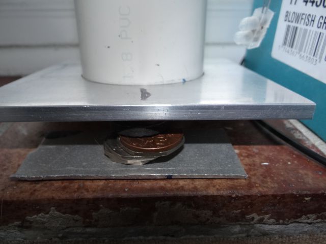

                                              The closest analogue I know of is the old-fashioned Chemical Balance of the beam type, in which the fulcrum is an Agate edge. My school had four, studied briefly because the history of accurate weighing is important in chemistry, but we weren't taught how to use them in anger – chemical technique had moved on. Agate is harder than steel, and I don't know what the edge rested on – maybe a 'V' in another hard gemstone. Each scale lived in a front-opening glass case, I think levelled by four ordinary screw feet; my memory could be faulty!
                                              I don't think chemical balance construction helps SK much because the scale's fulcrum edge was only put in contact with a lever whilst actually weighing. Most of the time it was lifted off. As there are over 30,000,000 seconds in a year, I don't know how long a sharp edge would last swinging a heavy pendulum bob.
                                              On the subject of levelling, the support can be pretty crude as long as it's "good enough". A mechanically sophisticated way of levelling my clock has been on the TO DO list forever, but this is how it's done at the moment:
                                              Though this abomination is levelled within the accuracy of a Wixey, about 0.2 °, balancing a pendulum clock on a stack of coins isn't Horological best practice! I only get away with it because my bob is tiny and swings well below the clock's centre-of-gravity, close to the base.

                                                Dave, not familiar with those coins but judging from the copper, that must be the budget model leveller?
