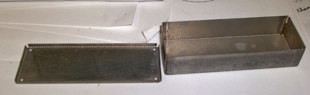

                  Here is a picture of an etched brass box we used to make at the old salt mine about 20 years ago. It is 0.25mm brass shim stock and was made as a 4:1 enlarged version. The artwork used sprocket tape from an old pre-CNC tool and the perforated holes meant it always folded correctly along the dotted line. We made dozens of different screening boxes and other parts in house as we had our own PCB plant and could make double-sided boards very cheaply.
                  The secret is to etch from both sides at the same time, so you need a double etch resist pattern screened on the sheet. Without this the holes have a distinct taper and need attention with a fine file. The tricky part is to get the two etch resist screens lined up, but we did this all the time and the jigs catered for this operation.
                  The box has been kicking around in my junk box for almost 20 years so the nickel plating is a bit scruffy now.
                  By making the artwork 4-times bigger we could reduce the size in incremental steps, this box is a 1/4-scale version of the full size one. It measures 3" x 1". Our LittleJohn plate camera could enlarge or reduce in 0.1% increments, so making different sizes was easy, one artwork did for all of the boxes..
