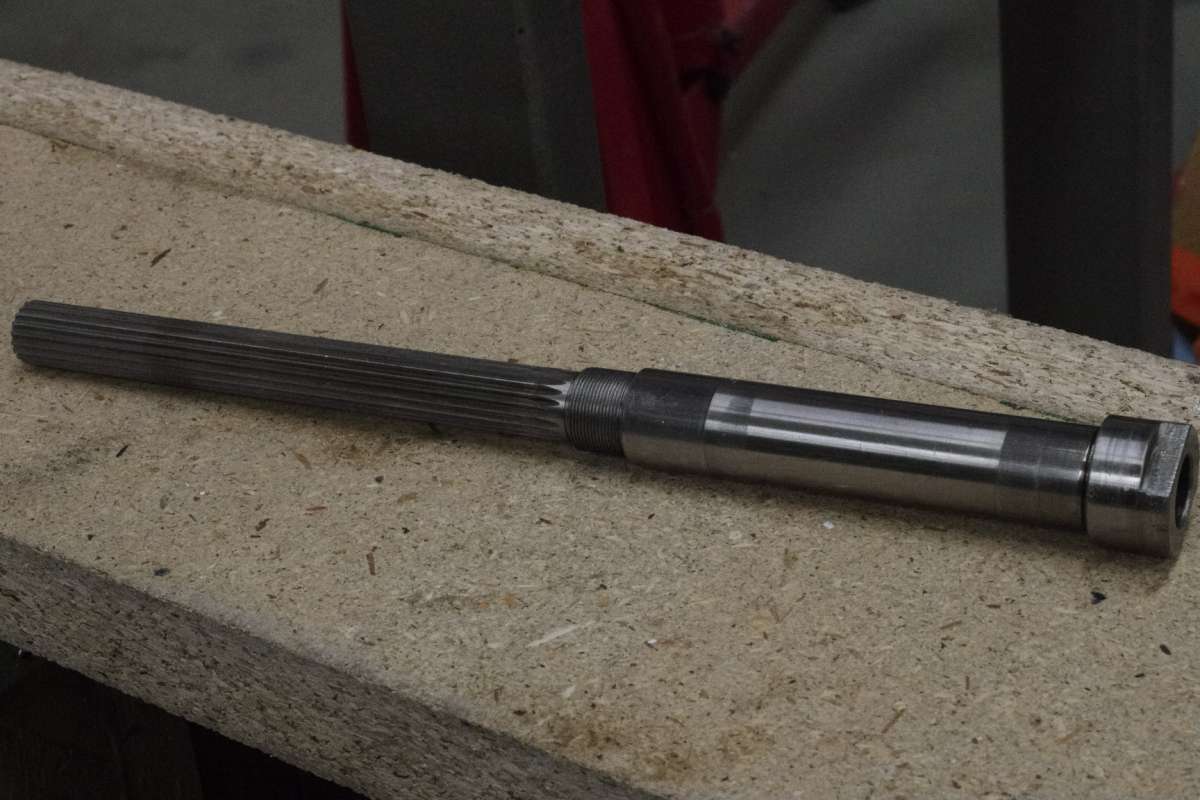

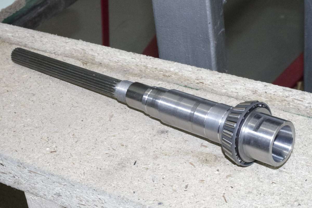

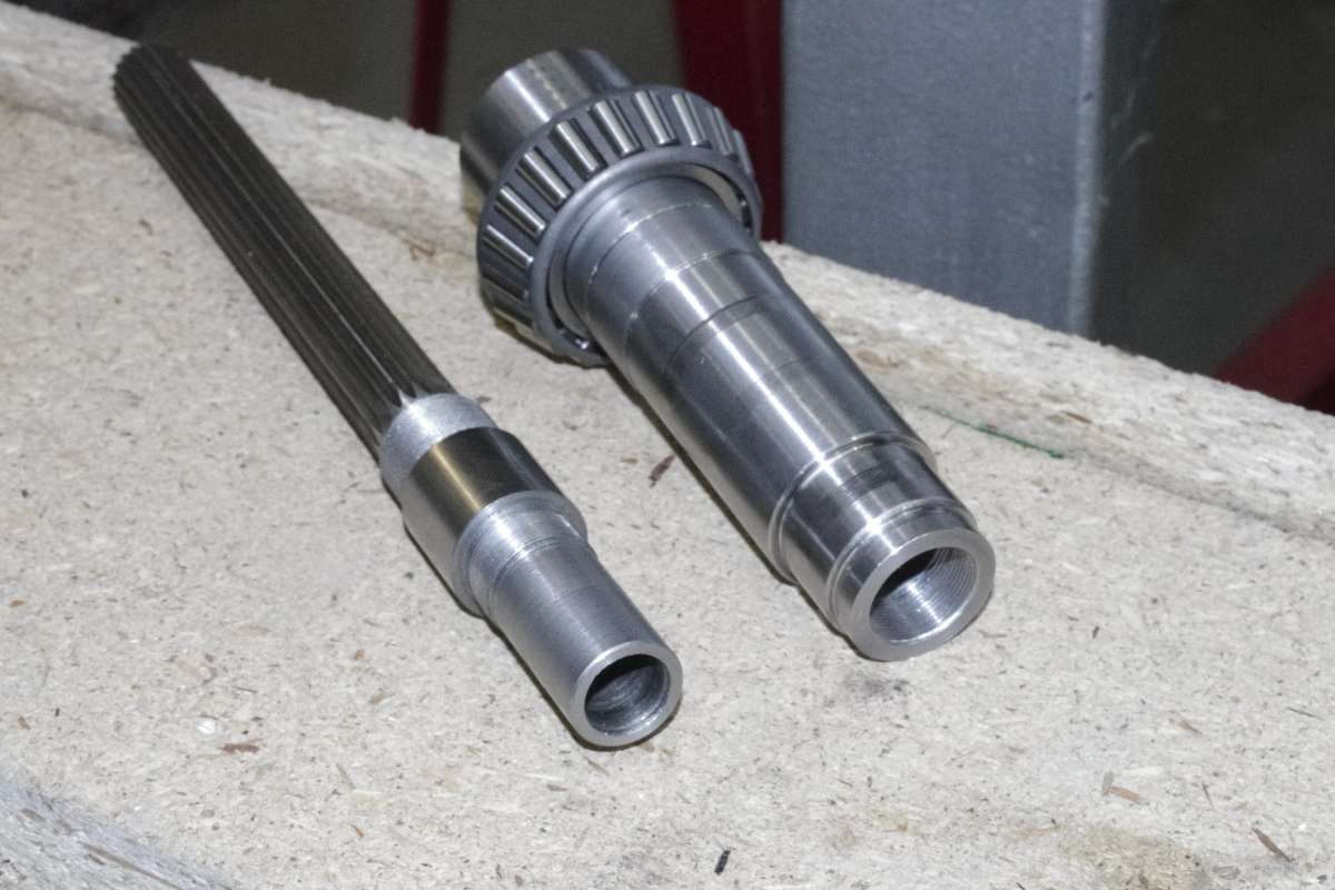

                              _IGP2428I had a problem even greater when I converted the Tom Senior light vertical from MT2 with a 3/8W drawbar to R8 which usesa 7/16 UNF drawbar. I wished to keep the top section and marry it up to a new R8 bottom from ARC. The top half was splined for the sliding drive. I managed to get a hand reamer with its longer lead in to start and when it reached its full length from both ends, silver soldered on an extension to reach the middle. The hole in the bottom part was already the correct size.
                              _IGP2435_IGP2434

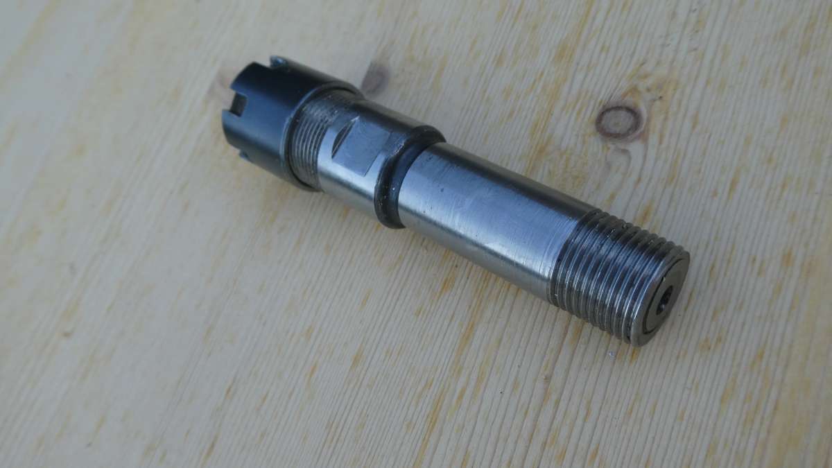

                                You can buy a parallel shank ER25 collet holder, cut to length, plug the end if required (I tapped it and screwed in a bit off a bolt with Loctite), centre drill it and thread the outside diameter to fit in an AutoLock chuck. This is a 16mm shank ER16
                                P1010282
