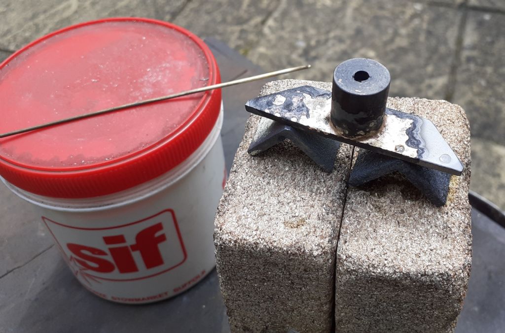

                              As I said earlier and Bill has also said it it not so much the temperature as the heat output in watts or more likely Kw that matters. The 404 is only rated at 4.76Kw but the standard size 28mm Sievert burner is rated at 7.7kw. So although the 404 will melt the rod for smaller jobs on thinner material it will be found lacking if your fabrications are a bit larger so you may end up having to buy a second torch if they do which cancels out any cost savings.
                              Just stuck a couple of bits of scrap together, 2.5mm plate offcut and 16mm dia bar end, Sif flux and unknown brazing rod
                              I'll post a closer shot when it is out of the pickle – the higher temp does need a bit more clean up than silver soldered joints.
                              Where the smaller flame size of oxy is useful is when you want to form a large fillet as it gives you more control of the alloy as you build up the fillet and you are less likely to get a big blob of molten brass on your boots, also makes it easier to get in close with the rod as the heat bounceback from larger burners can be an issue but I suspect fillet brazing is not such a requierment for model work as it would be for bike frame building

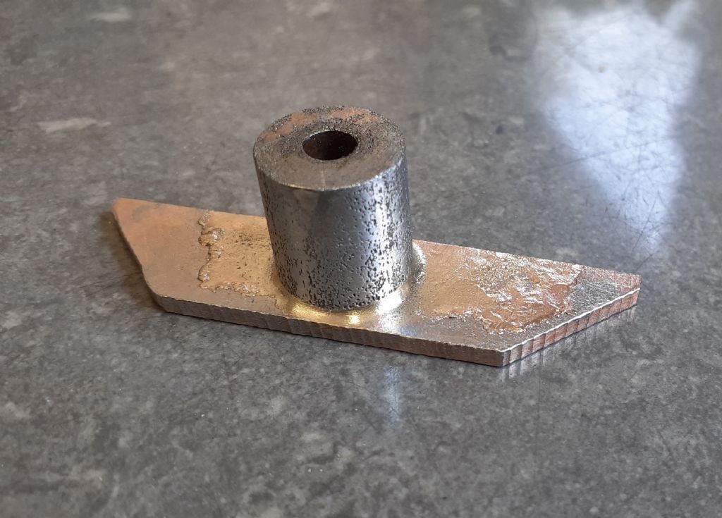

                                  Here it is cleaned up, quite a nice fillet which this type of rod tends to leave, flowed out more onto the flat material as that got hotter first despite trying to get the heat aimed at the round stock.
                                  Looks like the higher temps affected the round stock which may well have been leaded steel which has now got quite a pitted surface, the flat is unaffected. So that is another thing to think about when choosing how you are going to join parts, some are better suited to a particular method than others.
                                  Clean up is another consideration on small fabricated parts for models, I find the fillet left by silver soldering and even one like above do not really need any further work and if they do it's quite soft metal so easy to file or use a dremel on, welding (at least my efforts) need a lot more clean up and you can't weld leaded steel that I will often include in a fabrication.
                                  Edited By JasonB on 05/06/2023 14:22:40

                                                      The upper caps were also silver soldered fabrications (M4 screws for an idea of scale)
                                                      I don't think I soft soldered anything on this one but a few cosmetic bosses etc were bonded on with JB Weld and finally there is some body filler particularly around the feet that can be seen in the first photo.
