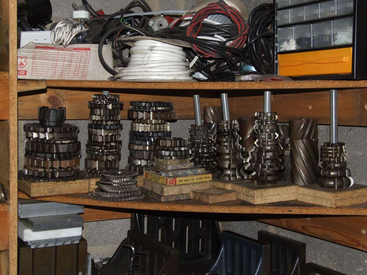

          Photo 7 - HSS Milling Cutters
          To summarise, buy a few metric cutters as standard; 3, 4, 6 and 10mm diameter covers most needs. Then buy other cutters, metric and imperial, as needed and new or secondhand based on need, availability and cost analysis.
