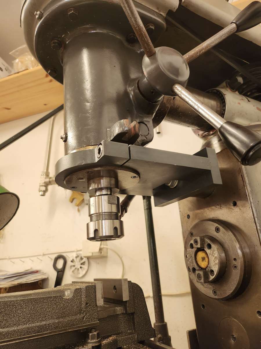

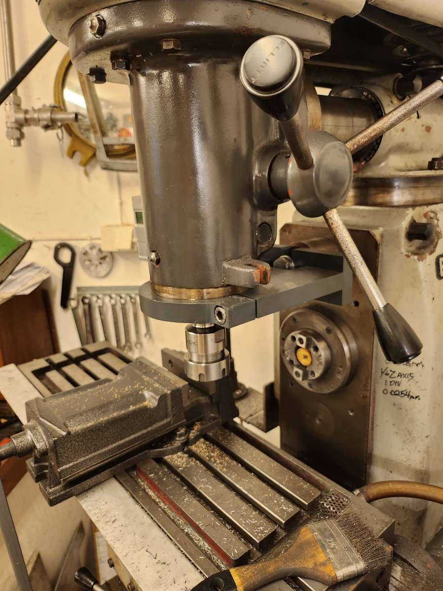

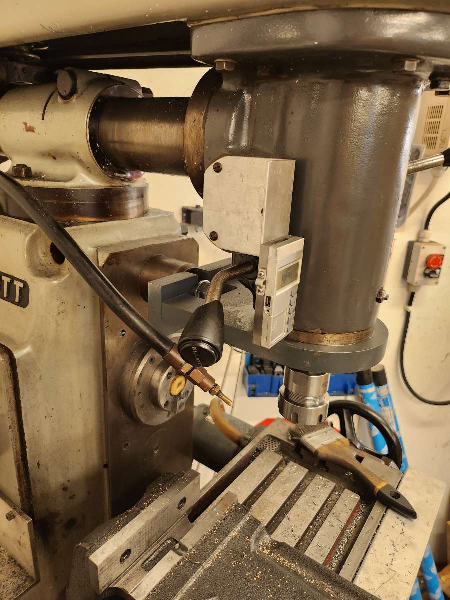

      Nigel McBurney was kind enough to send me some photos of the modification plate that he added to his Omnimill 00 to improve the rigidity of the vertical head. I have added this (in my own way but based on his photos) and can attest that the mill can now take deeper cuts and the cutting is chatter free. I can even climb cut where i could not do that previously.
      This plate ties the bottom of the vertical head spindle housing to the horizontal milling bar
      Thank you Nigel!

      #702451
      Steviegtr
        @steviegtr
        Always nice to see mods that work out well.
        Steve.

          Interesting that this has only just come to light after 50 years or so the mill has been around. I wonder if a version using the vertical Vs xan be applied to the likes of  the VMC?
          I take it that is not a transistor radio attached to the left of the quill.
          #702498
            A very nice demonstration of the fact that even a substantial machine is far from rigid.
            Respect to both Nigel and Wade.

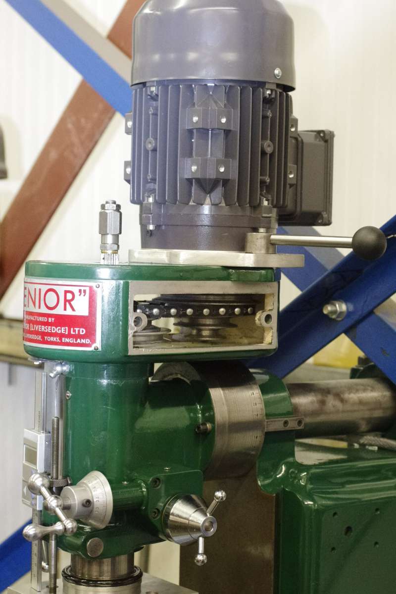

                  _IGP2444I did have a look at the museum’s Tom Senior light vertical the other day and it would not be easy to add a brace, there is no place for one to be attached. The spindle is not too far below the horizontal bar which is solid 4″ diameter steel, so I am not going to worry about it.
                    I must say old mart that i have never had any issues with the vertical light & i only have the MT2. You have the R8. I guess it is what it is . A light milling machine.
                    Steve.

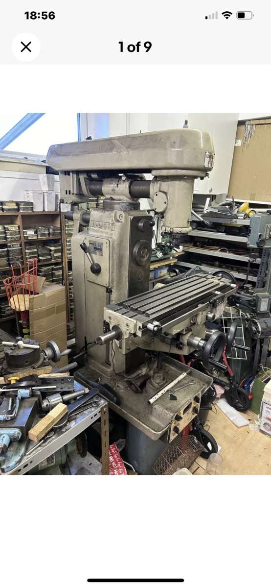

                      253FAA9A-7354-4A7E-926D-3FEDD5A60393B2607D3B-8518-4C6E-84D0-2D863D20239EC51F581D-CB03-4815-9672-4A126CCAE96A243F9A39-FEAF-4B05-9EAF-34E66293A9BAE0776983-133A-4B88-A029-1B29077ED664AFBC2873-60B9-4291-BDF5-F85FA26F8474Hello everybody, we recently acquired an Elliott Omnimill, during our haste to clean and reassemble, we inadvertently greased every point with car type grease. Can anyone please shed light on the recommended next course of action, should we be dismantling, cleaning out all grease and re-oil correctly or can we just pump in oil and hope for the best ?
                      Thanks,
                      Stefan
                      #736940
                      Bazyle
                        @bazyle
                        I don’t think grease is a problem in slow moving parts. Spindles will experience more drag and possibly overheat. Longer term it will dry out and go thick in the areas exposed to air, but normal oiling in a machine that is being used should clear the ways. Left sitting that drying out might be more significant.
                        #736972
                        Hopper
                          @hopper
                          Agreed. Pump plenty of thin hydraulic oil such as ISO32 through there and it should dissolve/flush out the grease. Grease is still a lubricant, just not the best lubricant so no damage will be done if a bit remains mixed with the oil after flushing.

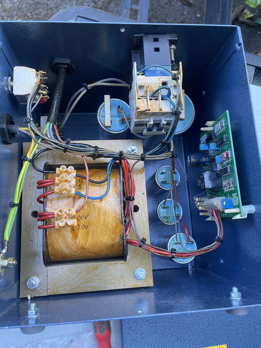

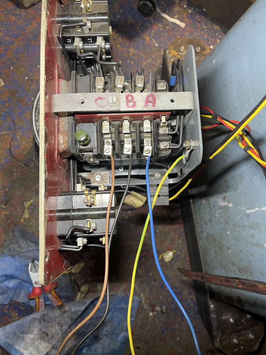

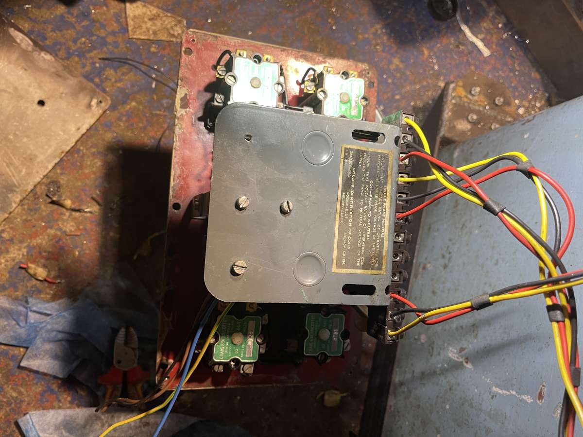

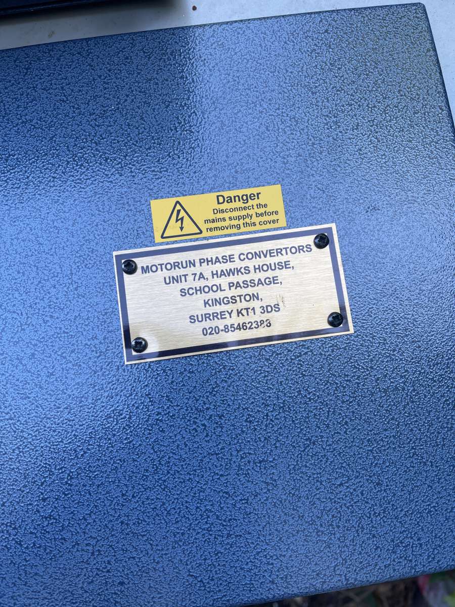

                            Thanks for the reassurance re the over exuberant greasing. I now have some electrical questions if anyone can help please. Just need some guidance as to what to connect to what.
                            5F2424FE-0936-4ED2-AF8E-36846E911144E787164C-5F73-4D05-BCAE-DCBA5C61FEA9953284A5-1ECD-4DCA-97A8-46E24BD056C599A9EAE3-F7C1-460B-B11F-98E092CE52E45251B527-D1AE-49D3-A99C-C07C76AC6190742BC919-C6EA-4C97-ACDC-B2CAEDF55B12
