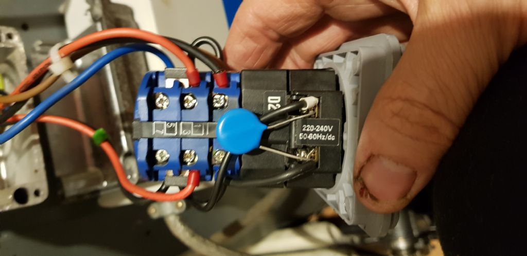

      I purchased a Lathe and it had a problem already whereby the switch was not latching, forward and reverse worked but you had to hold the switch in position, releasing sent it over to stop.. I took the switch apart and the sections of contacts fell out and although I tried to re-construct it I am left with a pot full of bits. I went on the faithful auction site and got a replacement in a week or three. I think I have ordered the wrong one though as the new replacement is a 3 phase and my Lathe is a single phase. Can I use the 3 phase switch or do I need to get another one that will work with single phase? After I get an answer I have a wiring question for you too. I took lots of photos but want to double check everything before connecting it all up.

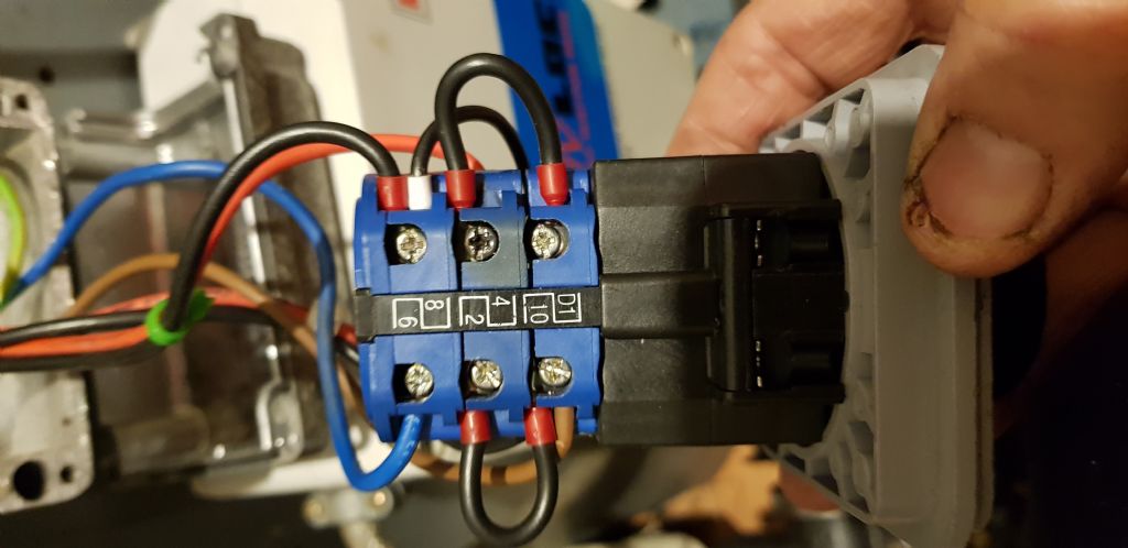

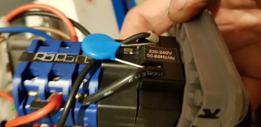

            #409665
            JohnM
              @johnm51917

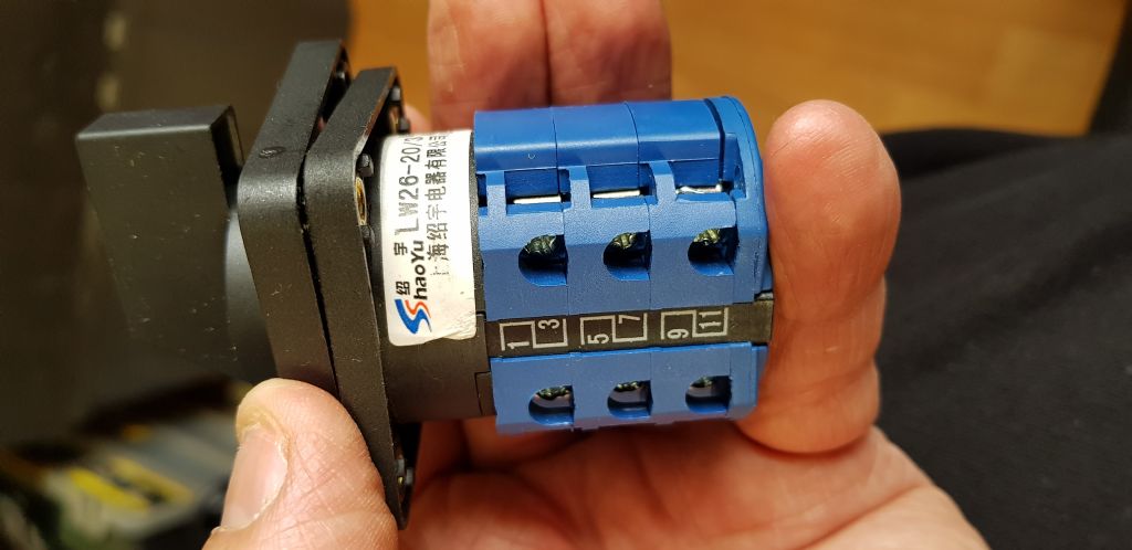

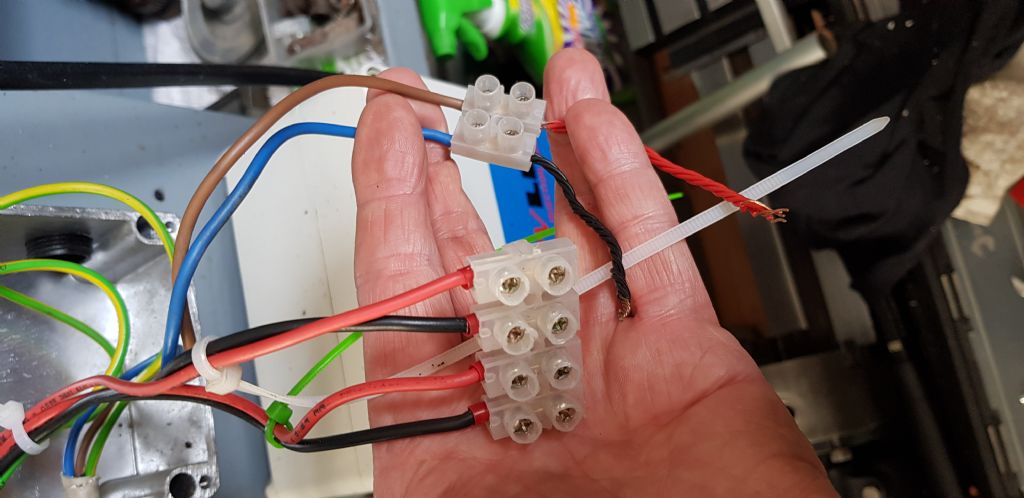

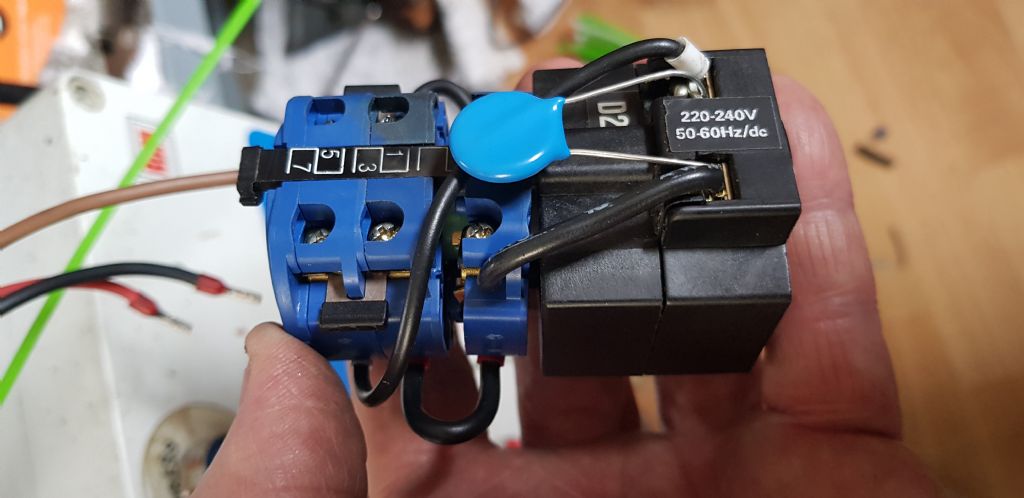

              1st photo shows the wires to the old switch feed wires and pairs of the forward/reverse. I have marked the pairs of wires with two different coloured cable ties.

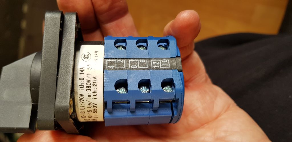

              Second and third show the replacement switch with LW26-20/3 which was sold as a three phase switch.

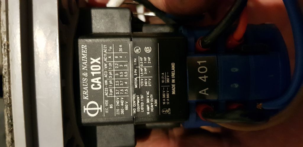

              fourth is the old switch with a capacitor. I have several shots to show all the wiring for this switch but not sure if they are compatible?
              Possibly the /3 refers to three switch positions rather than three phase?
              Thanks

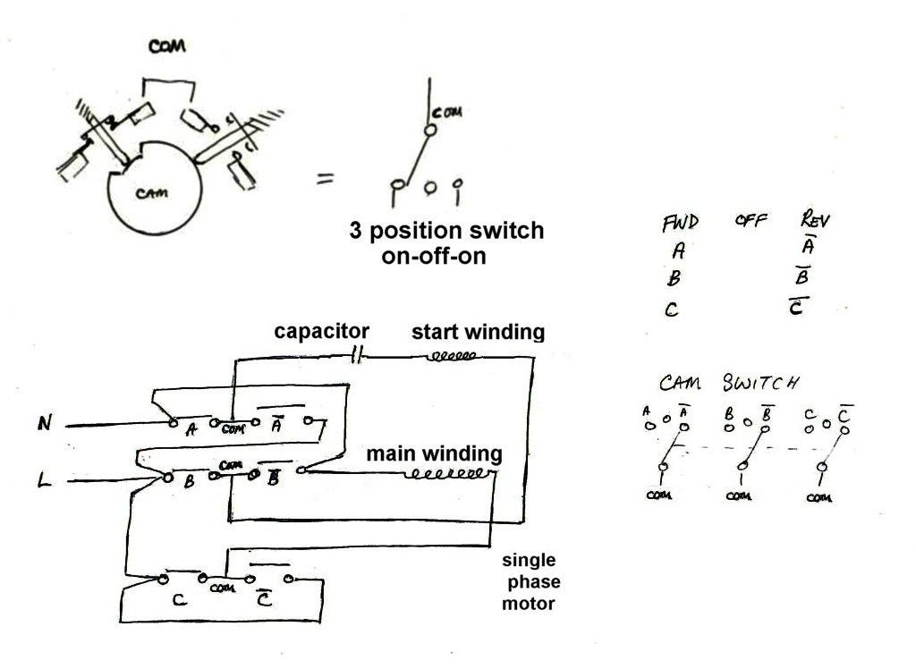

              #409693
              john swift 1
                @johnswift1
                looking at your last photo
                the original switch incorperates a no volt release ( I expect the black part is a 220/240V coil )
                I would of thought the 3 blue cam switch elements may of been wired like this
                #409699
                Robert Atkinson 2
                  @robertatkinson2
                  Hi,
                  The new switch is not suitable as it does not have a no volt release coil. This is a safety feature and it is likely that the emergency stop will not operate without it.
                  Robert G8RPI.

                    Thank you both for your replies. It makes sense as there is an extra part on the top of the original switch. I guess I will be looking for a replacement as the old one does not latch. Is there a chance you could point me to a suitable replacement please? Lathe has been sitting for a month and I'm getting withdrawal symptoms now 😥 Sorry for late reply.

                        Hi John,
                        Did you get it working?
                        I have reassembled that type of switch several times, very fiddly. Have you checked each contact is working when it should with a multimeter?
                        It looks like your switch is by Kraus & Naimer somewhere on the black lump should be a part number.
                        On page 58, Power Failure Release is what you need.
                        I also searched "kraus & naimer distributors uk" lots come up and they have a UK office too.

                            YES Adrian. That's the switch. I really struggle with schematics but I am a trier. Will check out your links thank you. I will find the part number but it could be an older version.

                              Switch is a
                              Kraus & Naimer
                              CA 10X

                                  Be careful if you order one, Kraus & Namer part numbers are complicated as all the switches are modular. The one above would be CA10X-A401 CA10 = 20 A switch, X = Power failure release, A401 = Motor reversing switch.
                                  On page 26 of the tech doc you can see the schematic of the switch and how it should switch in each position. Check over your switch with a multimeter to see if it works the same as that.

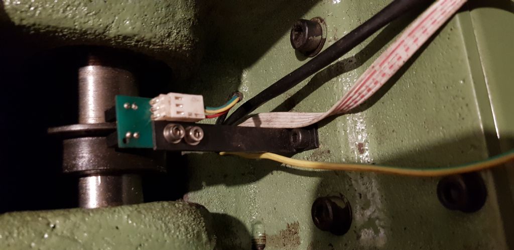

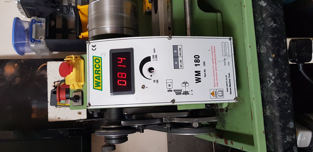

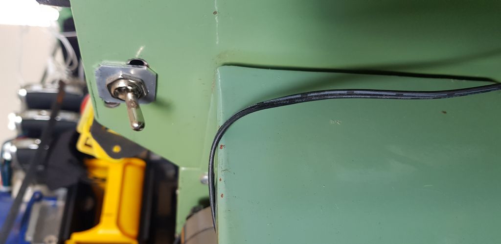

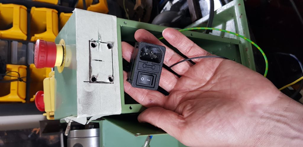

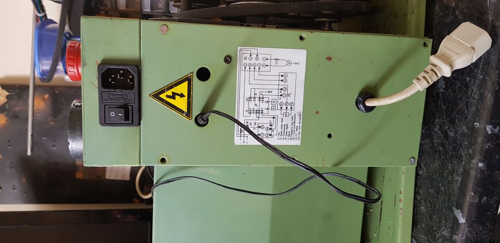

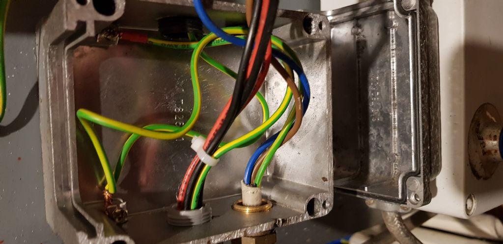

                                                    20190531_131819.jpg20190530_213453.jpgReleased from Hospital on Thursday and straight to work on my Lathe/s. Still no joy with the S7 even after connecting directly to the Motor. On reflection I'm going to check the fuse when I get back home just in case.
                                                    I also have a little Warco 180 It came to me with a few issues and I am sorting them out in between scratching my head getting the Myford S7 to work.
                                                    First the motor and the speed control board were not working although when I connect to my bench power supply it works fine,just not using mains power. and so this meant the previous owner had purchased a pillar drill motor and it's controls to drive the lathe, bypassing the Warco system completely. He has cut out the back of the gear cover to facilitate the external motor and belt.The Warco system has been disconnected but is still all in place so not being one to suffer something that could be made to work better I purchased a tacho from that auction site for under £10 and took out the Warco sensor and wiring loom completely and reinstalled using the replacement pillar drill motor extended wiring loom and made a bracket to hold the new sensor in place.
                                                    I'm left with a system that runs at maximum 170 rpm so i'm thinking after some research I either need a bigger belt and pulley wheel or maybe a treadmill motor that can bully it up to a faster speed. The display and the buttons plus emergency stop are now all wired into the Warco so I don't have to risk life and limb any more reaching over the Lathe to hit the stop button fixed above the motor in an emergency.
                                                    I don't yet have a variable speed system in place so will have to look into that at some point.
                                                    The reverse is not working and I'm not sure if the original forward/stop/reverse switch that came with the Warco originally will work. I seem to have lots of issues with these things so will just settle for forward and stop for now.
                                                    The Warco could possibly be sold on once it's all fixed as I don't have the room for two or even three Lathes this including the ML2/4 which has had no interest as yet.
                                                    Finally had a little play with the Warco though, just little steps at the moment and getting used to making a few cuts and this is a step in the right direction for me.
