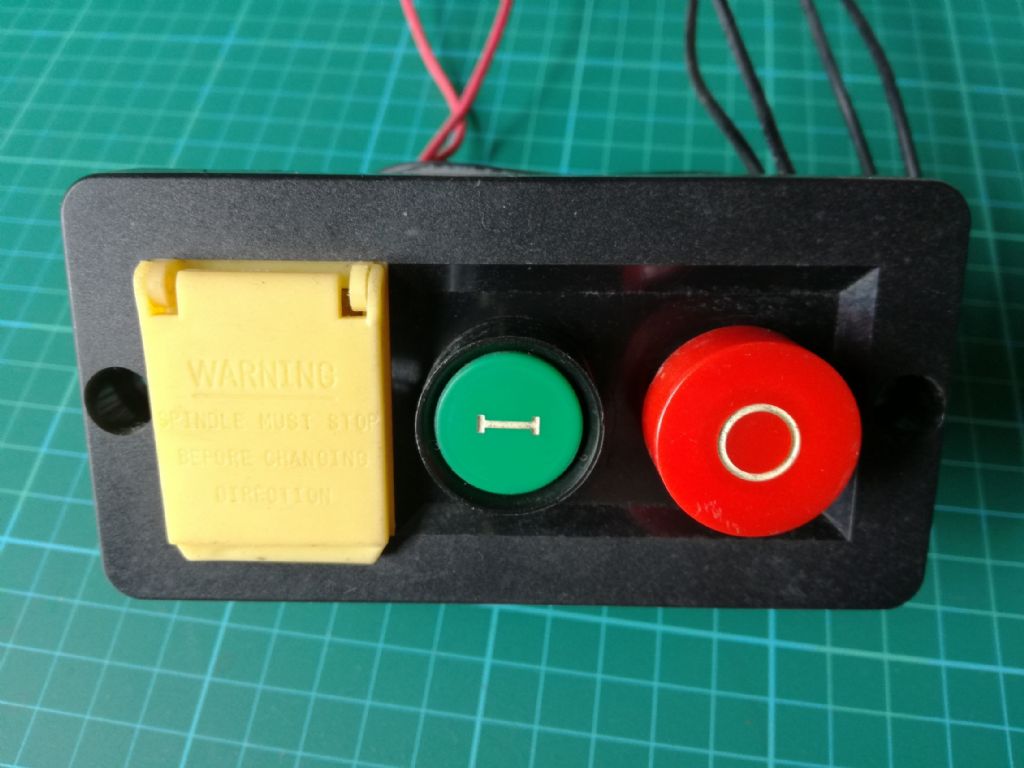

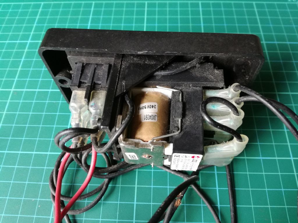

                                            Hi Justin, looks like your start/stop is like this one, which is the type on my Chester Champion mill, and as you say, has mostly black wires.
                                            I had a similar problem a few years ago, and I think it would only go in reverse. If I recall, some how it wasn't latching properly. I managed to take it partially apart and fixed the problem, but I can't remember what is was. I already had this one as a spare, but didn't what to use it if I could fix the other one.
                                            I don't know if Warco do these as spares, if that's what your problem is, however Chester do stock them On/Off NVR Switches though you would have to check if they are wired the same, but I imagine they are. The black mounting is 118 x 61mm and the hole centres are about 107mm
                                            Regards Nick.
