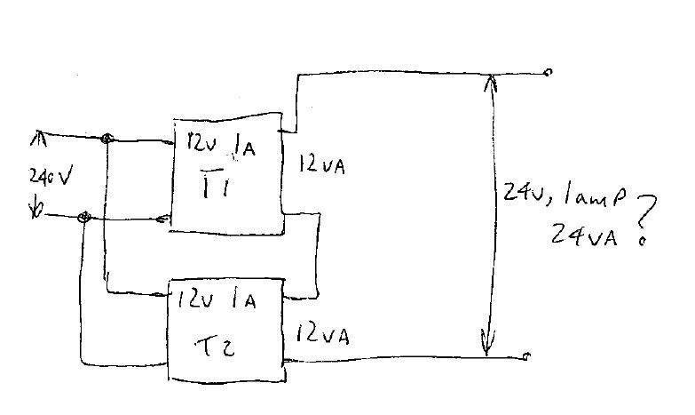

        Hi
        At the risk of showing how dumb I an at electrics, I have a question regarding ratings of transformers connected in series.
        If I have 2 transformers 12v 1amp they are rated 12 x 1 =12 VA?
        If I connect them in series I get 24v. Will the current rating be the same? so I end up with an ac power supply of 24 VA?
        I expect the current rating cannot increase because the wire gauge on the winding can't change.
        Reference the following diagram.
        The reason for my question is that I am looking at Ben Fleming's pulse EDM, he uses 3 off 24v 10 amp transformers in series to get 72v. I was wondering if I could replace these with say a single 75v 750VA transformer, or 2off x 36v 350va transformers? I don't at present know if this approach would be OK, available or cheaper, just an idea.
        Thanks in advance.
        Nigel

        #192380
        frank brown
          @frankbrown22225
          Spot on, you can connect transformers in series, just check that its the right way round or you get 12V -12V =0V. The maximum current will be determined by the lowest current rating of either transformers. The trouble is when trying to connect transformers in parallel as the smallest miss match in their voltages will cause large current to flow in them.
          Frank

            That should be fine. You can series up secondaries like this. Just make sure you don't exceed the max current rating (= temperature) of any of them. And don't parallel secondaries.
            BTW, if you connect one of the secondaries antiphase to the first, you will get something close to zero voltage out of them. In which case, simply swap one of the secondaries (start and finish connections) over and you should then see 24V.

                      In answer to the OP's question. Yes the VA will be 24VA as the VA is Volt Amps. so 24v and 1 A is 24VA.

                        The simple answer is that you can parallel identical transformers or windings on the same transformer that are of the same voltage (as long as you get the polarity identical). Non-identical transformers are very unlikely to have suffiuciently similar performance.
                        Putting them in series should cause no problems at all but the current rating is that of the lowest rated transformer, not the average of the all.

                            Paralleled secondaries will tend to share loads due to their fairly soggy load regulation but if you have a different number of turns or winding distribution, the risk is you may get recirculating currents and higher losses. It's quite common to have multifilar primary and secondary windings but they are carefully designed (hopefully) to avoid problems.
                            If you are prepared and able to go through the palaver of measuring the voltage, checking for recirculating currents and checking for temperature rises then there's no big issue. Similarly if you are confident in the parentage of the transformers and know they are pretty much identical, then there is not likely to be a major problem either.
                            Otherwise, the safest practice is not to mix and match different types of transformers, particularly by paralleling secondaries. This is pretty much the failsafe approach, as there is no possibility of recirculation. Generally, if you have the choice, you are better off connecting several low voltage windings in series than paralleling several higher voltage windings – particularly if you do not consider yourself expert in these matters, which is what the OP stated.
