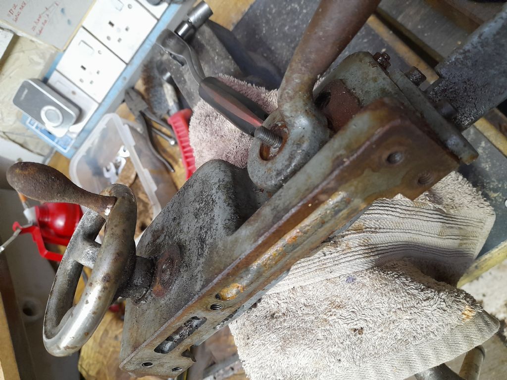

      After much use I found that the rack and pinion was showing signs of wear. On further investigation there seems to be changes in the apron with bushing or maybe without it with different gears depending on the S7 year. Can anyone shine a light on this for me.

            I have recently finished a refurb on a Myford S7, this model was manufactured in 1964 and I believe is a mk2 version.
            See forum posts 'Myford Super 7 for £395 at SRS'
            I did extensive work on the saddle & apron, luckily the rack & pinon were in good order but after repairing the bed and saddle the fitting of the apron to the saddle was now lower than previously, and the right thickness shims had to be fitted at the interface of these two components to put the pinion in correct mesh with the rack.
            I don't know what you mean by 'bushing' .. my interpretation is that a bush is a cylindrical collar but may mean something else to others. If both the rack & pinion are worn I can't see any way out of it but replacement of these parts however if the two are not in close contact it can feel as if they are worn and with some adustment of apron to saddle can be put back to a working situation, probably if worn there will be some backlash but I should imagine there would always have been an amount of backlash present even in the new item.
            This was the apron prior to cleaning up the shim should ideally fit along the edge facing.
            As Dave has mentioned a picture of the rack & pinion would give a better idea of the problem.

              I would think that if any wear of the bed or the ways, it would require the opposite, and removal of material off the face shown to tighten the rack and pinion fit. Mine is a Mk2 of 1972, not 1974 as I thought, but has the saddle across the bed , not the narrow type. The pinion shaft cover on the other side has a brass or bronze bush in the cover by the pinion gear itself. There is no adjustment for this height. The pinion on my lathe does have some wear, and at some stage the rack and pinion for the lathe should be replaced. There maybe some adjustment of the rack itself but I have not removed it to see. The backlash in the handwheel does not bother me, but it does not have very much anyway. There will always be some backlash and there is a reduction gear between the hand wheel and the pinion as well. It is possible that the early covers did not have a bush or sleeve in them. The casting has a hole to limit the max total amount of oil in the reduction box . Keeping the rack clean is a task often over looked as it is upside down and does seem natural to think it can't get dirty.
              My apron has no shims between it and the saddle.
              When putting it back together, I used the 1/2 nut to align it all with and then put in the screws, looking at the leadscrew to ensure that it was not being influenced with the 1/2 nuts fully engaged. I then sight through the end of the bed along the rack, to see if the pinion is near fully engaged. Which it is. Recently added a front DRO and I indicated the apron after how I described above and it was within 0.03mm over the 80mm length indicated. Close enough for the reader head and close enough that it did not need adjusting.

                I agree with Neil, there no shims to adjust the height of the saddle, the only shims used are for the saddle strip.
                One of restrictions on regrinding the bed is the rack. Myford use to say 10 thou, as this is the amount of movement the rack can be moved up to re engage with the pinion. Remember regrinding the bed involves repositioning both rack & Leadscrew.
