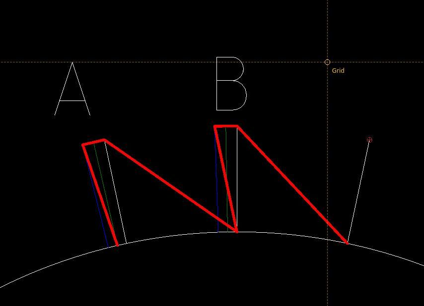

      I am attempting to brush up on recoil escapement design. Gazeley states in laying out a drawing for a 30 tooth E.W that you start off with the 360/30 spacing giving 12 degrees. Then you allow 1 degree for tooth tip metal…fine so far. Then he goes on to say a further 12 degree is allowed for drop. This confuses me looking at his drawing does he mean add a further 1 degree to the tooth tip making the tooth tip 2 degrees or does he mean something else?

          I am attempting to brush up on recoil escapement design. Gazeley states in laying out a drawing for a 30 tooth E.W that you start off with the 360/30 spacing giving 12 degrees. Then you allow 1 degree for tooth tip metal…fine so far. Then he goes on to say a further 1 degree is allowed for drop. This confuses me looking at his drawing does he mean add a further 1 degree to the tooth tip making the tooth tip 2 degrees or does he mean something else?
          I think he means leave a 1 degree gap for slack in the system but not as yet sure.

            What I know about recoil escapements is miniscule, so what follows is a wild guess.
            The white lines are the 12° markers, with the green lines offset by 1° and blue by 2°. Red is the tooth form.
            I think he means as in tooth B, where the top is 2° and the steep side comes back to the root. The form shown at A makes the tooth a little stronger but less positive for the anchor to catch and easier for it to release. Now I'm completely out of my depth!

              Dave, your post though appreciated ans well intentioned does not cut it with me, I could be wrong as I too am unsure.. I am referring to Gazely's clock and Watch escapments page 23.
              The back side of the teeth are radial and the front concave. but Gazeley is simply stating the theoretical teeth spacing if a tooth came to a fine point is 12 degrees. As the action takesxplace over half a tooth this is 6 degrees. Then the theoretical 6 degrees is adjusted for 1 degree of metal on the tooth tip and 1 degree of drop to allow for running tolerances. Looking at his diagram I fail as yet to see where the 1 degree of drop comes in. The rear flank on his drawing just goes back to the centre of the E.W wheel so in this case no there is another explanation that 'escapes' us (pun).

                Chris, I suggest that you find out exactly what is meant by "drop" in this context. In my experience many horological texts can be most obscure and often use terms which the author assumes everyone understands so are not defined in the text. I don't think that "drop" is there to allow for running tolerances, it's to make sure that the wheel is released by one pallet before the next engages.

                    John you are so right that word drop can be confusing. I have looked hard now at Gazeley's drawing and his explanation. My conclusion is that his drawing is in error or at the least confusing.
                    Drop has to be free run and it is defined often as necessary to allow for mechanical tolerances. Adding this to a tooth tip would do the opposite. So whereas 1 degree is stipulated for the metal tooth tip I am fairly sure the 1 degree drop is not affecting the tooth design as such but the pallets.
                    Looking at his drawing the reason I think it is in error is that he shows 10 degrees marked which is split into 2 unequal sections with one marked 5 degrees. I assume he is starting the 5 degree larger section from the 1 degree drop. Thus the drop is not marked on the drawing which leads to a lot of confusion.
