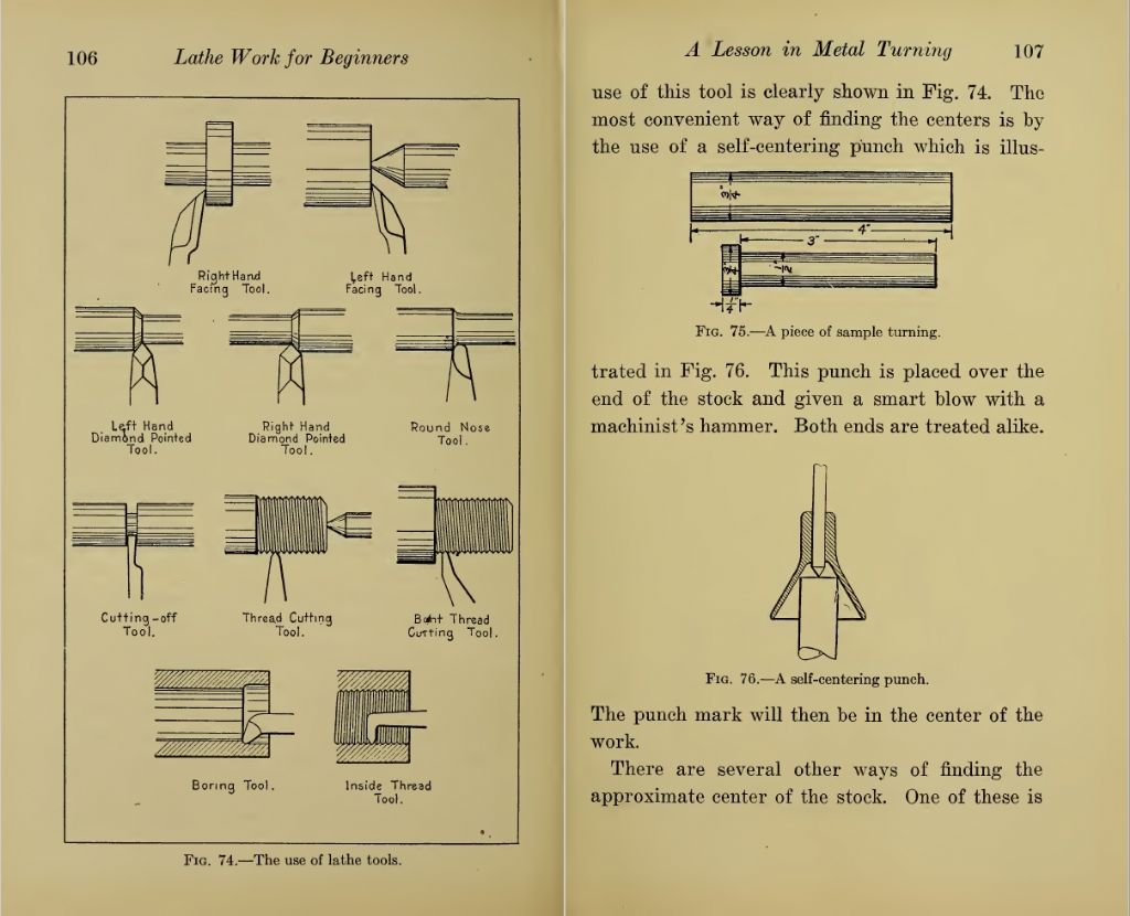

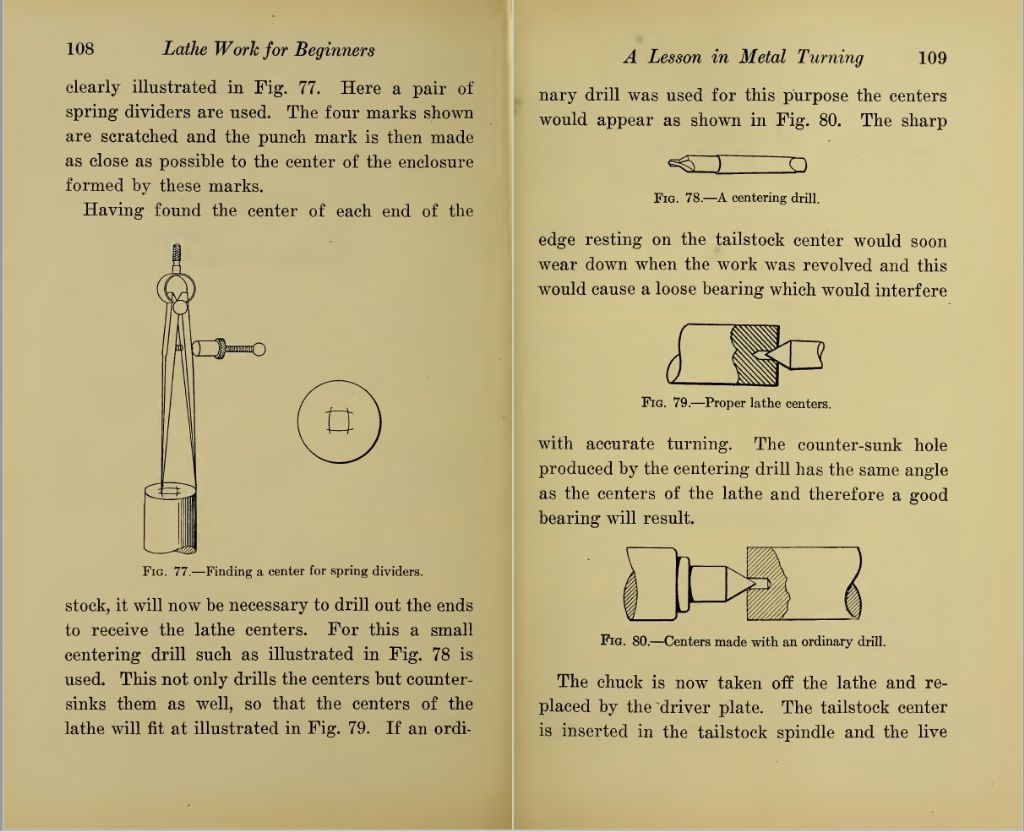

                    Lathe Work for Beginners (Yates, 1922) shows a bell centre punch, and a centre drill with a tailstock (presumably Morse) taper.
                    After finding the centres (e.g., using calipers or a bell punch) and punching the centres at each end, the work would be supported on the headstock 'live' centre, and a centre drill mounted in the tailstock and drilled in the usual way, then reversed and the second hole drilled. I have seen this another book, which I can't locate at the moment.

                      Bill, your book extract says use a chuck in the headstock to drill the workpiece. The OP asked what was done before chucks were readily available.
                      Martin C
                      #625541
                      Bill Davies 2
                        @billdavies2
                        I agree, Martin. My text suggests the earlier method of finding the centre by whatever means (calipes, odd-legs, bell centre) then using a centre punch, followed by centre drilling. The centre punch was the original method of producing the centre holes, hence the 60 degree angle often mentioned, whereas the prick punch was a finer angle to pick up scribed lines. The key point was that the centre drill was held by machine taper in the tailstock, and temprarily supported by the headstock centre whilst drilling.

                          Posted by Martin Connelly on 20/12/2022 16:03:48:
                          The OP asked about chucks to hold the stock.
                          I am quite sure you can think of a way to hold a drill bit in the headstock without using a chuck if you put your mind to it (hint, look at Fig. 78 of the same book).
