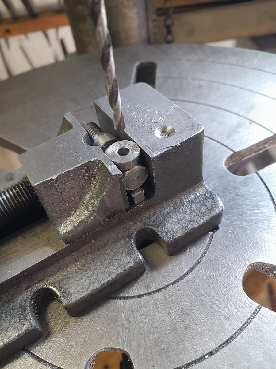

                I just remembered a clever but simple way of cross drilling, courtesy of GH Thomas.
                Take a short offcut piece of your 3.5 round, and drill a 1.5 hole  lengthways through it in the lathe.
                Then grip your 3.5 shaft in the drill vice, with this small piece placed vertical where you want the cross hole to be. It is sat on the shaft and nipped up by the vice jaws too. Use it to guide your 1.5 drill right through the shaft, dead in the middle.
                Quick and easy and I have done it many times now on piston rods  etc on model engines. So easy I don’t even think about it. All just part of the job.

                                                Bazyle
                                                  @bazyle
                                                  The GHT / Cedric method is brilliant but may not have been understood.
                                                  The guide piece drilled centrally in the lathe when subsequently held in the vice turns that vice into a cross-drilling jig by placing the guide hole equidistant from each jaw with the jaws 3.5mm apart. Then a square or round bar can be inserted between the jaws underneath the guide for cross-drilling.
                                                  A clamp on the target bar can be used to prevent rotation/provide a reference plane. The distance from the end can be measured relative to the guide with callipers allowing for half the guide diameter.
                                                  After a few years one could build up a collection of such guides. Bother, should have started this years ago.

                                                    #825351
                                                    cedric 1
                                                      @cedric
                                                      Thanks for clarifying. Here is a picture of a mock up showing the basic principle.
                                                      20251120_082003
