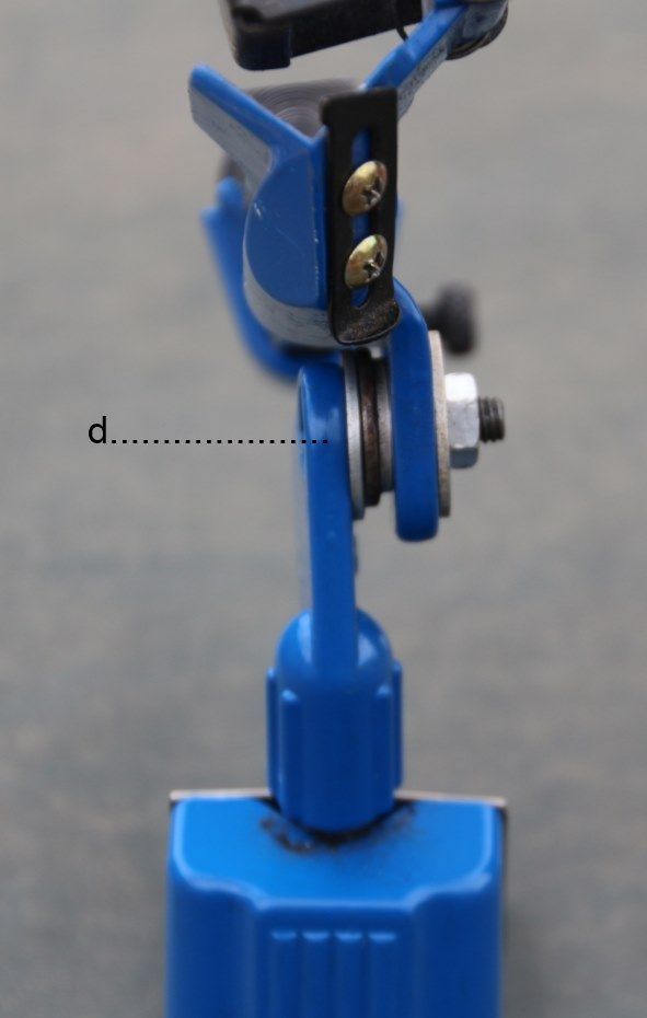

        Many will be familiar with this type of drill grinding attachment.
        I bought a DRAPER version a year or so ago but having spent to much time trying to grind the correct relief angle on a drill point I chucked it in a draw and reverted back to touching up the odd drill by hand and there it has lived – unused – ever since.
        Being between projects at the mo (actors call it resting don't they?) I decided to have a last go. It seemed to me that there was something fundamentally flawed in the design because the jig was sweeping the drill point at to great a diameter producing a relief angle that started at "a" and ending at "c".

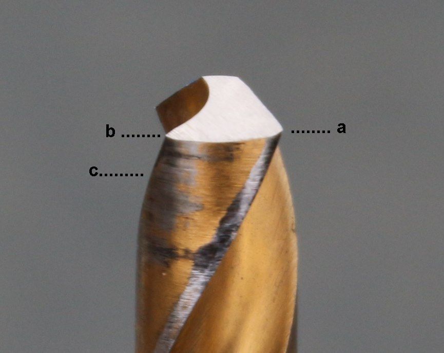

        This was producing a far to great a relief angle – weakening the cutting edge and really only good for drilling plastic.
        After a bit of trial and error and using different thickness's of washers at "d"
        I managed to get a more or less acceptable relief angle as can be seen from the drill point shown between "a" and "b".
        Now I know that I can sharpen drills "proper" using this jig I'll make a more permanent mod to make the job a good'un. The spacer will need to be the same as the total thickness of the three washers – 5.2mm.

                    Putting aside the fact that many of the cheap import versions are so badly made as to the completely geometrically unsound there is no great difficulty in getting good results from these jigs providing some effort is made to follow the instructions. It does help if you have some understanding of the underlying geometry involved.
                    These jigs put the drill centre line offset to one side of the pivot axis so a simple side to side sweep brings the drill in front of the pivot by an amount proportional to the sweep angle. This basic movement produces a clearance angle across the drill radius which won't cut unless the angle is so exaggerated as to approximate 4 facet form. To achieve the correct shape where the clearance angle runs around the drill circumference requires the depth of grind to be increased as the swing progresses.
                    There are two ways of achieving an adequate approximation to the desired geometry with these simple jigs.
                    One way is to set the pivot stem vertical and the drill cutting edges at an orientation best described with reference to a conventional clock face as 25 past 11. The original Picador jig uses this geometry. The projection is set by lightly butting the lip of the drill against the lip rest. Although it is in some ways advantageous to use the same projection for any given drill size at all point angles the grind accuracy does depend on how closely you manage to set the 25 past 11 cutting edge position. It doesn't help that there are no on jig references. The lip finger fit is usually pretty poor too which merely adds to the difficulty. Especially with small drills.
                    The alternative method is to set the pivot point at an angle, usually a little under 20°, as in the jig described by Howard Hall whose operation he completely misunderstands. I can only assume Howard did not have the benefit of a proper set of instructions. Here is a link http://www.generaltools.com/assets/i…825_Manual.pdf to one set. The geometric results of the angled pivot plane are essentially similar to the vertical pivot and 25 past 11 drill orientation of the Picador Jig but introduces a component dependant on drill projection distance. This means that you can, in principle, set the drill position by direct measurement where-upon contact between drill and lip rest will produce the right orientation of the cutting lip and heel. Naturally it is a complete pain in the butt to measure the projection of each and every drill prior to sharpening so the carrier trough offset and pivot angle in a correctly made jig are such that setting the cutting edge vertical with the drill in contact with the will work for the common 59° and 68° point angles. For other angles you need different projections.
                    Although simpler to set-up for normal angles, vertical is much easier to judge than 25 past 11, the angled pivot geometry is not quite as good an approximation as the vertical pivot one. A high heel needing a touch of hand grinding to remove is pretty endemic with larger drills. A slight twist of the drill will, I understand, fix this.
                    On the Picador jig the drill carrier trough is offset by about 3/16" from the pivot axis. The angled pivot versions I've seen are similar but there is an interaction between pivot angle and offset so there is room for variation.
                    These devices work much better using a properly dressed cup wheel rather than just rubbing across the side of an ordinary grinding wheel. It's also imperative to provide some means of guiding the base so it remains correctly orientated ay 90° to the grinding wheel face as you slide it back and forth to get the drill to just touch the wheel before grinding. It should be obvious that any twist will completely muller the motion geometry, most especially with the angled pivot version. The vertical pivot is a touch more tolerant but still not very. The simple slot and bolt idea is monumentally inadequate. Its important to judge just the right amount of downwards force on the back of the jig when swinging. The vertical pivot Picador is very sensitive to this. Simply letting things float in the crude vee and plate bearing will not produce consistent results.
                    The linked instructions from General suggest that the jig can be used on the periphery of the wheel. Something I find hard to believe unless the wheel is very large.

                              Neil – If you want more heel clearance simply reduce my spacer mod thickness slightly. Of course this only applies if your jig has been manufactured to identical dimensions to mine.
                              Bazyle – You are near. With my 5.2mm spacer setup I can line up an engineers square with the centre of the pivot and looking head on at the drill point it shows it left of centre, about 3mm I'd guess.

                                    Graham – Using my jig with spacers as described and with the pointer set to 59 degrees I get an included angle of as near 118 degrees as makes no difference.
                                    Your helpful post highlights the fact that these types of jigs are made with some differences. I believe this in itself causes some confusion when discussing set up procedures. In particular the vertical pivot pin version versus the angled forward version (my sort).
                                    Having read the very informative posts so far on this thread I still think my version design is flawed as without my spacer mod the sweep diameter is far to big making it impossible to get anything like an acceptable relief angle regardless of how far – or not – the drill sticks out.
