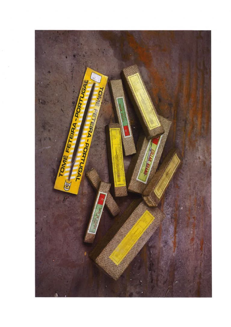

                              Just for further clarification… the packaging shown in Bill Phinn’s eBay link example looks genuine, and Tomé Fèteira normally supplies these files in 12pcs (Dozen) box as shown in the pictures in Bills link.
                              The pictures in Jasons link, are standard packing as supplied by ARC. They are a single piece packing. Cardboard paper sleeve provided by TF, covered with plastic sleeve supplied by ARC to TF, so that the packaging can take place at the factory. When we first started selling TF files, we found splitting of 12 pcs pack added time at our end, and introduced an element of rust for certain files. So decision was made to get the whole process done in Portugal.

                                3. New old stock is possible. We have over 500 thousand files branded with the old logo. Mostly files of odd sizes: 5”, 7”, 9”, 11” etc. or sizes over 16 “, or special files. These sizes production was stopped as an agreement between all manufacturers over 40 years ago. New old stock , would however now be delivered in new boxes. If sold in the past, the boxes should be like the ones in the attachment.

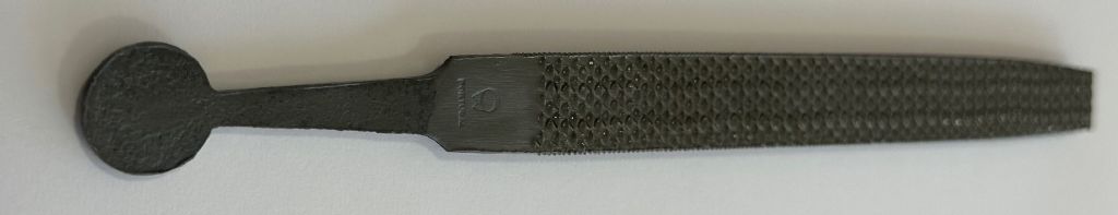

                                4. Is the file in the OP picture from us? Black rough tang is consistent with the period. Scratches from grinding the steel before the cutting, look less smooth than normal, but can be. Logo without Tomé Feteira written underneath is not normal, but sometimes happened. Below is a picture of a small rasp with a strange tang I found the other day and kept on my desk among with my pens. It shows only the logo and Portugal.
                                1. But mostly, what makes me question the origin is that the logo is badly stamped / stamped twice, causing a visually unpleasant result. At the time, and until the late 80´s all files were literally tested one by one, for hardness, for cutting and for visual imperfections. A file with such a bad logo normally would not have passed inspection and would not have been sold / exported. It would have been redirected for the local market of second quality files. But who knows? Does the file have a shiny finishing? Like a varnish? From that period files were protected against rust with a kind of coating/varnish made from pine tree resin.
