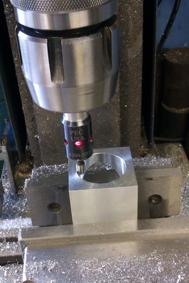

                #93279
                russell
                  @russell
                  there are electronic types available which dont rely on conductivity of the material, but on movement of the contact probe.
                  In fact, one of the members of MSMEE (melbourne SMEE) has built his own based on his interpretation of a patent found 'on the net'. Cant remember the patent owner right now, but big in measuring tools…
                  It has 3 pairs of contacts (ball bearings) arranged in a circle (120 deg apart) and a spring loaded disk with contacts which sit between the balls. All is connected in series with a lamp. ANY movement of the probe, which is perpendicular to the disk, breaks the circuit.
                  he checked it against a 'real' one, with fine results. (he used a commercial probe, as for any edge finder its essential to know the precise dimension of the probe…)
                  – russ
                  Just had a thought…as its not 'spinning' when in use, its clearly essential the probe is concentric with its mounting spindle.  I dont think that is a consideration with the mechanical 2piece spring loaded one, so it probably requires more care to build…although the last 'how to' article i read on making one suggested that a cylindrical grinder was an essential tool in its construction.)
                  Edited By russell on 29/06/2012 04:51:42
                  #93280
                    He is using it for more than simple Edge-Finding, but this may be what you have in mind, Russ.

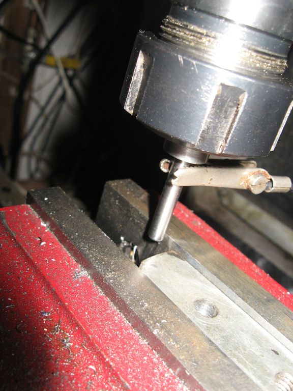

                      #93308
                        As Bogs says some have quite large shanks, mine is 1/2" so easily fits in a collet or drill chuck.
                        I do give the finder a half turn between taking pairs of measurements just to even out any possible eccentricity.

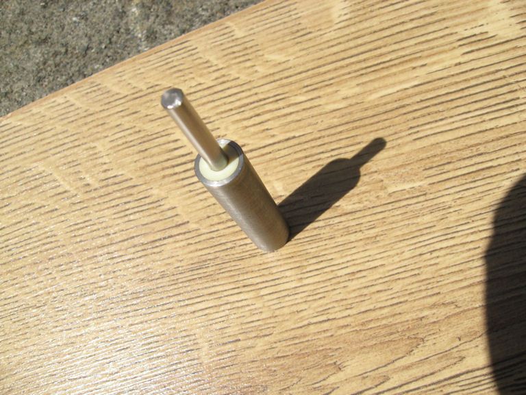

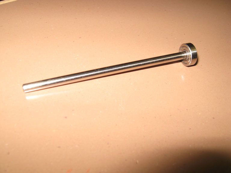

                          Hi All,
                          Here is my home made electric edge finder.
                          It is just a piece of 5 mm ground rod pressed into a hole in the insulator. The insulator was made from nylon (I think). The outside was first turned to about 10 mm diameter. A length of about 5/8" rod was mounted in the lathe chuck and bored out so the insulator was a press fit. the insulator was pressed in to the bar and then bored out so the 5 mm rod was a press fit. Without removing it from the chuck the outside of the 5/8" bar was turned down to 1/2" It was then cut off from the end of the bar that was in the chuck. The 5 mm rod was then pressed into the insulator. making it this way should ensure it is concentric. The indicator was just an LED bicycle rear light (Bought from a £ shop.) with a single transistor amplifier to drive the LED's The connection to the 5 mm rod was just made with a crocodile clip.
                          Another very simple edge finder is a ball bearing on the and of a short piece of rod. The rod is mounted in the chuck / collet. The outer of the bearing is marked with a felt tipped pen so you can see if it is rotating. With the mill running the bearing is moved towards the work piece until the outer just stops rotating when it makes contact with the work piece.
                          Les.
