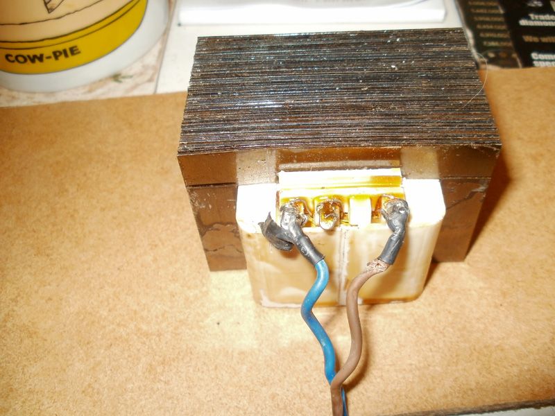

                                I freely admit that the land of the magic smoke is not my normal abode so a lot of the above has gone well over my head but this is the transformer I have dismantled and removed the secondary windings from and re-assembled as per the articles instructions.
                                transformer
                                The connections are the original mains cable the middle position being vacant.
                                If I use my little digital multi-meter on the connections everything is open circuit except between the vacant centre terminal and live. That makes me think this transformer is NBG is that correct?
                                Andy
                                #207539
                                Michael Cox 1
                                  @michaelcox1
                                  Hi Andy,
                                  If there is an open circuit across the original primary connection then I think you are correct in assuming the transformer is NBG.
                                  Don't eat to much cow pie it might make you desperate!
                                  Mike
                                  #207564
                                  AndyP
                                    @andyp13730
                                    Thanks Mike,
                                    Just to satisfy my curiosity I took the cover off the primary winding and found a small square black component between the centre terminal and neutral, the actual windings are terminated on the two connections I measured 47 ohms on so maybe it isn't a lost cause, just got to rescue the stack of E plates from the bin!
                                    The component has the following legend:- A3 AUPO Q2 125C JET 2A 250V so I suspect that tells you what it is, it is open circuit whatever it is.
                                    Cow pie – that's my Desperate Dan tea mug, my kids think they are comedians!
                                    Andy
                                    #207568
                                    Ian P
                                      @ianp
                                      The component you describe is almost certainly a non resettable thermal fuse. Set to open at 125 degrees C and rated to carry 2A continuously.
                                      What is does tell you though is that at some time your transformer has been hotter than it should! The fuse though will have prevented any winding damage and certainly if you have the limiting resistor (lamp) then it should be quite safe to use.
                                      I originally suggested it might have a fuse but you had said that the photo showing the mains terminals and wiring was original but I could not see any connections.
                                      Ian P
                                      #207577
                                      AndyP
                                        @andyp13730
                                        Ian,
                                        Cheers, that will explain why the battery charger it came out of stopped working then. In that photo the component is wired across the leftmost two terminals, the winding across the rightmost two but it was hidden under the tape wrapped round the windings which is itself under a plastic cover so not obvious unless you know it might be there.
                                        Andy

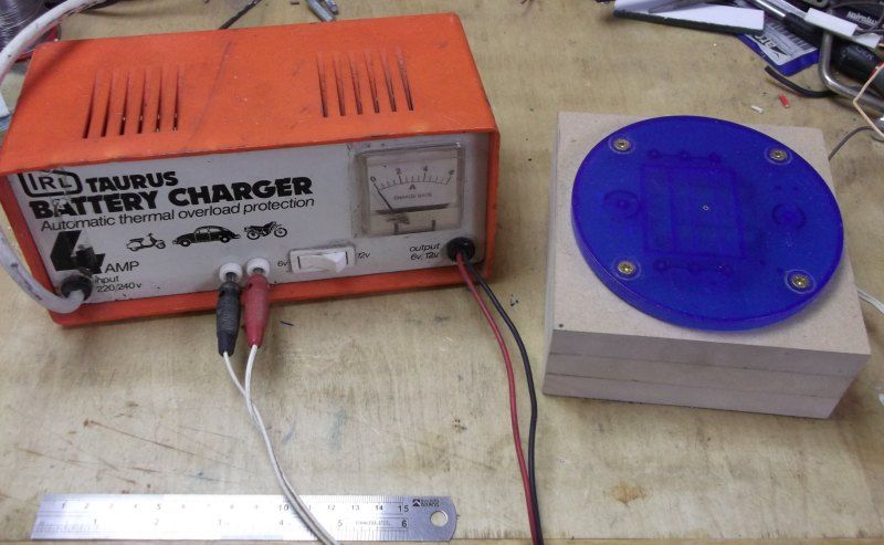

                                        #216106
                                        Frances IoM
                                          @francesiom58905
                                          I started to construct the demagnetiser suggested by Mike Cox in MEW but on disassembly found that the primary was open circuit (tho thermal fuse seemed ok) – the source being one of those 25W small halogen lights on telescopic arms sold (and possibly still are) by WH Smiths, B+Q etc – didn't check the transformer as thought the failure as a lamp was due to the failure of the non-repairable on/off switch embedded in the hemispherical cover
                                          however the secondary winding was fine – the base was removable and was already provided with screwfittings for the transformer which just needed a mdf spacer to replace the removed I laminations
                                          Powered from an old 6V battery charger with a 1ohm 10W resistor(ex Maplins) fitted to limit current to about 2A – the 3 bits of spare MDF easily cut to form a case – the only got-cha I realised was that the terminals needed to be isolated from the case just in case came into contact with on of the charger leads and shorted the rectifier hence the use of 2 4mm terminals rather than the planned barrel connector
                                          No problems with mains or the use of empty soup tins!
                                          #216109
                                          Ian P
                                            @ianp
                                            Posted by Frances IoM on 12/12/2015 21:33:42:
                                            Unless I have misunderstood, or missed something really obvious I'm not sure how your demagnetiser works!
                                            Demagnetisers work by producing a rapidly reversing magnetic field from an 'AC' source. If the charger has a rectifier in it than it produces DC so will in fact magnetise all you tools.
                                            Ian P
                                            #216110
                                            Frances IoM
                                              @francesiom58905
                                              sorry thought obvious I merely tapped across the 8v winding on the transformer (hence my comment re possible short circuit of one arm of the bridge rectifier (an old selenium rectifier the smell of which when fried is not pleasant) – thus fed by low voltage 50Hz!
                                              #216125
                                              Martin Connelly
                                                @martinconnelly55370
                                                Why not feed the demagnetizer coil with the AC from another transformer? This will be a safe way of limiting the current in the demagnetizer coil and be more robust than a lamp bulb.
