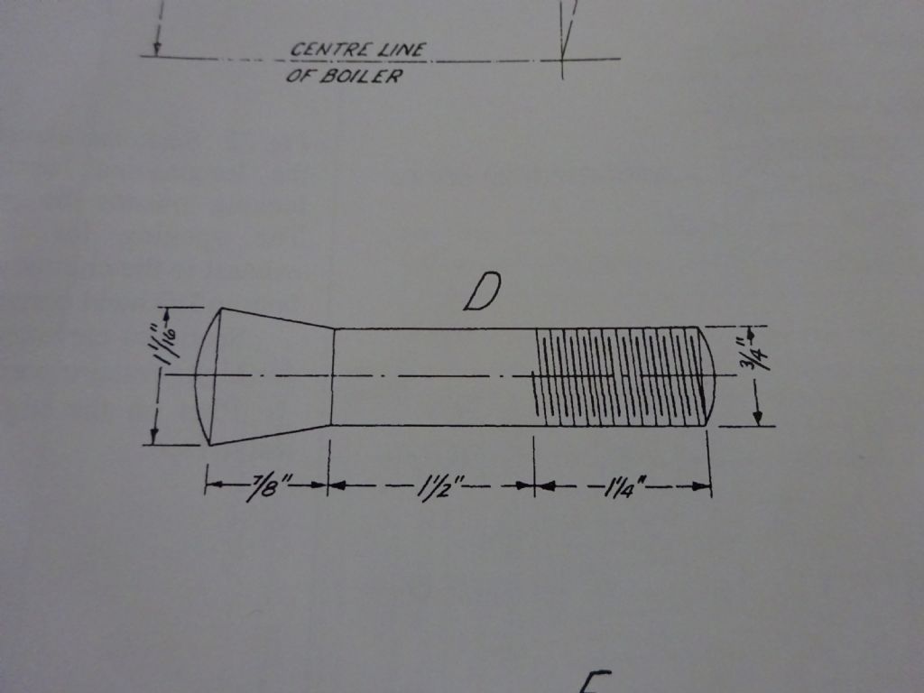

      Hi, I'm currently building the D & NY in 2in scale. My question is to do with the mounting of the cylinder casting to the boiler. The boiler has the extra copper plate silver soldered to the outside where the cylinder is mounted. But do the cylinder mounting bolts/studs go into blind holes, or is it ok to drill right through and then use studs. It just seems that there is not enough thickness of the plate to use blind holes. Can someone please advise me.

                  Many full size engines have the cylinder fixing holes drilled right through the boiler shell. The only difference being the holes are not tapped; carrot bolts are used instead of studs.

                        Think of a "stud" shaped like a 5C collet where the end of the plain end of the stud tapers outwards. A lad would have been sent in via the manhole to poke the bolts through from the inside where they would be pulled up tight into the hole as the nuts were tightened preventing them turning and more importantly sealing the holes.
