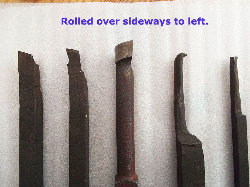

      Hi. I picked up a pre-owned Clarke lathe today in exceptional condition.. Unfortunately the seller suffered a fall in the week, so his son was there to handover the lathe. The lathe is variable speed, with compound slide, power feed and screwcutting capabilities. This is my first 'proper' lathe.
      Okay – to the point. There were these five tools in the parts box that have seen better days so I need to get some more. My primary use of the lathe will be turning jewellery items from materials as soft as wax (investment casting) epoxy resins, aluminium for prototyping, brass, bronze and at some stage stainless steel. I will be both turning including putting bevels on and when I get a tailstock chuck in place boring up to 22mm on 25mm rod.
      Based on the above, would you guys recommend getting a set of regular tool steel cutters or those cutters I have seen with the carbide inserts? I am only intending to get a cheap set to begin with until I get more experienced with the lathe, for obvious reasons. I do stress that I have zero experience of sharpening cutting tools and limited experience of using a lathe.
      All help, suggestions and guidance would be gratefully received.

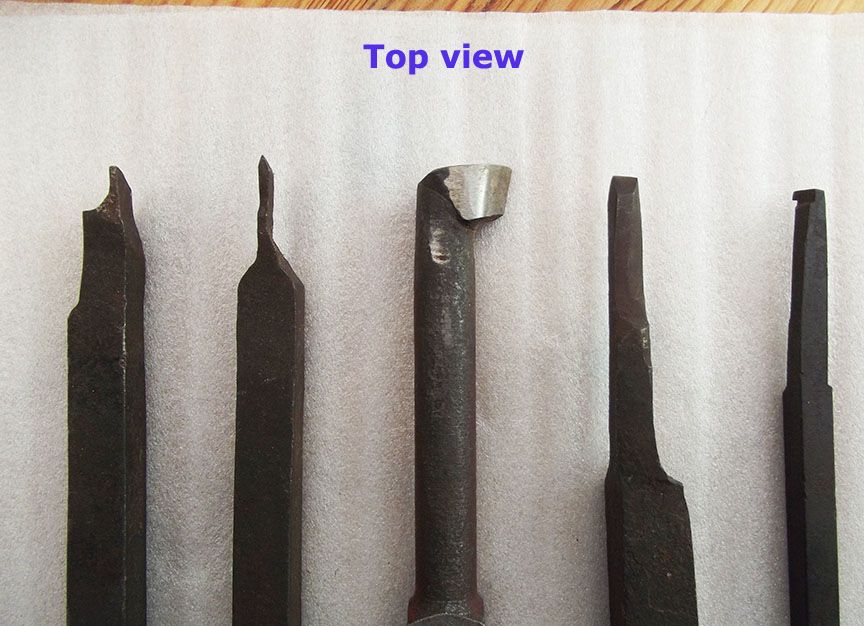

              These are the five tools that came with the lathe (thanks to David for telling me how to get photos on here.
              I am guessing the left hand two are parting tools. The centre tool is unknown but with a 13mm square it going to be too big for the toolpost. The two right hand cutters have a tiny cutter at a ninety degree angle to the shaft so presume they for thread cutting.

                Yep will be using a boring bar Andrew.
                I do have a sturdy bench grinder as well as decent files including diamond. Would need a few tools to see what I was l was aiming for to be able to create my own tools at this stage though, as would hate to cause damage to the lathe.

                  Your middle tool is a boring bar. The one to the left of it looks like a fine external threading tool, the one to the right a fine internal threading tool.
                  Far left possibly parting and far right possible small internal groove cutter.

                    Hi Will,
                    The middle tool looks like a boring bar, you are probably right that the tool to the left is for parting (or grooving) and the two rightmost for cutting internal threads. A few tools made from HSS blanks should get you started. For advice on grinding HSS lathe tools look here or here.

                      Thanks for the info on what the existing tools are guys. I have found a 6th tool in there now, which I initially thought was one with a broken tip but on closer inspection it is perhaps a regular turning tool, as appears to have three ground surfaces on there akin to the pictures in the link that Thor has kindly provided.
                      Not the silly question that it may sound, but are all HSS blanks suitable that are the right size to fir your toolpost, or are there different hardnesses with some more suitable for lathes or different materials. Do bear in mind I am a complete novice as regards lathe tools..
