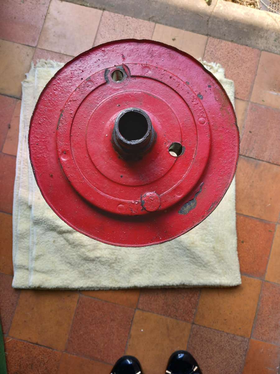

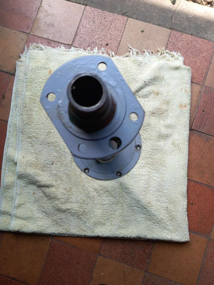

      Background: I want to cut a lozenge shaped hole in a steel disc. I have two vintage Austin Seven axle tubes. Many of you will be familiar with the set up. The axle is in three parts (four if we’re pedantic). The central case for the differential, two side tubes for the axle shafts, and a torque tube at the front. The problem is, someone has cut the brake back plates off my tubes(!) and left a lozenge shaped end on which they intended to fit  some sort of hydraulic brake arrangement or; perhaps, the very late Austin Seven Girling mechanical set up. (Photo one)  I don’t want any of this, but I don’t want to discard the tubes either; rather to return them to their original vintage form. Photo two)
      Thus, I need a new back plate (144mm diameter) with a big hole in the middle to weld onto what’s left at the tube end.
      The complication with the hole, as you can see, is it needs a radius top and bottom to fit onto the tube and I’m not sure if my thinking on this is sound.

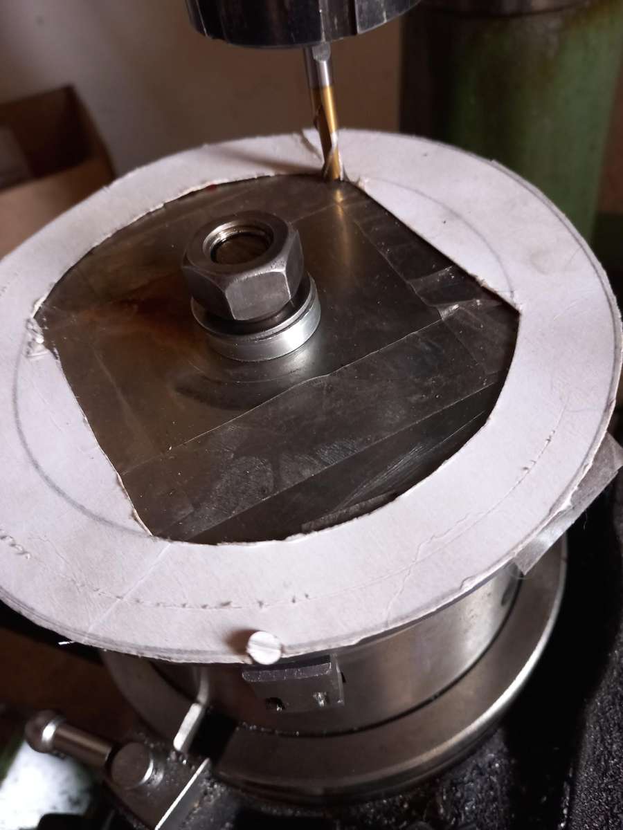

      But how do you make the hole?. I thought to secure the back plate on a rotary table, and with an end mill/slot drill in my  milling machine, off-set the spindle to the radius of the aforesaid imaginary circle  measured from the centre of the
      back plate. Turning the table through the requisite number of degrees against the mill should then cut the radius shouldn’t it? The cutter could then clear the waste by moving down both sides on the mill’s Y axis? But if this is viable – what would be the correct/best type of  mill?

          If you want to do it yourself it may be better to stitch drill just inside the edge of the hole and knock the waste out. You are then just left with your rotary table setup to clean the edges up.
          3-Flute milling cutter should do the job. And a lot less stick out that that cutter in your first image.
