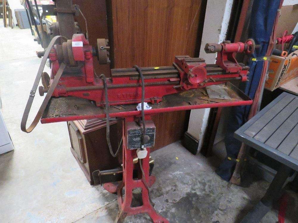

      I saw this Myford on a curious stand in a recent auction, I wonder if it was a factory option?

        Not a Myford option that I’ve seen but several between wars lathes were supplied on single foot stands. Normally heavy cast iron and probably meant for bolting down.

          Not seen that type before and UNLESS bolted down I would be affraid it would topple over. Noel.

                  An unusaul stand, topped by what seems to be an early ML4, judged by the flat belt?
                  One careful owner, pity the subsequent one(s) weren’t
                    Howard
                    Maybe the new owner will giv eit some love, sold for £65.
                    William.
                    #714624
                    Nigel Graham 2
                      @nigelgraham2
                      Hopefully, yes he will!
                      Thank you for the remarks on the chuck: since the jaws in mine are effectively Vee-blocks they will hold round and square tools.
                      The stand is intended to be bolted down: the feet have quite visible holes.
