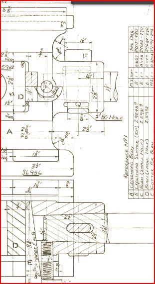

      I need to secure my crossheads on 3 1/2 Lilla Loco to the piston shafts,The drawing calls for a 1/16 x 1/8 long cotter pin.
      Does anyone know what this is?
      I have googled and all it brings up is Split pins which obviously is no good,Does anyone think that they mean a split roll pin?
      Thanks
      Bit puzzled about this and don't want to make an error at this stage and scrap the crossheads.

        #103607
          Think of it like a flat taper pin.

            Deltic
            If you can get a sight of MEW 29, you will find a reference to cotters (and proportions) in Alan Jeeves' article on Keys & Keyways (page 17). hope this helps.

            Weary
              @weary
              Here are some pics and drawings that may give you an idea of the sort of thing… albeit far larger than you need!
              Phil
              #103627
                Now I'm back on the PC here is a section from a Fowler works drawing of the cotter arrangement that they use.
