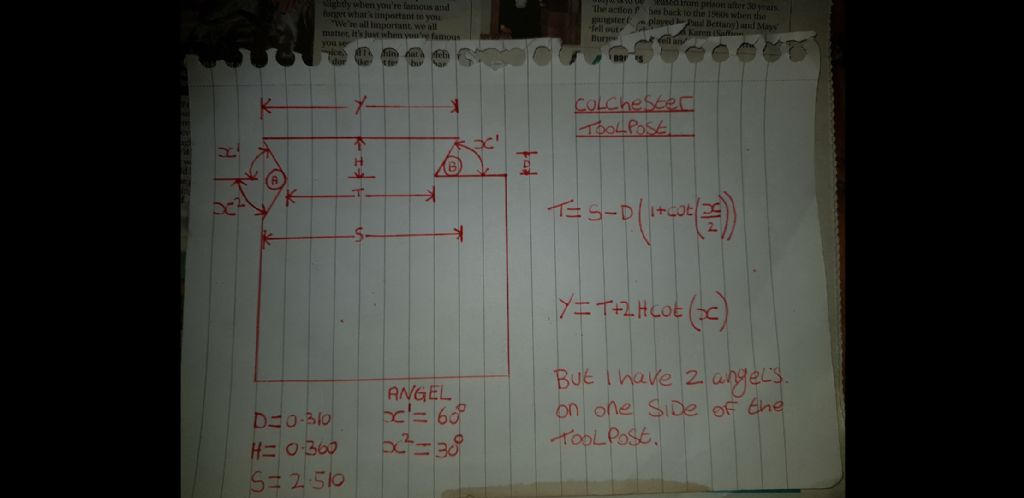

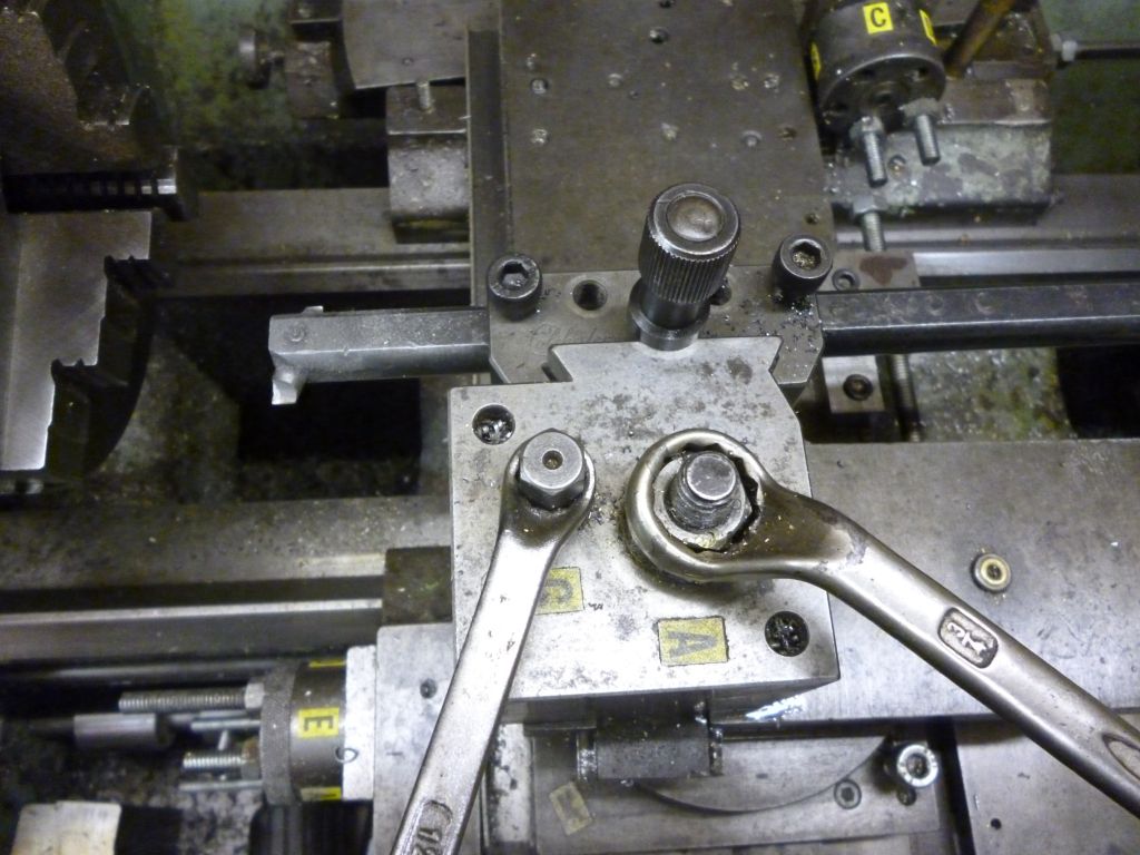

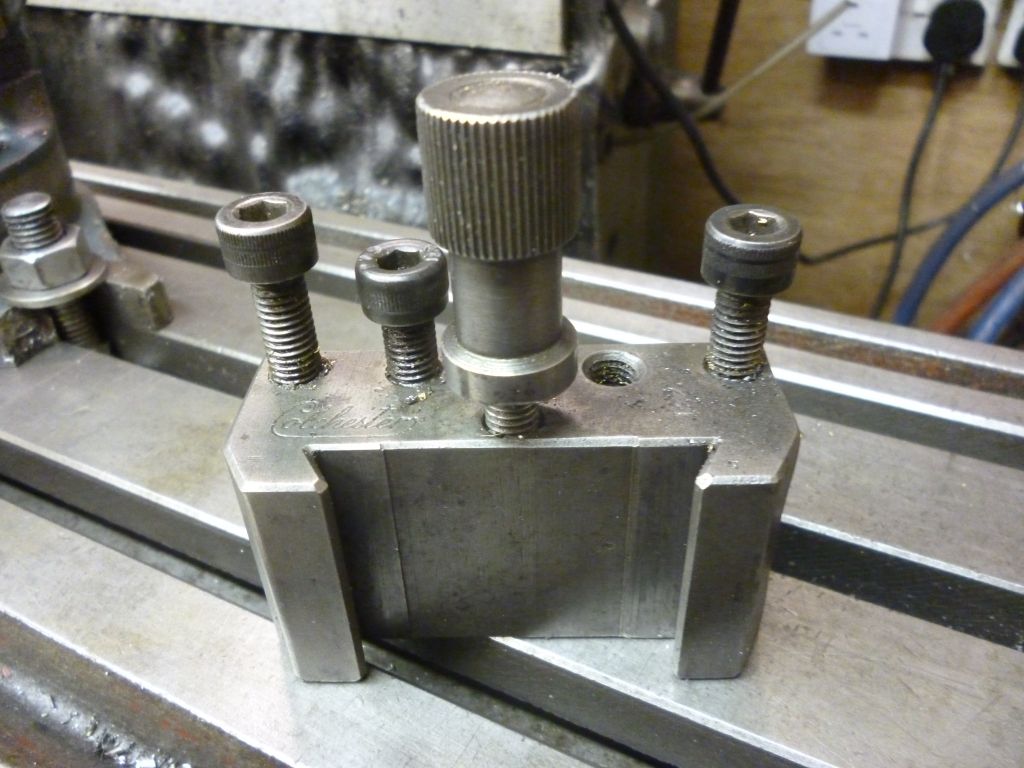

      I have a Colchester toolpost but unfortunately I have no tool holders. I'd like to make some but due to its design I can't easily get an accurate measurements from the toolpost it's self. I've attached some pictures that I've found on line. If any one has this toolpost, could I get some dimensions of your tool holder please.
      Thanks
      Steve
      3028-quick-change-toolholder-toolpost-side.jpg5063-colchester-toolpost-turned-round.jpg

              The problem I have is that one side of the dovetail on the tool post has 2 angles so it's quite difficult to get a good measurement.
              See attached.

                Hi Steve, Thanks for the sketch, it clears things up a bit.
                Attached sketch below shows how the angle positions could be measured using Mr Maurel's jig and a modified version of it to establish the angled face locations. Hope it helps.
                Note that in each case the pins are screwed to the plates to make the jigs easier to hold in use, and the plate edge is back from the pin dias to ensure you are measuring from pin face as intended, not plate face or edge.

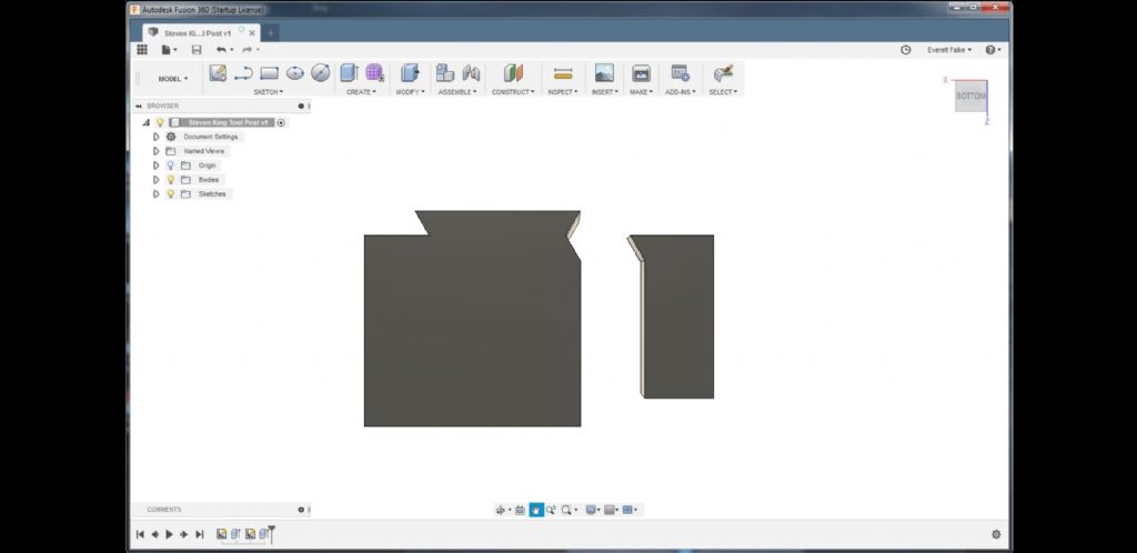

                  Very interesting Jeff I would have never thought of that please see attached a picture a friend send to me when I asked advice on the same issue his name is Everett and he has a YouTube channel called Everetts workshop very nice chat always happy to help definitely worth checking him out.
