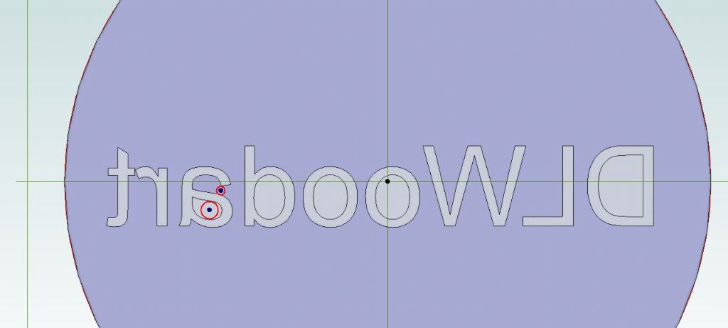

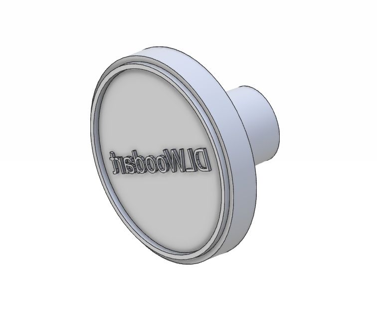

              Do you mean something like this:
              My 3D model is 35mm overall diameter, with a threaded boss on the rear to take a rod and handle. The circle is 2mm wide and the text is 4mm high (capitals). As Jason says, the middle of the "a" will be the most difficult, but that could possibly be overcome with the choice of a different font. I used Arial for convenience. Much smaller than that and I think you'd be looking at a specialist engraver.

                1mm cutter won't really do it. This is text on a 25mm circle. to get into the top of the "a" the cutter needs to be 0.3mm and 0.6mm is the largest that will get into the enclosed part. You would also really need to layout each letter individually as normal spacing makes the r & t almost touch
                Can be done with a tapered engraving cutter with 0.2mm tip but you won't get very deep , this combined with the fact the upper case letters are only 3.25mm high and it will probably end up as a black blob of scorched wood

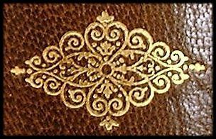

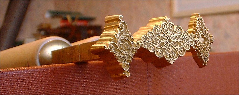

                                The pictures show three brass finishing tools for bookbinding that I had engraved a while ago. The second picture shows the middle tool impressed through 24 carat gold leaf on to goatskin.
                                The tools are all less than an inch square. The two on the left were engraved using a manual pantograph, the one on the right using CNC. The pantograph-engraved tools are cut considerably deeper than the CNC-cut one.
                                Unless you get the temperature, pressure and dwell time exactly right and the wood is a close grained variety, you may lose a lot of detail if you are using your proposed one-inch tool for branding.
                                EtA: the brass in all three cases is CZ121.
