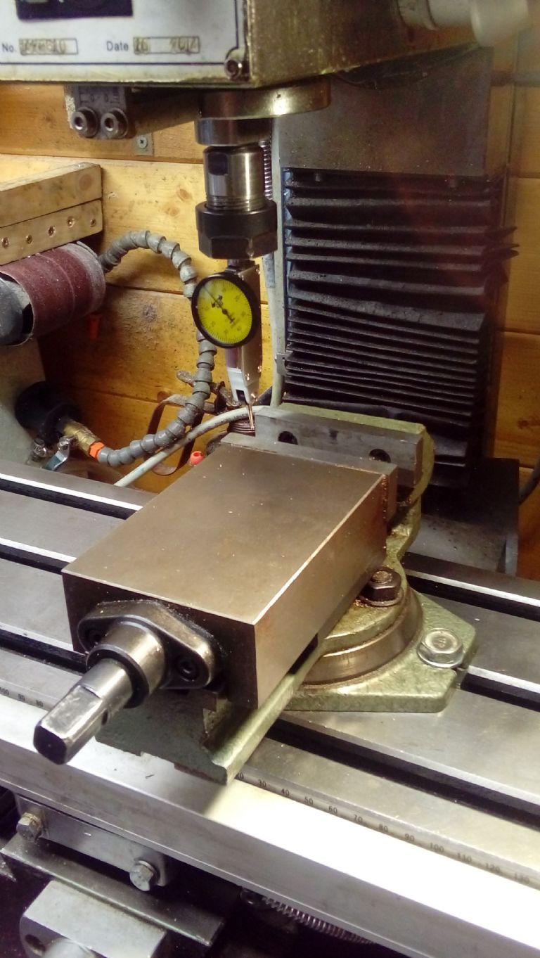

      Hi,
      I've come back from taking a short break from the workshop. I don't know if i'm going senile here but i can't seem to dial a mill vise in parallel using the dti without throwing it out, normally by 0.1-0.15mm, as tighten up the bolts again.
      It's not that i can't find parallel, i can normally get it to the 0.02 over 6 inches of travel no problem. It's literally just as i come to tighten it up.
      It doesn't matter if i keep one side pinched up or if i use the lightest of touch on the spanner. Is there something i'm doing wrong here?

                    Posted by JasonB on 26/08/2018 17:56:33:
                    If you can normally get the vice to 0.02, I doubt the vice will have warped or moved since you last used it. What have you done different to before?
                    Hi Jason,
                    What i mean by that is that before i've started to clamp it up, the reading is to 0.02mm, but as i start the clamping the reading starts to get worse until i end up at the 0.15mm mark normally.
                    I admit, It may have been doing this for quite a while if i simply trusted the reading before the nuts clamped down and didn't bother looking twice.

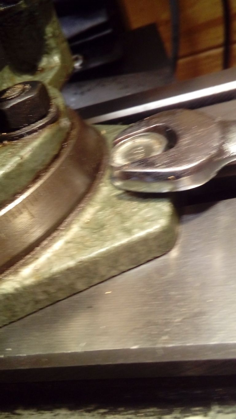

                          Okay,
                          Had another crack at it today and i think i've solved the problem, there are a number of factors that may or may not have come into play with the error.
                          -Giving the machine a good clean. Was a minor amount of grease and stains that needed de-greasing, and scrubbing but gave it all a wipe down afterwards and put a thin rub of WD40 afterwards to help ward of the rust monsters.
                          -Those washers really were flimsy! one had bent right out of shape under repeated duress i assume. So i got some washers that were about twice as thick and replaced both of them.
                          – I have a bad habit of taking the parallel reading off a big vertex gauge block, clamped up inside the vise, which isn't really proper, but this time i did the right thing and took it from the inside of the fixed jaw.
                          -The vise is pretty durable, i like this model that much, that i have a second one also. But it comes with a swivel base, which is really not useful 99% of the time. But hey.
                          I had another habit of clamping the base and adjusting the vise on the radial slot, which in hindsight probably may have contributed to the encouragement to twist away. So i left that clamped up and adjusted the vise along the table clamp tabs this time. One pinched up gently and the other a bit looser.
                          – My number one culprit that i suspect may be the worst of them all. I noticed as i was doing up the bolts that my spanner would catch the draft angle of the casting. Sounds so stupid looking back but definitely very easy to overlook.
                          I think you can just about see the radial draft near the base of the index markings. Urgh.

                            Michael, I noticed that you are using bolts to hold the vice down. I was told (many moons past) that this is not a good idea. Firstly because if the bolt is too long it will bottom out and jack the tee-nut up possibly damaging the the slot. Secondly because many tee-nuts are not tapped all the way through, basically as if a taper tap was used. This to allow a stud to tighten into the nut and not go all the way through preventing the stud hitting the bottom of the slot. If you tighten a bolt into such a tee-nut it will get very tight and difficult to turn.
                            I believe the recommended way is to use a tee-nut and stud with a nut and washer to do the clamping. Others will possibly have different ideas!
                            #369313
                            Jeff Dayman
                              @jeffdayman43397
                              +1 for studs and nuts only to be used to secure vises to machine tools for exactly the reasons mentioned. Do not use bolts, ever, or you'll likely be writing into the forum about fixing broken T slots or holes punched in mill tables ( a LOT harder to fix than to find or make some studs.)
                              #369317
                              MW
                                @mw27036
                                I didn't know that so, i wondered why some t-nuts are not tapped the whole way through!
                                These bolts in particular are very short, i cut them myself! You can't see it from the photo but they are very dumpy.
