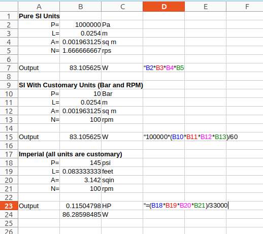

                        #801138
                          On Nigel Graham 2 Said:
                          …If you want to calculate the power:
                          The basic formula for one end of one cylinder using Imperial units is PLAN / 33000,
                          where P is the MEP – a function of full pressure in the cylinder before cut-off, and the roughly hyperbolic expansion after cut-off.
                          L = Length of piston stroke in feet.
                          A = Piston area in Square Inches.
                          N = number of working strokes per minute (or rpm), but for a double-acting cylinder multiply that by 2.
                          33000  is the foot-pounds to horsepower converter.
                          Sorry- I don’t know how it all works in SI units. I can convert the dimensions from inches to mm easily enough but I don’t know how to make the mm sizes and bar (or Pa) give the right number of Watts. Named after the chap who invented the Horse-power….
                          An example might help.   PLAN is the same in metric and imperial, except for magic numbers added to keep the units in line.
                          In Pure SI units, the Metre Kilogram Second Ampere system, there are no magic numbers, and the answer is simply Watts=Pressure (in Pascals) x Length of stroke (in metres) x Area of piston (in square metres) and Number of strokes (per second.)   Not having magic numbers simplifies the formula, highlights how it works, and reduces mistakes.  Pure SI is preferred by those doing original work because most conversions disappear entirely and those that remain are simple powers of 10.
                          Though calculating in pure SI has many advantages, the units aren’t always human friendly.   In my SI PLAN example below, we have:
                          • Pressure in Pascals is a big number (145psi = 10000000Bar)
                          • Area in square metres is a tiny number (0.00196sq m)
                          • Revolutions per second is a small number (1.6666rps)
                          Practical men working on engines in metric prefer to express pressure in Bar (1Ba = 100000Pa), and RPM.  These are both customary units, that have to be corrected in the formula by multiplying by 100000 and dividing by 60, the two often being reduced in books to the single magic multiplier “1666.666”.
                          The Imperial version uses nothing but customary units : Horse Power, Pounds, Feet and Inches.  The unrelated units are aligned inside the formula by a complicated shower of magic numbers, fortunately cancelled out for us by a long forgotten mathematician, to HP = PLAN/33000.   Seems simple, actually a mess.  For example a century ago it made sense to express power output in terms of the work done by an average horse because most people were familiar with working horses.  Not today: now we mostly think in watts, and converting HP to them requires yet another magic number!   Anyone who believes Imperial is simple is invited to explain from first principles where the 33000 in PLAN comes from.   And why Imperial, Metric, Mechanical, Drawbar, Electrical, Hydraulic, Boiler and Tax HP are all a bit different…
                          Here’s the sums, all for an engine with a 1″ (25.4mm) piston with a 25.4mm stroke at 100rpm, running at about the same mean pressure:
                          plan

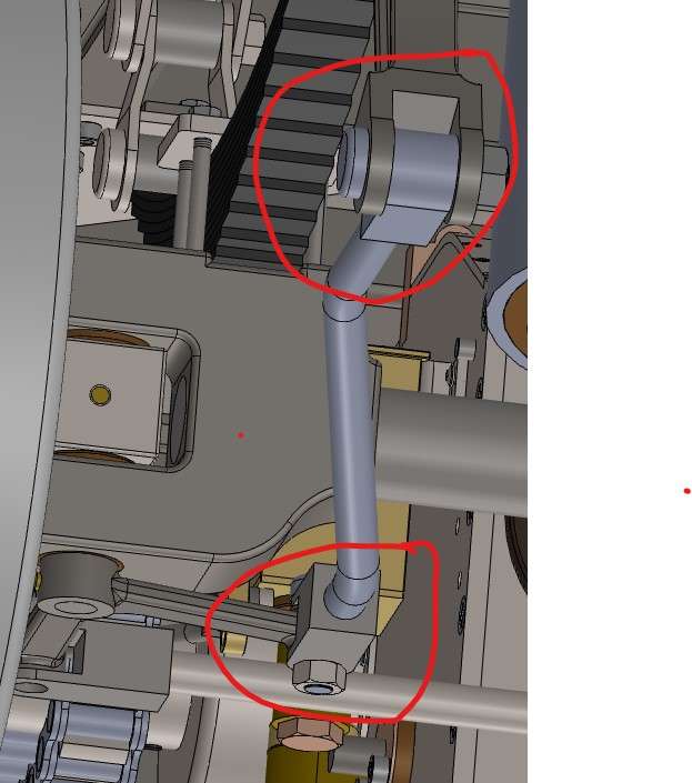

                                                  #804152
                                                  Phil P
                                                    @philp
                                                    I see this one still has the error in the steering gear. The pivots on the drag link should have movement in two planes not just one.
                                                    This has been evident since the original design decades ago.
                                                    Also if you have a good look at the assembly, there is an awful lot missing from it.
                                                    Screenshot 2025-06-22 224059
                                                    #804170
                                                    Werner Schleidt
                                                      @wernerschleidt45161
                                                      That detail is the same construction as in Julius plan. If Julius knowing the original he copied this mistake.
                                                      Gerhard made his own plan in metric,but it is base on Julius plan. But in the other hand it is good in function.
